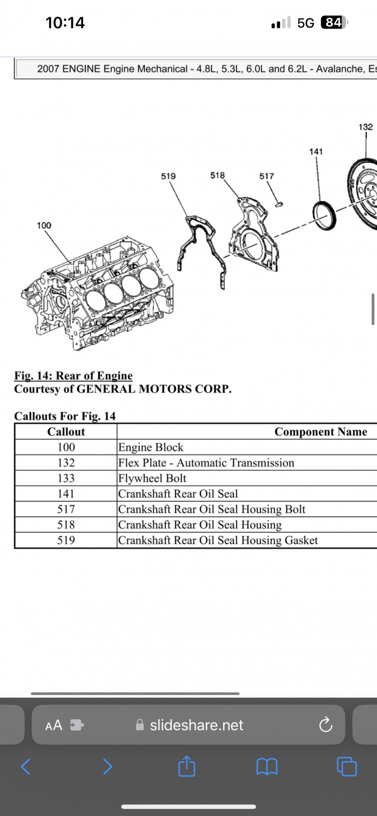

Thank you for the advice everyone, it is greatly appreciated. Should I do anything with any of these parts as well, aside from the RMS?

Thank you for the advice everyone, it is greatly appreciated. Should I do anything with any of these parts as well, aside from the RMS?View attachment 443747
yeah, what's called out as 519. the cover gasket. pretty common leak. most get the new plate with the rear main already installed too.
watch some videos, there's a little bit of alignment to watch our for. they sell alignment tools, but I'm not sure it's needed. Just make sure the rear main is centered before tightening down that plate
if you have it apart enough to get the oil pan down. replace that gasket too. they all leak at some point.
