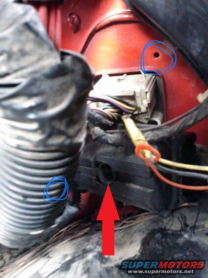

The white part stays attached to the inside convenience center. It has two screws holding it in, circled in blue below as best as I can remember. The upper right screw is already removed in the photo. The second one is diagonal to it and hidden from view in the photo.
Then loosen the torx bolt inside the black part (red arrow) and pry that part off. I don’t remember if the bolt was captive or not.
When the black part is pulled off, push the white part through the firewall into the cab. The various wires connected to the stuff under the hood will go with it.

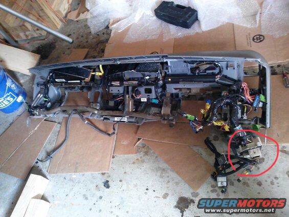

Here’s the white part (circled in red) once the dash is out.

Thanks for pointing that out in the pic. On the engine side I guess I have to trace all those wires from the white connector and unplug those?

Yes, there are maybe six or so. It’s arguably the hardest part of the job just because they’re hard to see and reach. There are a couple down under the brake booster if I remember right.
Loosening the underhood fuse block (bolts are through the fender wheel well) and pushing it out of the way kind of helps.
