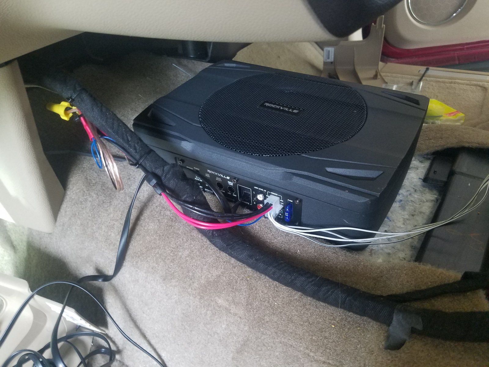

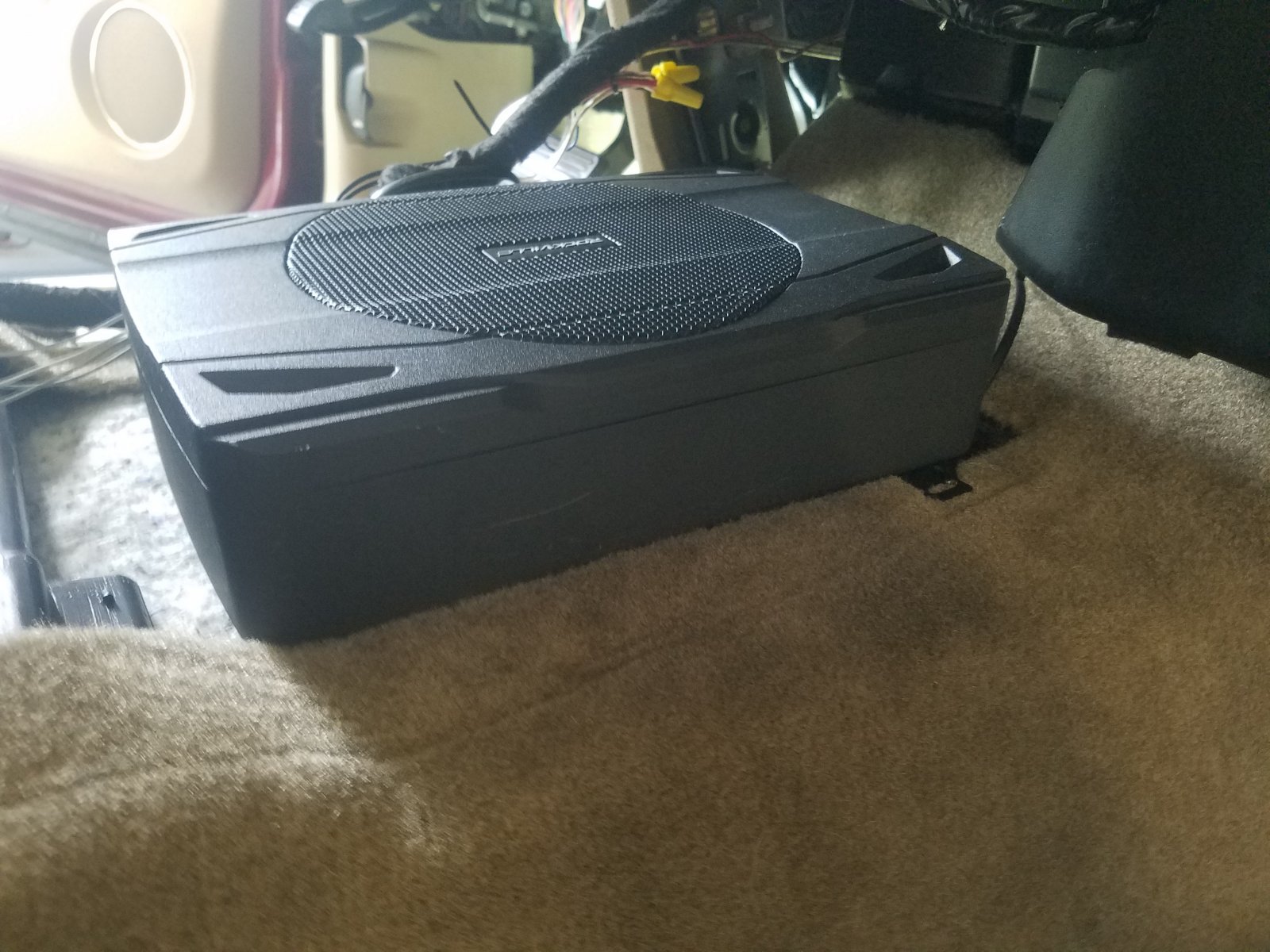

I was never pleased with the factory bose sub in our yukon. I absolutely did not want a box, so i figured I would try an under the seat compact sub.
I bought an a 8" rockville SS8P, turns out it doesn't fit under any seats (if I had looked under the seats before i would have know this lol)
I then experimented with the the jack location. with some slight tweaking of the jack mounts, i believe i could have made it fit, However after some experimenting, i dont think the little 8" would sound good from back there so I abandoned it.
I ended up just yanking out the factory bose, and installing the rockville right in its location. It doesn't shake the windows or punch you in the back like a good 12", but It does sound so much better than the factory. Overall, Im very pleased, especially considering the total cost was $85. Its also very easy to adjust the gain, crossover levels since the panel in the foot well easily comes off.

View attachment 224582 View attachment 224583

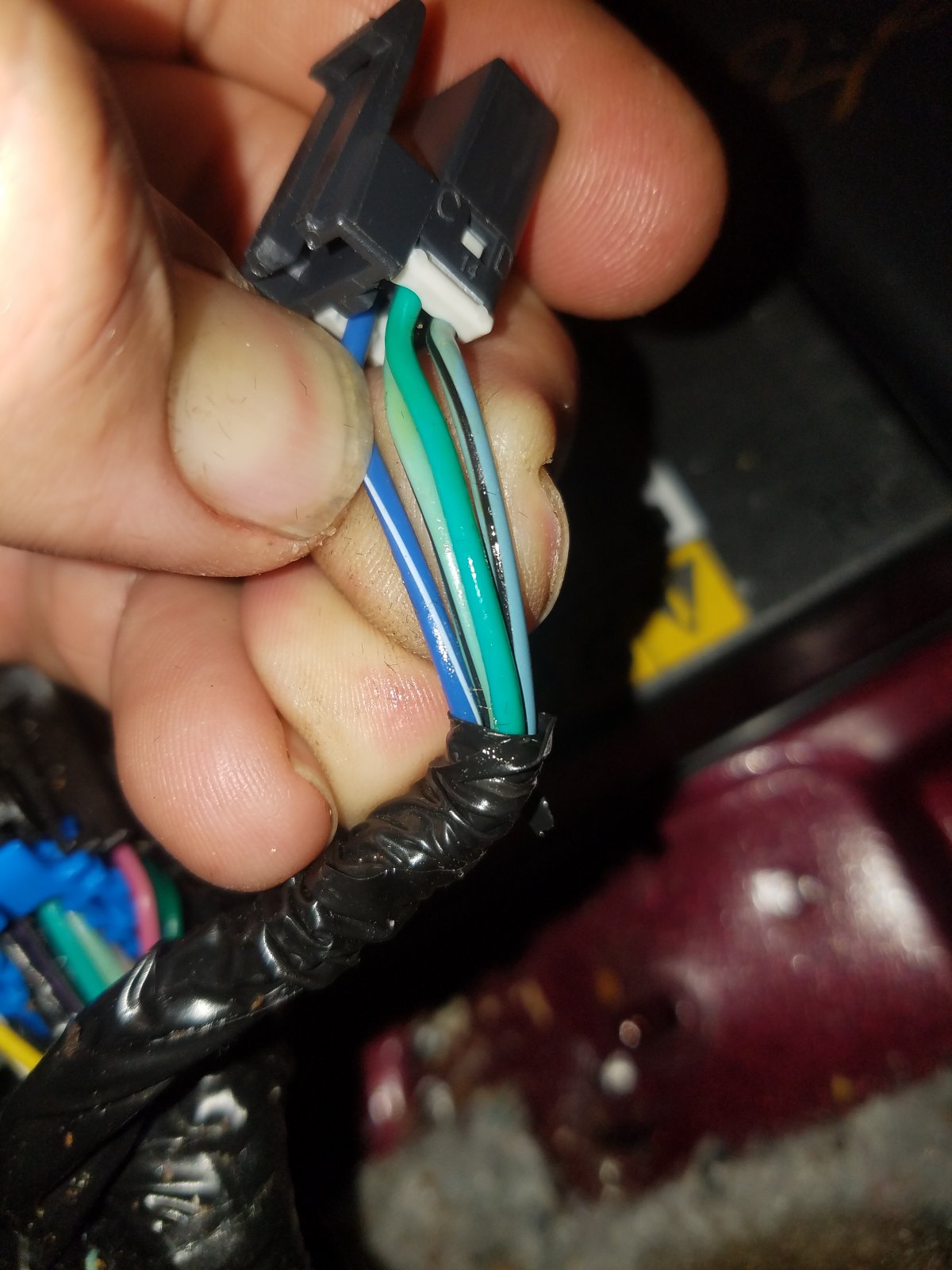

Ran the speaker wires that originally went to the factory sub (I believe the factory sub is DVC, right?) to the high level input on the amp?

Ya, I didn't want to mess with any of that either. To wire this sub, I ran a wire through the main groment above the parking brake, from there under the hood it there is a ground right there and the power is from the main fuse box. The remote is power is optional with this amp, but i already had one ran for my wireless center console phone charger, so i just tapped into that. Its from the white connector with a pink wire above the parking brake. ( https://www.tahoeyukonforum.com/thr...-charging-into-the-center-console-lid.107832/ )
The signal for the sub come straight from the harness that goes to the sub speaker. The rockville sub has high level inputs for this purpose, which made it really easy and reversible.
Correct. the bose a DVC sub, so there are 4 wires. I ran one set into the + - of the left high level imput, and the other coil into the right high level imput. Very easy.
