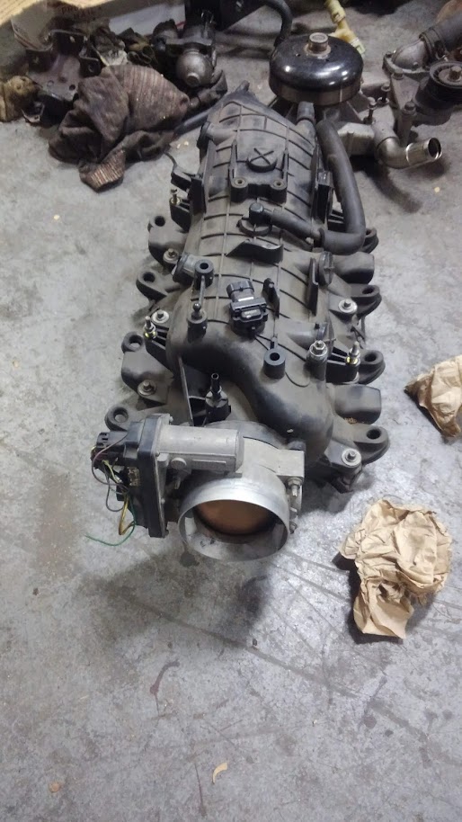

Well, its back to an X-Link adapter and 6 pin throttle body! Turns out the OE waterpump for the LQ9 interferes with the 4 to 3 bolt throttle body adapter plate. That left me with a choice of buying a Camaro water pump or use a larger 4 bolt throttle body. Faced with buying another waterpump (I'd already got a new one for the build) it was a no brainer to spend the money on the X-link adapter. My builder "donated" a larger 4 bolt throttle body from a blown engine he has on hand. Don't have its specs, so I don't know if its an 87mm or 93mm diameter. Either way, the increase from 78mm means more air to the intake! The engine is buttoned up. Now, the builder is waiting for the tuner to come by this week to dial in the engine and fire it up! I've asked them to make a video of the startup. If they do I'll post it.

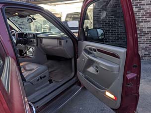

Seat covers from Leatherseats.com arrived today. They look great. Worksmanship appears to be first rate. Included a pre-paint reconditioning photo and picture of the door trim so you can get an idea of how the colors will look together. The dark gray dash cover will be painted red to match the seats and the door armrests and trim insert will get red leather upholstury to match the seats and dash. The remainder of the trim will remain pewter. Will likely be about a month more before these are installed since the interior will be done last. Trying to decide whether to change the carpeting to charcoal color or stay with the OE color. Any thoughts?
Tough decision on the carpet color. Function brain says to go with charcoal to hide dirt. Form brain says the original color is a better match. I don't think charcoal carpet wouldn't look good, though.

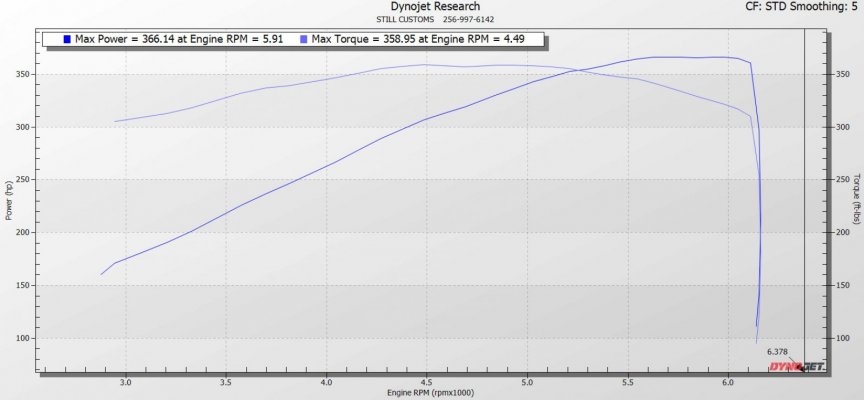

Here is the dyno graph and a video link for the first dyno run of the LS364/450 we installed in the 06 Escalade build. The HP and torque figures are at the rear wheels. The tuner's correction program put max crankshaft HP at 450. He will do more runs over the next few days to tweak the program. I believe he started with an LS 6.0L Corvette tune and is working out a new program from that.
