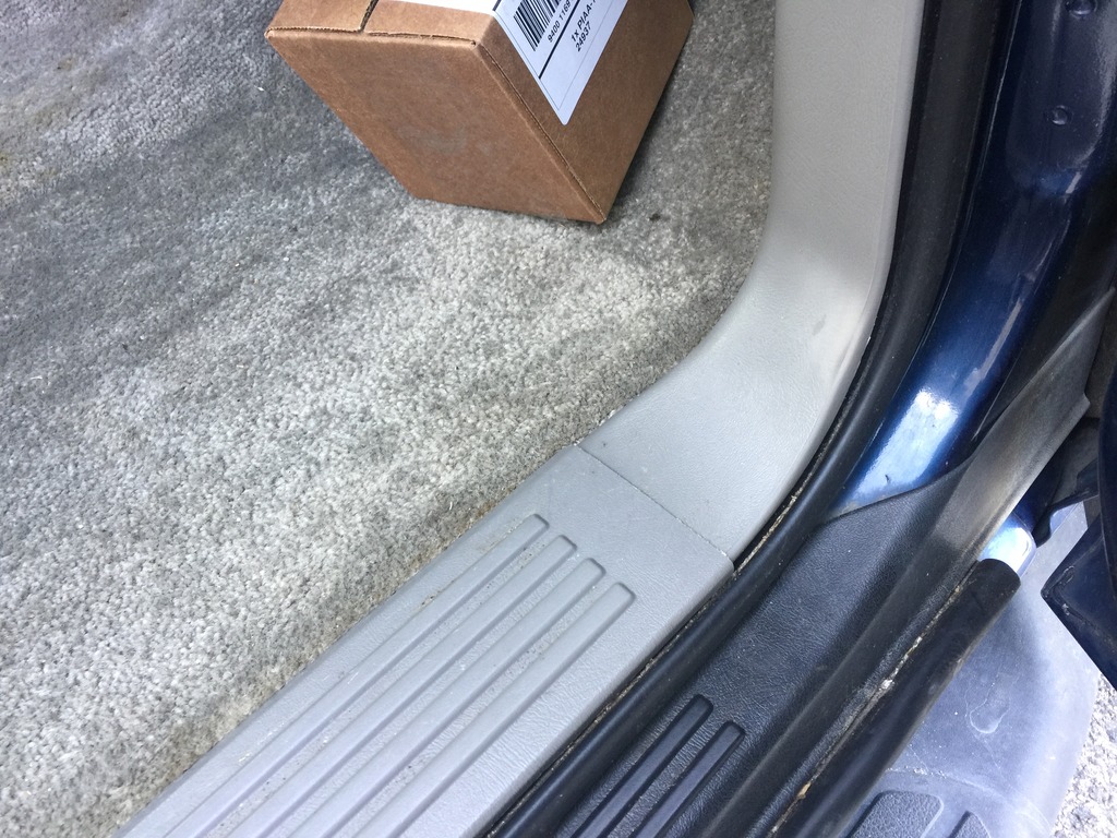

Also forgot to ask , were your trim pieces glued in or clipped in? Mine were glued to the carpet and didn't really clip in.

They are glued to the carpet, but they clip onto the little metal bars that the seats are supposed to lock into

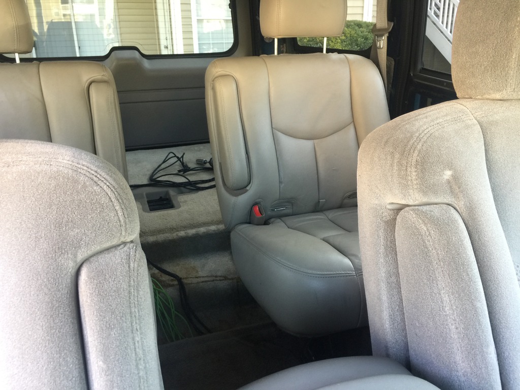

Got some work done yesterday and today.

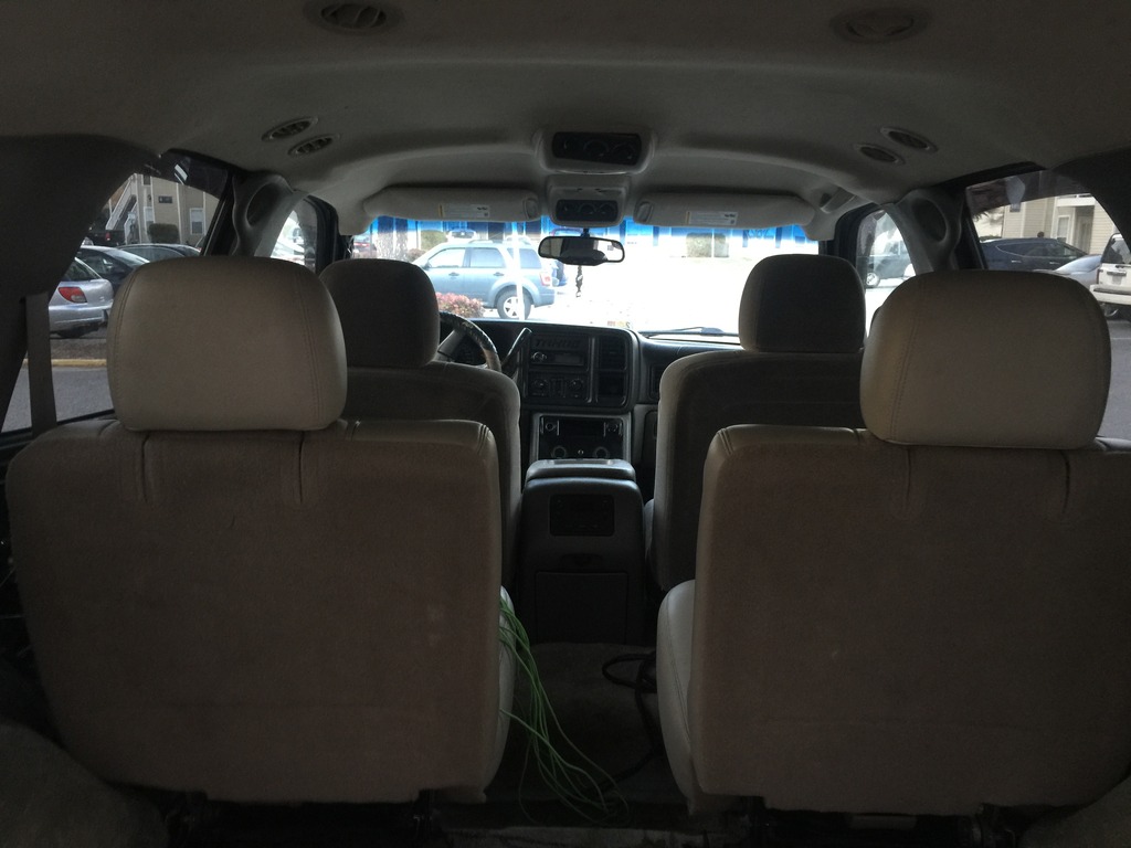

Yesterday, I ran the RCAs and remote turn on/ SMD meter wires under the center console to the second row, put interior panels back in, seats in, bolted everything that needed it back down (thank goodness for an impact, that makes light work of it). Today I put the 80PRS back in, and the dash back together. I got some grommets in, so I just need to find a good spot to drill a couple holes, run some 1/0, cut some wood and build a new amp/battery rack. Unfortunately, my wire came in but my terminals weren't with them, so I'm trying to get droppinhz to figure that part out... it's been a troublesome order with them. Here are some pics of the interior back together. Don't mind the loose wires, I don't have a place to connect everything to yet.
Front seats back in
Back seats in
Trim back together without any issues

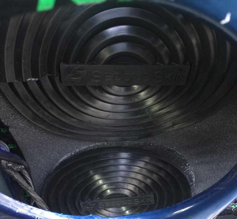

Second Skin Speaker Tweakers in the doors. Two each in the front doors, and one in each back door.

Thanks for looking

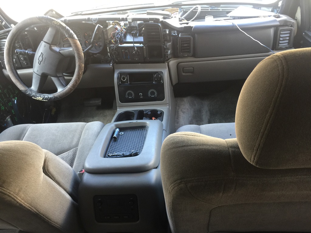

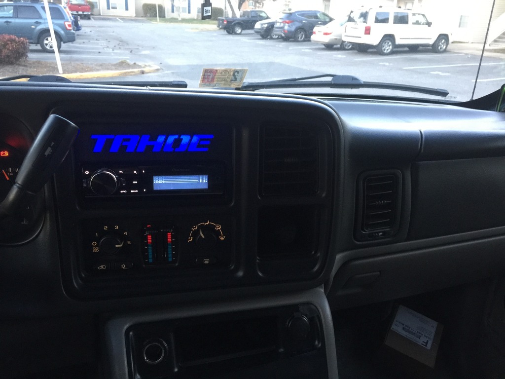

Looking good. What's that in the upper center console bezel? Where the cubby used to be, under the power points.
reedal
reedal
Sep 20, 2015
268
95
Virginia Beach, VA
It's a PAC LC-1 gain control knob, a USB port that connects to the rear of the 80PRS, a SMD VM-1 volt meter, and SMD OM-1 output meter so I make sure I don't send a clipped signal to the sub amps

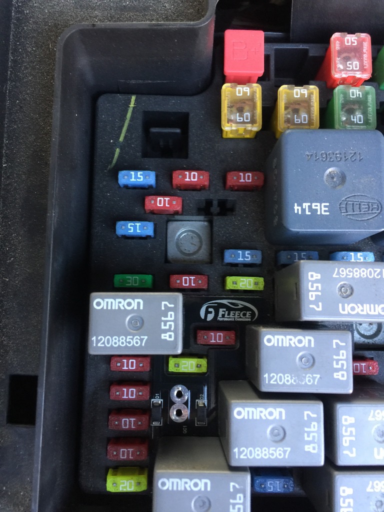

Bought some PIAA 880's for the fogs (so now I have PIAA's for highs, lows, and fogs) and a fleece all lights on module to replace the cheap method, which was a diode connecting the relays.
i need to align the fogs still, so no pictures of the fogs and all lights on until I get that done.
also, I've had a "Service Brake Booster" message ever since I installed my singer 270A alt back in June of 2015. All of the research said it was the SBA (supplemental brake assist) causing it. I verified it had ground on the connector where it was supposed to, and power coming in where it was supposed to. I finally got a replacement SBA, and I still have the message. So I guess I'll run it to a stealership and have them diagnose it and then I'll do the repair.

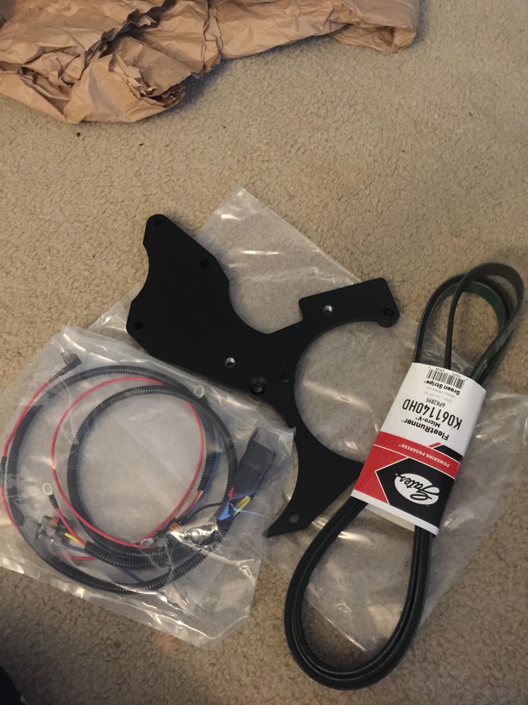

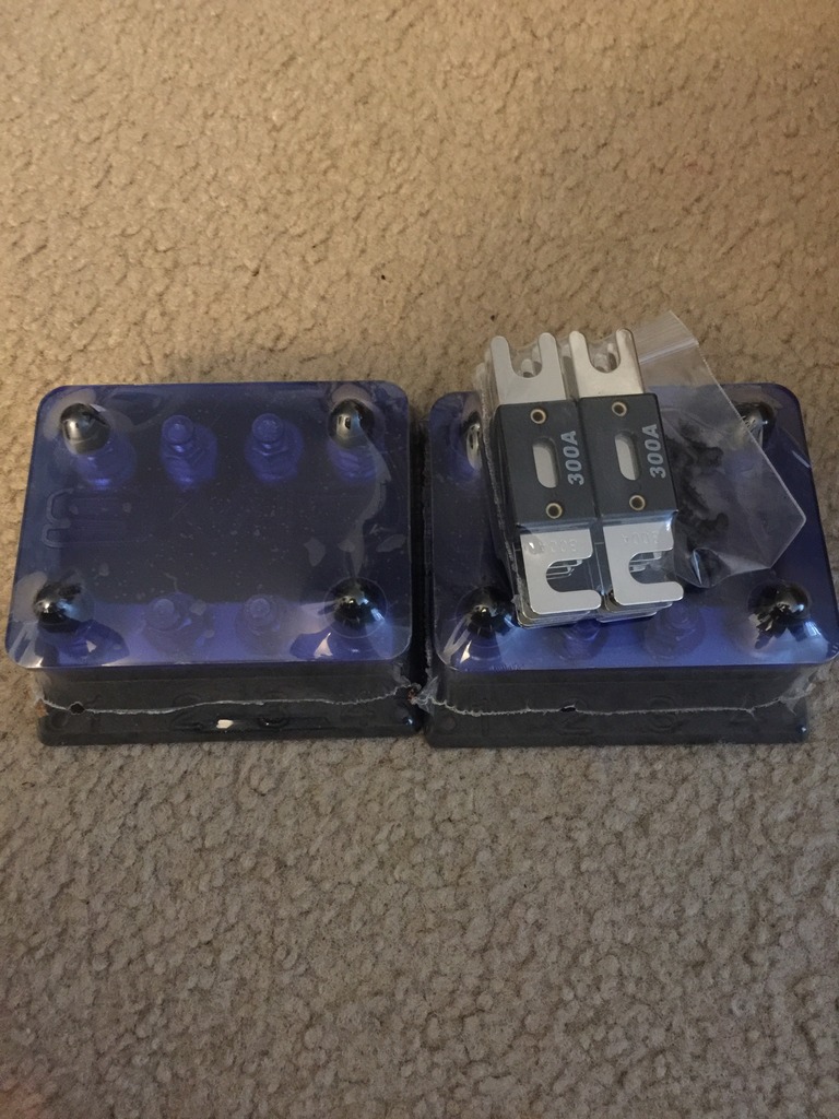

These came in the other day.
Two SMD quad ANL fuse holders
And a DC Power Inc. triple alt bracket
But it's time to work on the door pods.

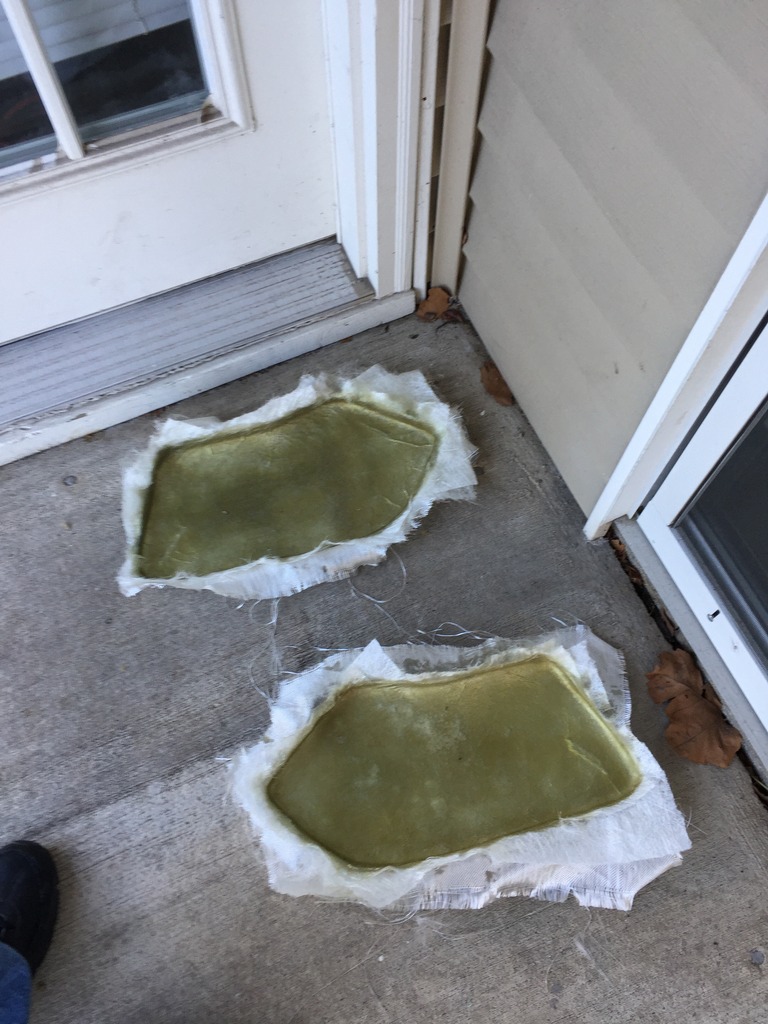

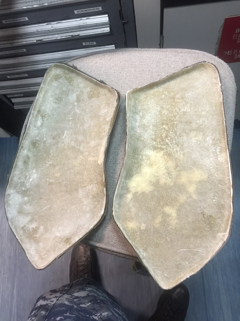

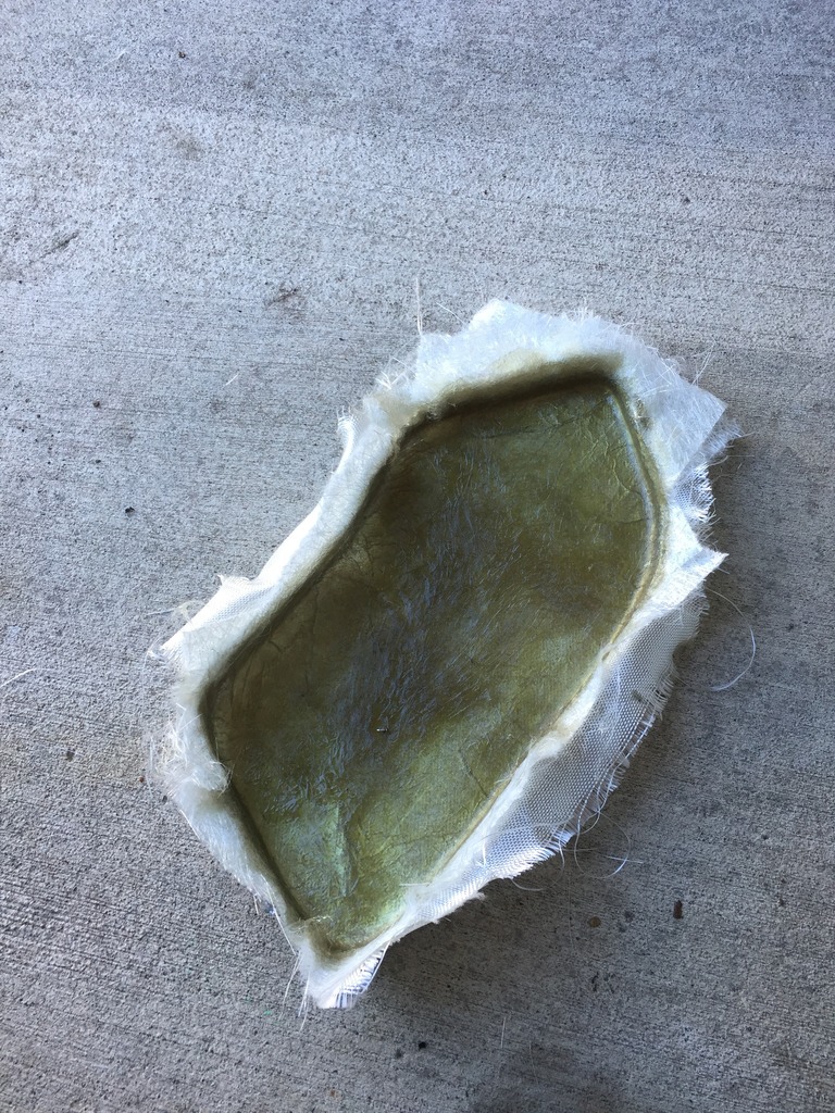

I haven't spent anymore time on the pods since I started them last week, so I decided that since I was stuck on the ship today for duty, and I didn't have night watch, I'd bring them and my dremel in and get rid of the excess glass and make them sit flush inside of the factory grilles.
Couple of air bubbles inside that one, thought I got them all good with my roller, but oh well. They're both pretty solid and layered. Sometime this week/weekend I'll see how they sit in the doors, and I'll drill a couple holes and either glass or glue some bolts for mounting into place. Once that's done, it'll be time to angle the speaker rings where I want, glue them into place, then stretch some cloth and glass it for strength, a little (ha!) body work, and paint. Or maybe I'll bedline them to hide my horrible bodyworking. We'll see.

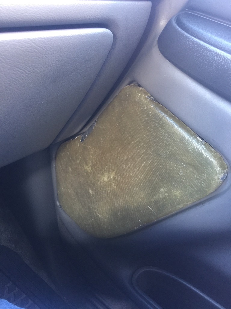

Speaker grill molds fit, a little extra room on the outside edges, so I'll probably fill that in when the time comes. Still need to drill mounting holes and glue rings to them. I'm dragging on it.

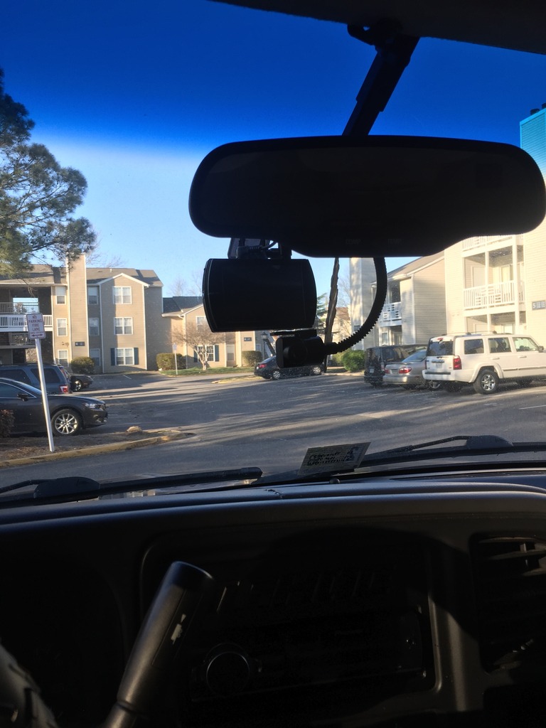

Installed my Compustar Dash cam. Quality looks pretty good playing it back on it's small screen, not sure how it comes out yet when it gets stretched on a computer screen. Only thing left is to tap into a constant power source instead of the cigarette adapter that comes with it.

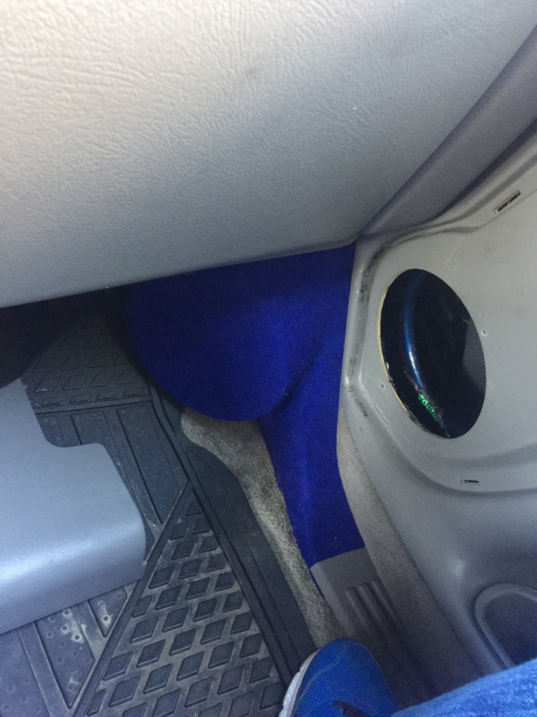

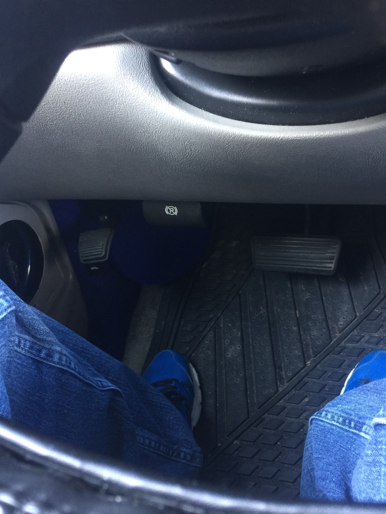

Here's a quick pic of the kicks I started for the L6's.
I think I'm going to take that fleece off, and stretch the Lycra that dolarbilz sent to me.
Once I glass them, I'll leave them there while I figure out the placement of the L8's in the doors. If I don't like the combo of the L6/L8 due to T/A issues, or whatever else, then I take the L6's out and put the stock kicks back in place. Simple.
