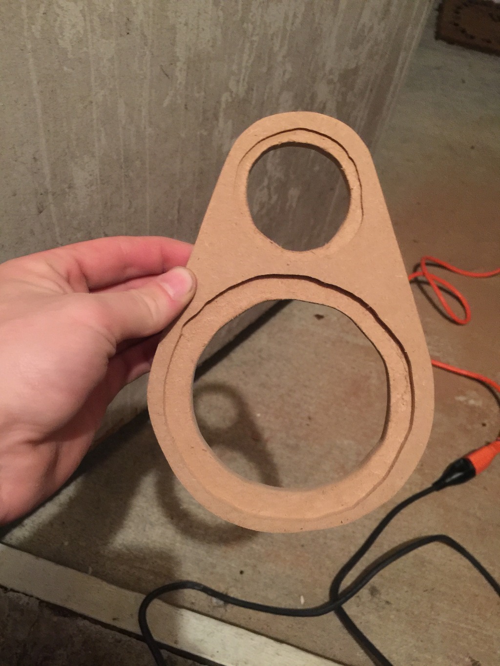

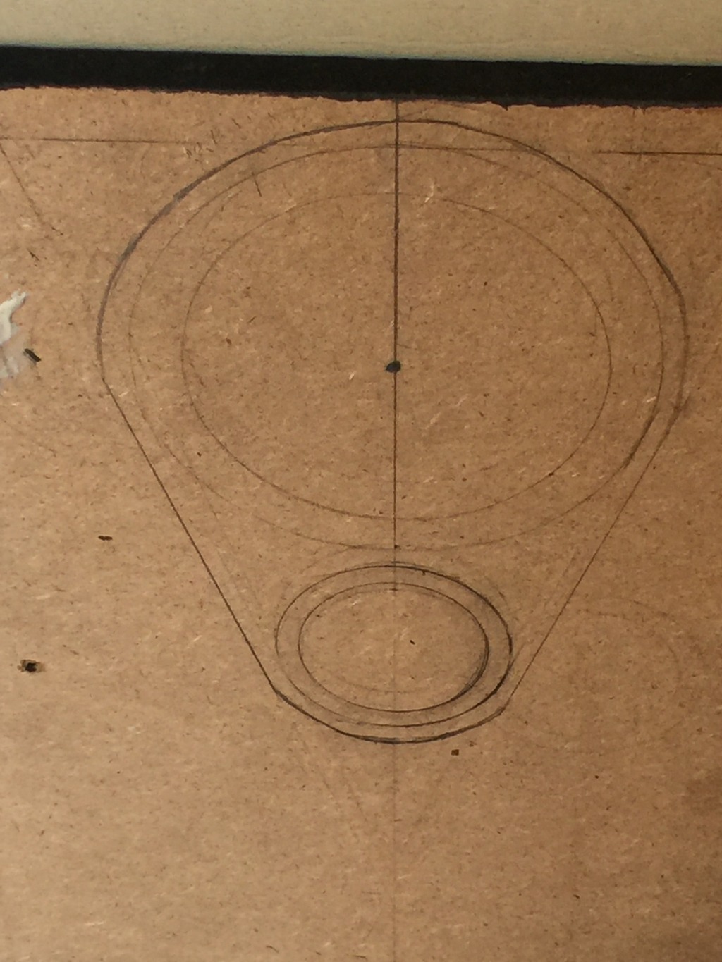

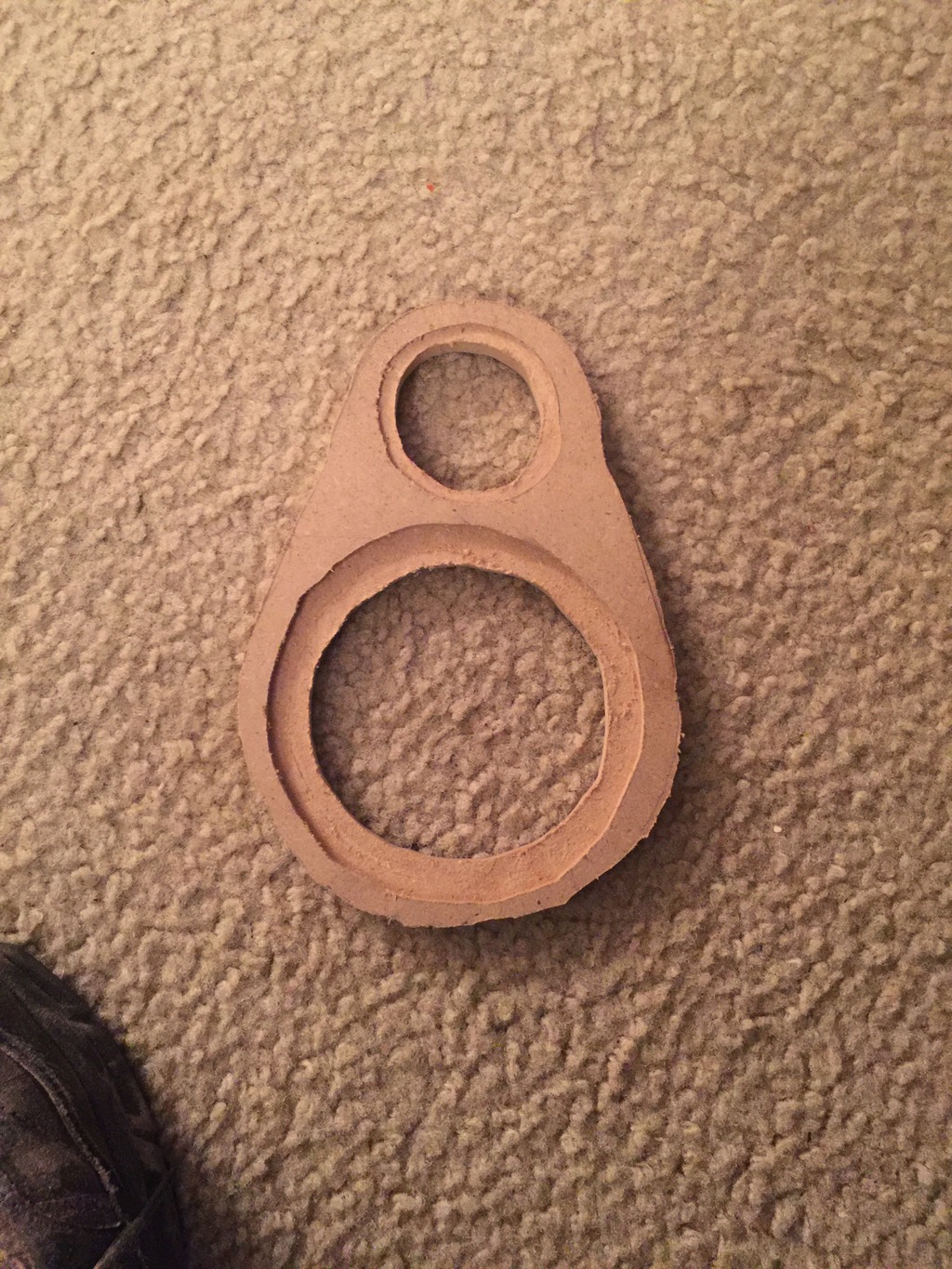

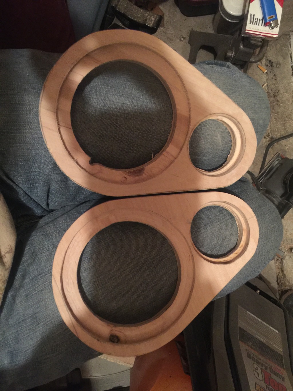

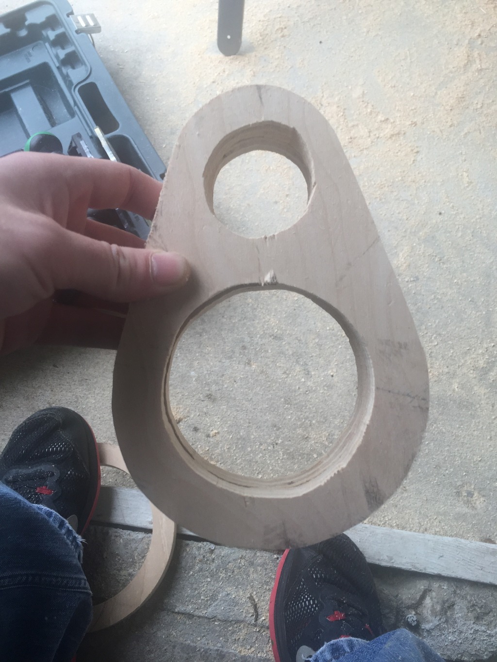

So, I figured I could try and get started on the A-pillars a little. So I decided to make a template for the L1pro tweeter and the L4 full-range. I'm using some 1/2" MDF I have left over from the very first time I tried to make door pods last year around this time.
I used my router and a 1/4" shank bit to cut everything out freehand, and as you can tell, it's rough
but it will do, and is fixable when the time comes. I have a lot of sanding to do before then
So, time to get to sanding and make it look pretty, then copy it, and I think I'll stick with using my router to cut the holes for the speakers, but use my jig saw to cut the template out

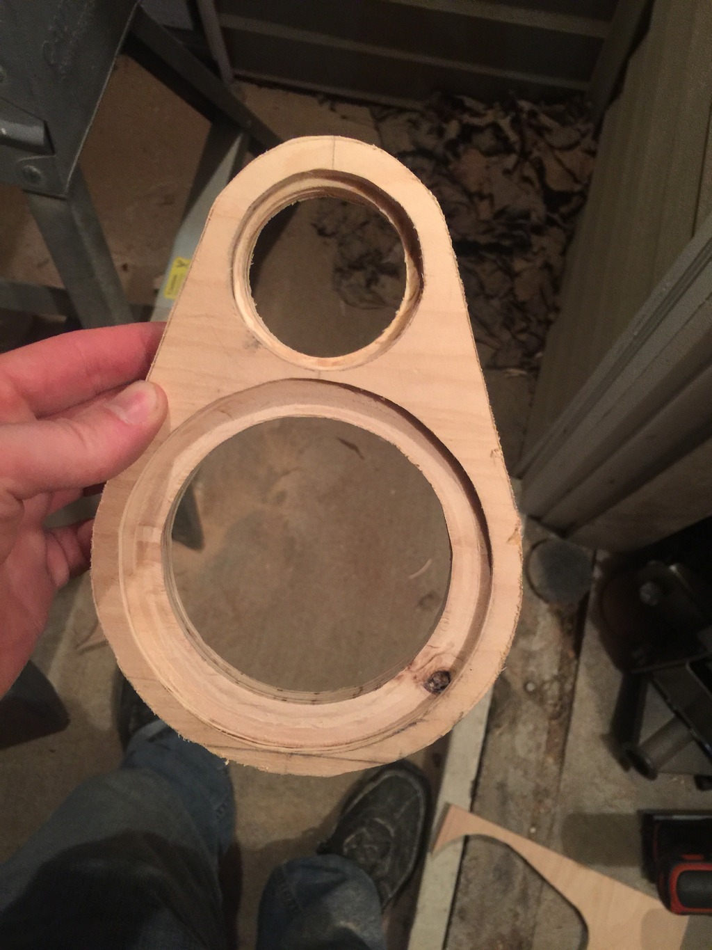

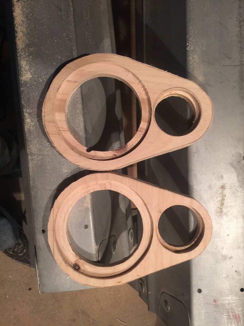

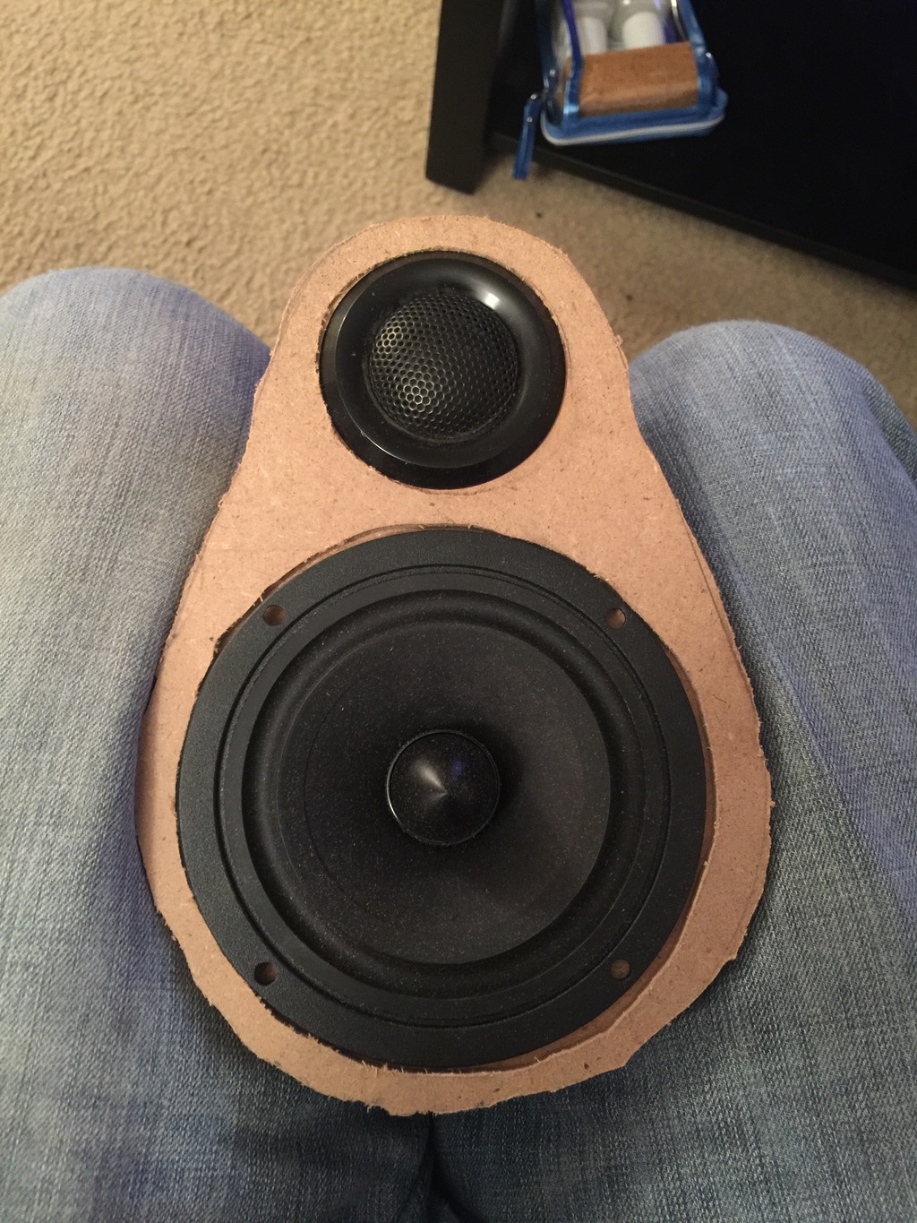

I pulled out the jasper jig, switched to 3/4 birch ply, and went to work. Look a little better Sierra? (Haven't sanded the outside down yet
Only downside to my jasper jig is that it doesn't have increments that meet the dimensions of the HATs, so I cut the circles small, then sanded down with my dremel until I had a fit.

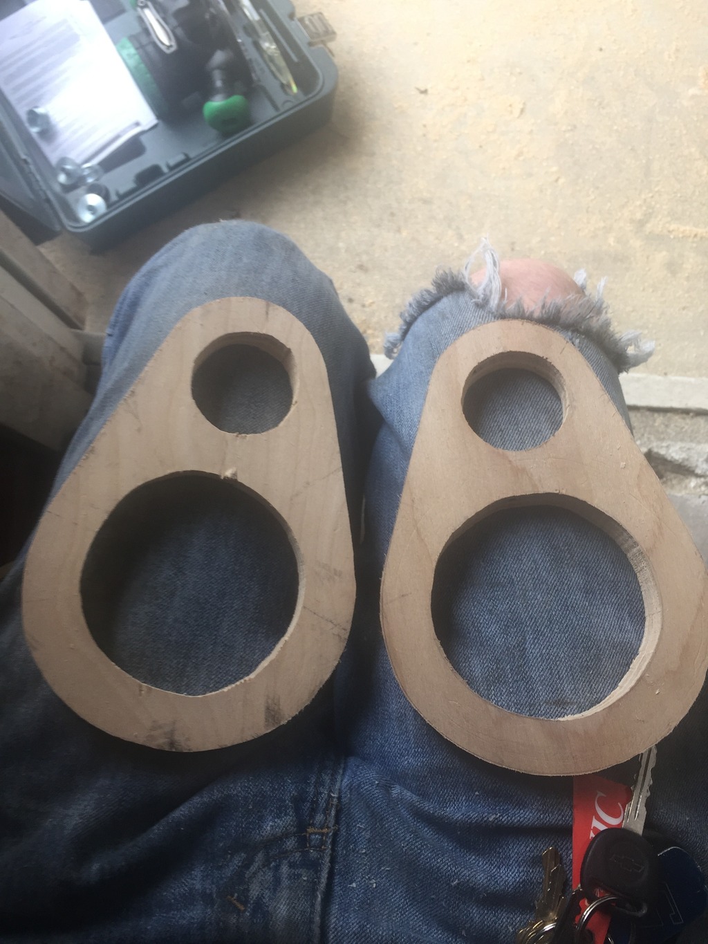

And then there were two
Sanded down the outer edges to clean up the roughness and make them exactly the same size.
Unfortunately, dremel battery is dead, so once it's charged up I'll sand the inner rings/edges smooth and be able to fit the speakers in.
It'll all look pretty when I'm done.

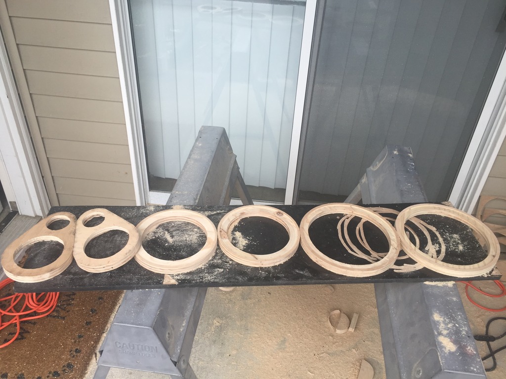

Cut out the mounting rings for the L8's.

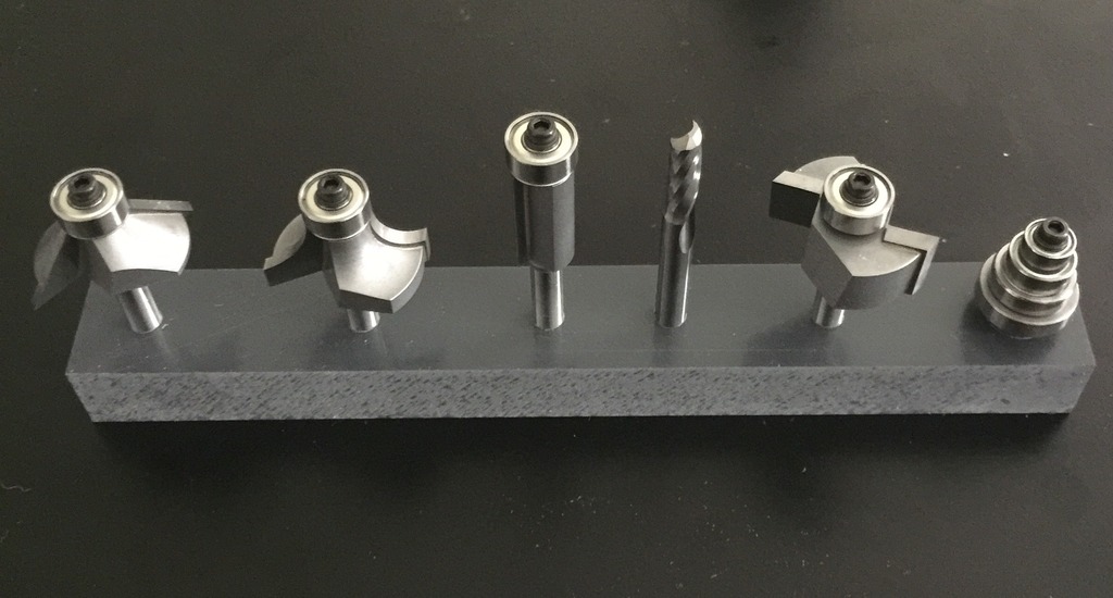

Got started on the rings for the L6's and ended up snapping the bit. I suppose my next bit will be from MS or 12vtools since that seems to be the best choices from what I've read on here.

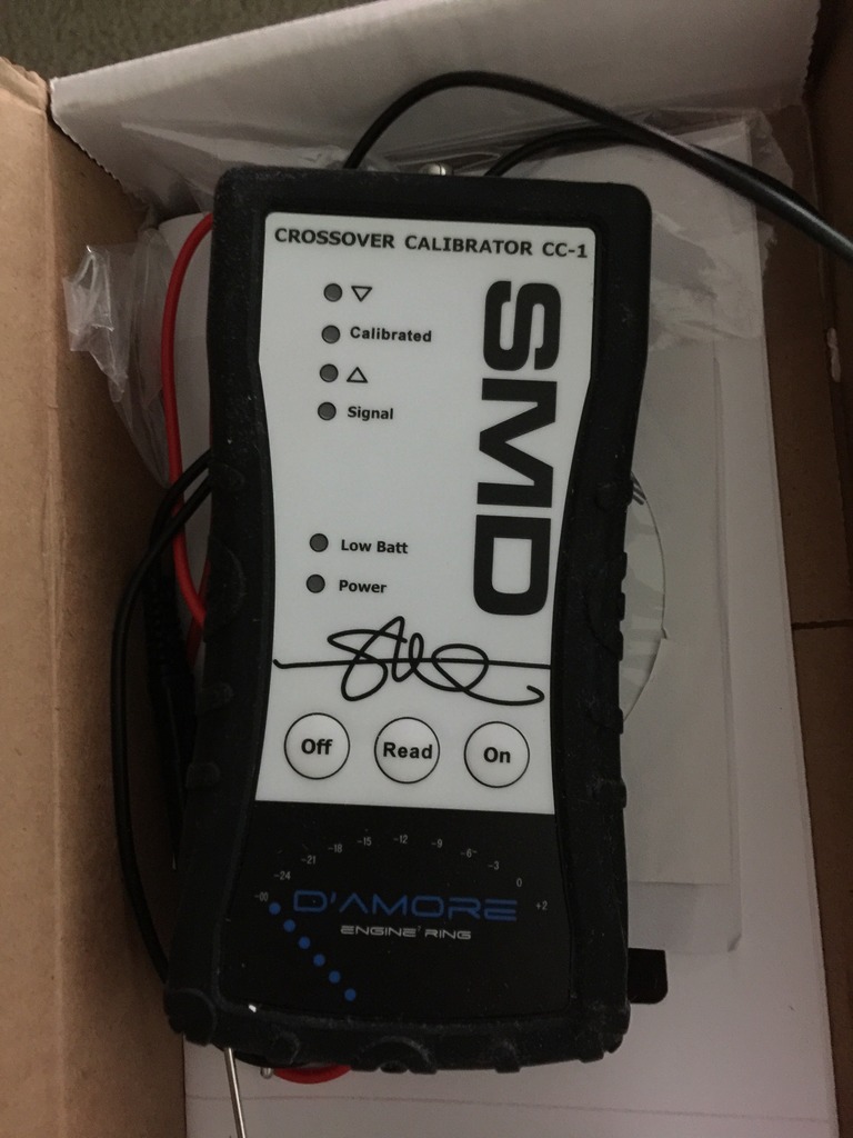

Bought a CC-1 used from CACO
Should make setting all my filters on the amps pretty simple once I get this front stage finished next year

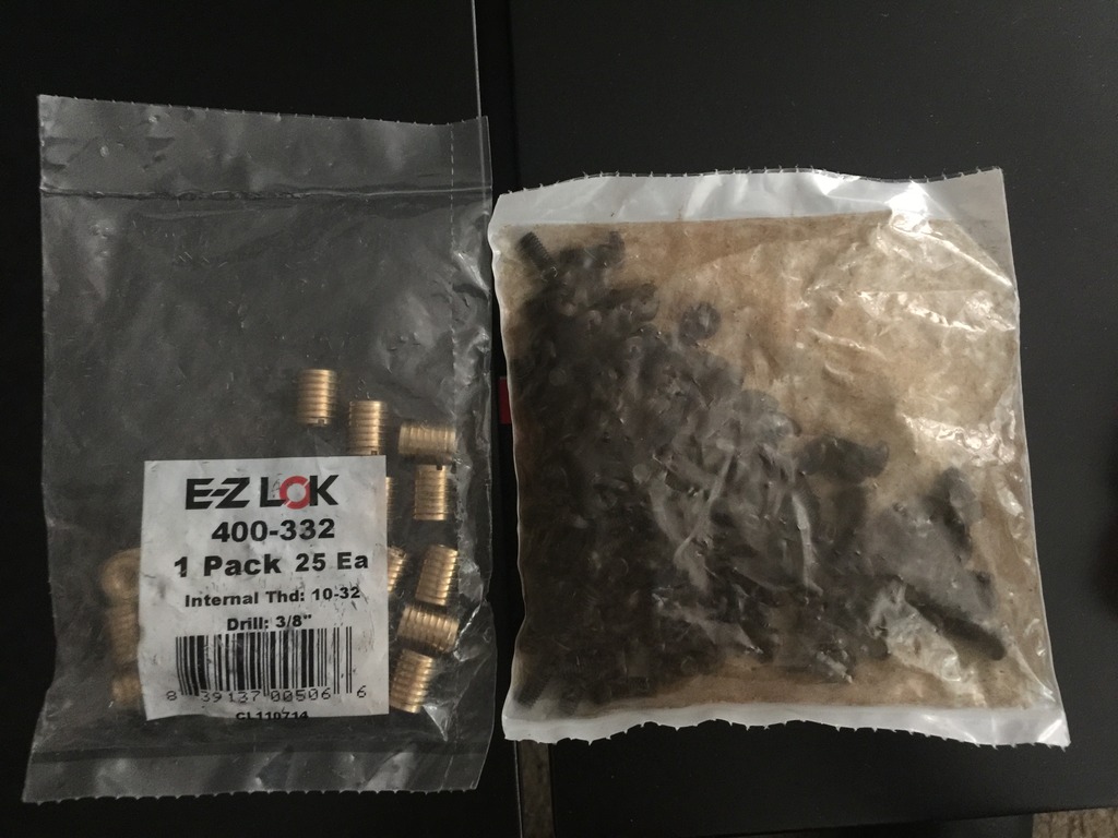

Some threaded inserts and screws for the mids and highs, since the 1/4-20 threaded inserts and the 1-1/2" screws to match that I used for the subs are a tad too large

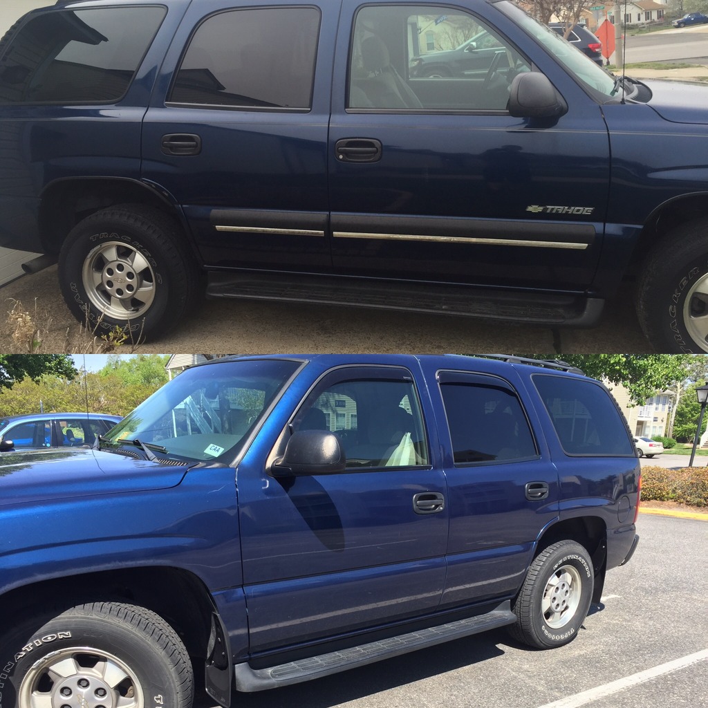

Got the WeatherTech vent visors and mudflaps installed. Top is the day i bought it, bottom is today
I want to delete the roof rack, and I'm undecided about the side steps. Need to tint the Windows one day, but that's no big deal to me.
Gonna pull the rear hatch panel off and throw some q-mat on there. Might run a dedicated ground to the front battery from the rear batt. Can't do anything about getting wood cut for the front stage until 12vtools gets some new bits out to me. Cheap bits are just that. Cheap. Time to get some recommended quality.

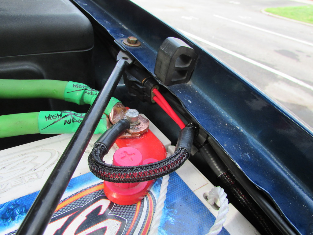

Ok, last update at least until I get my new bits from 12vtools. Deadened the rear hatch yesterday, no pics, and ran a dedicated front to rear ground. I think what I'm going to do is try and find the second row captains seats that were available for the NBS escalades/yukons and put those in, designing and building the amp rack to sit between them (assuming there's enough space in between). That should give me more room in the rear for the enclosure for four 15's. Hopefully I get the bits before next week and can get started on glassing the doors and pillars. If not, it'll be sometime next year before I can update again. Stay tuned.

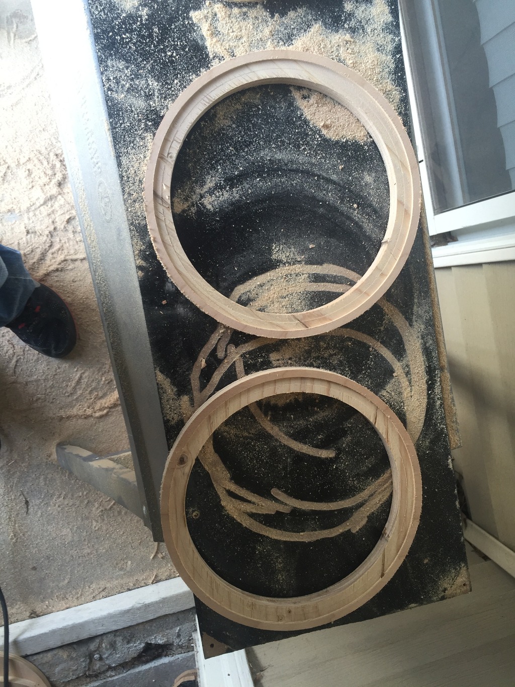

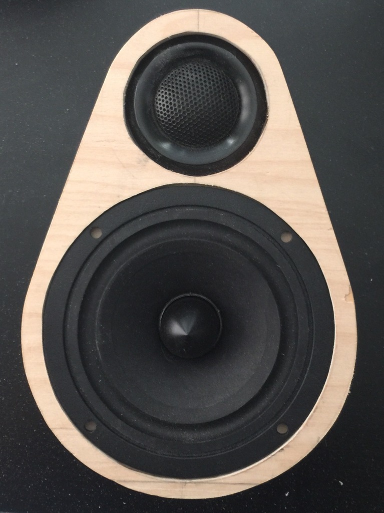

Well, the bits from www.12vtools.com came in today, and I got right to work. Finished cutting the mounting rings for the L6's, and cut out the A-pillar mounts for the L1pro's and L4's :good:
Now, I know the inside cutouts where the speaker and tweeter will go look rough and ugly, but who the hell cares, because it won't be seen, and they fit in their cutouts perfectly without movement :) both are flush trimmed to match each other perfectly.
Lots of sawdust all over my little apartment patio. And all over me. Cleanup time.

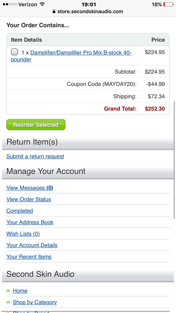

In other news, I bought the B-stock 40 pounder of Damplifier/Damp pro from Second Skin with their MayDay 20% off sale, so if you need some deadener for your ride, head on over to http://store.secondskinaudio.com and add some of their quality American made product to your cart, type in MAYDAY20 in the coupon box, and enjoy making your ride a little quieter

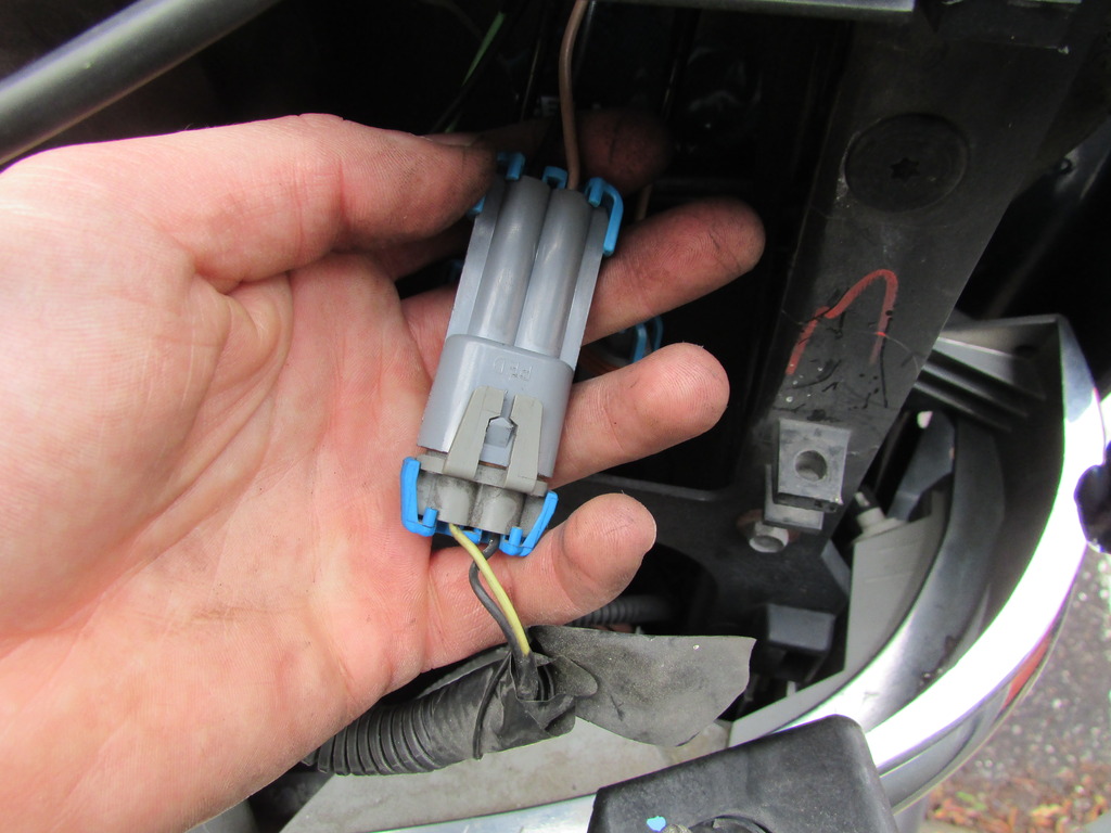

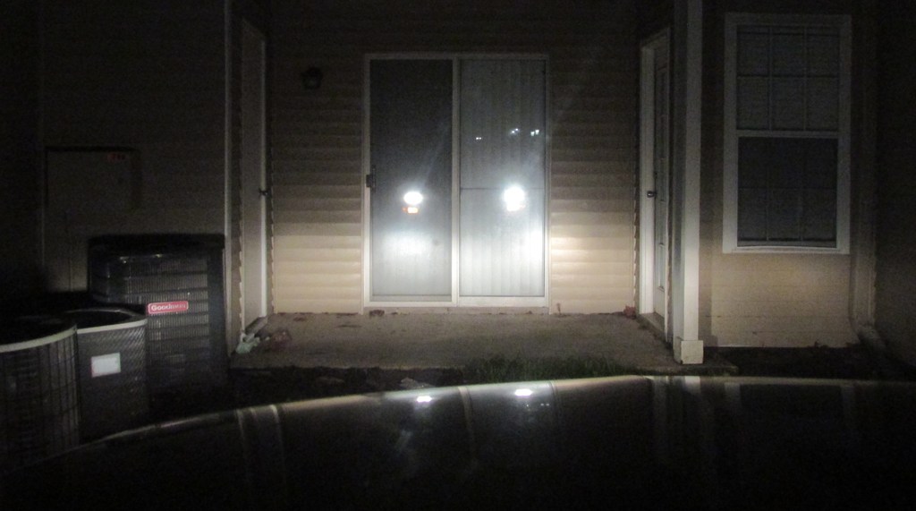

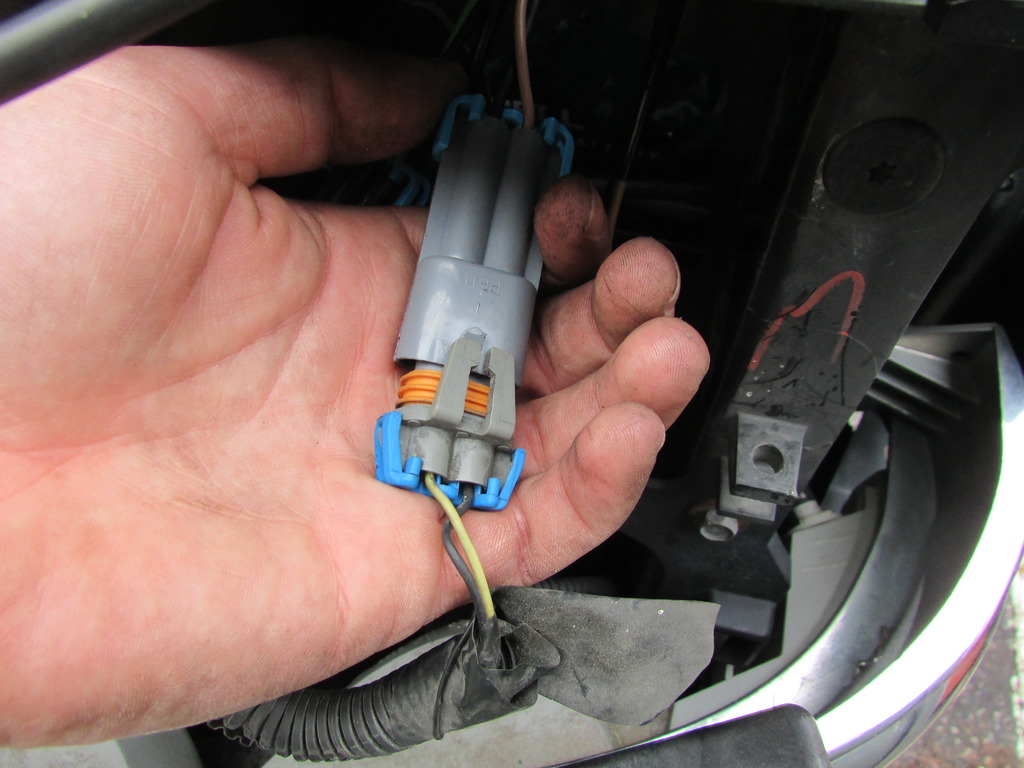

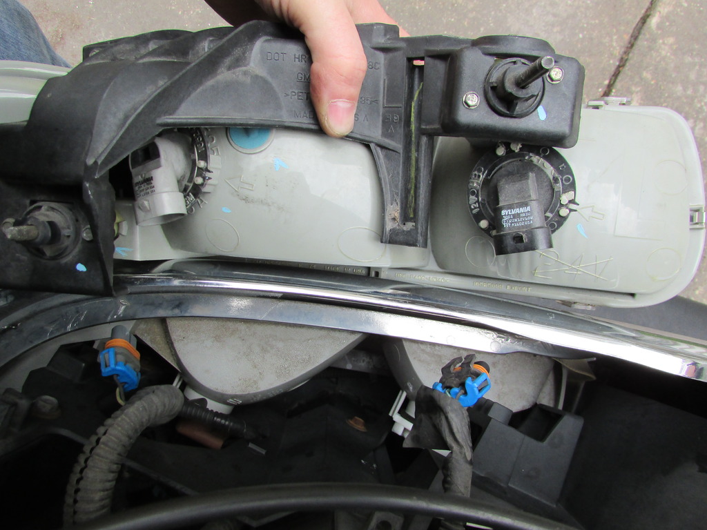

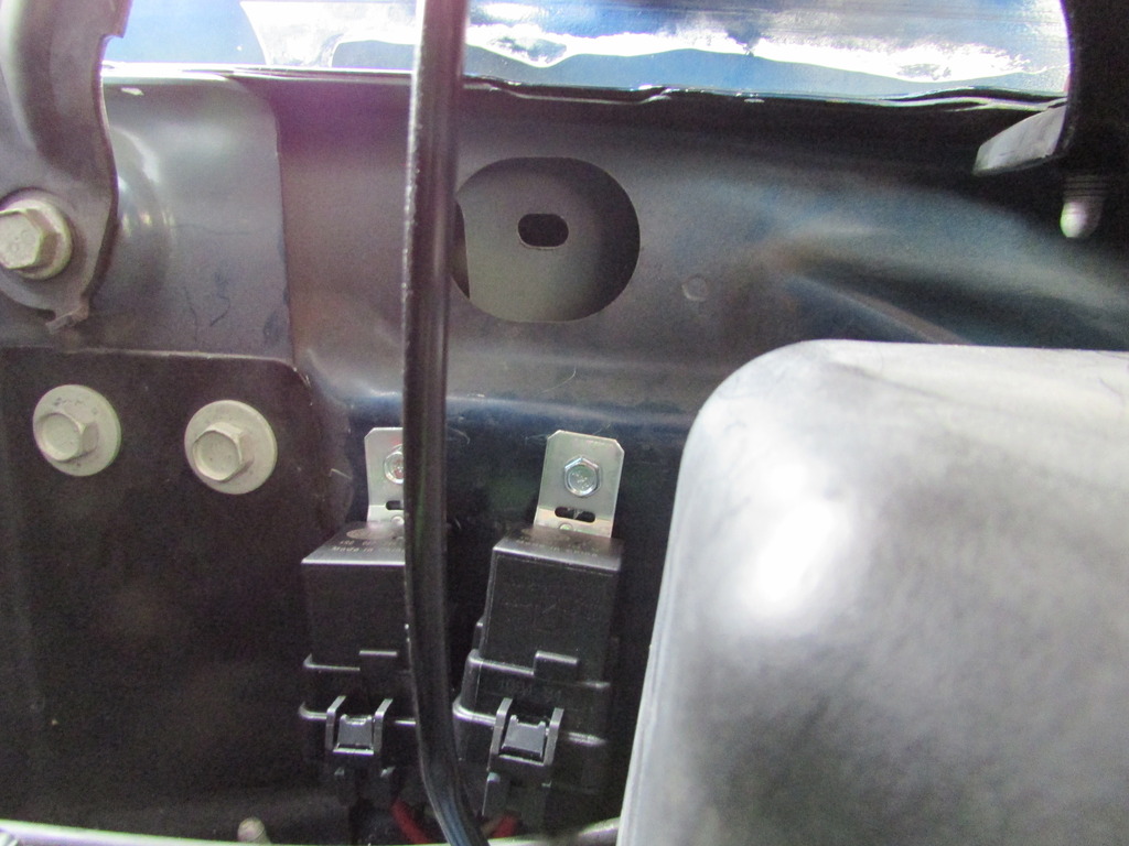

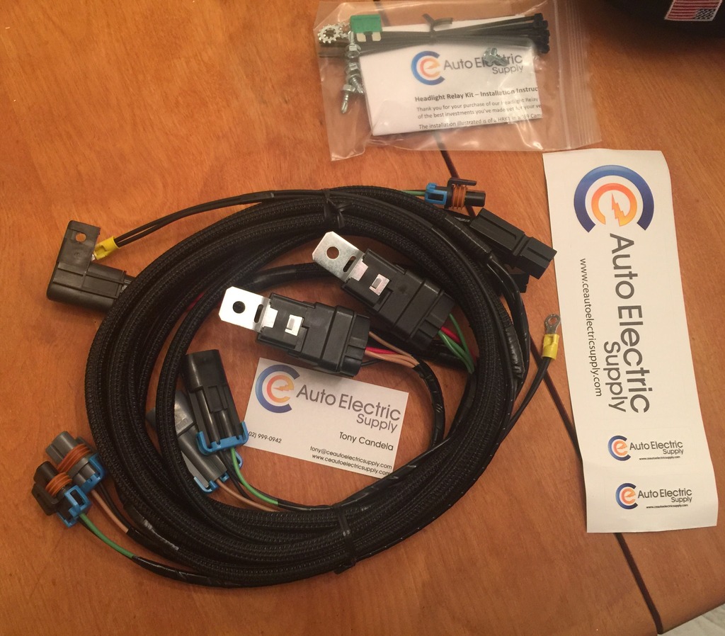

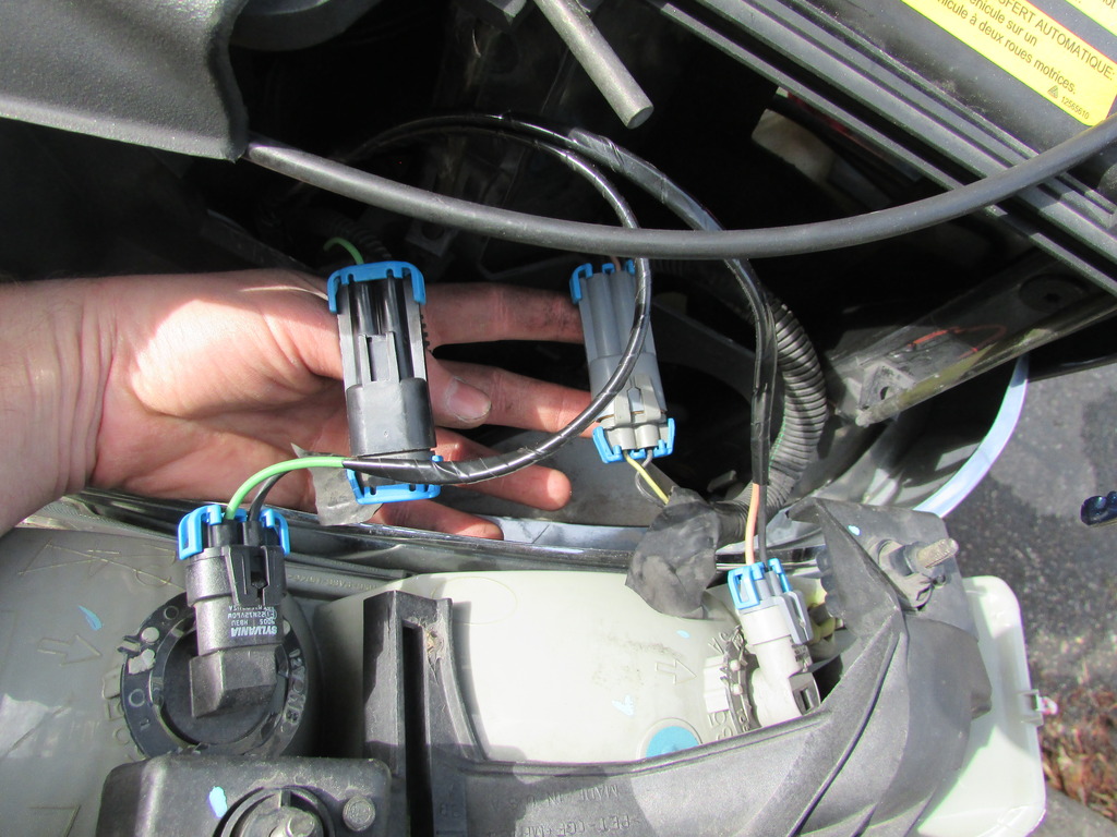

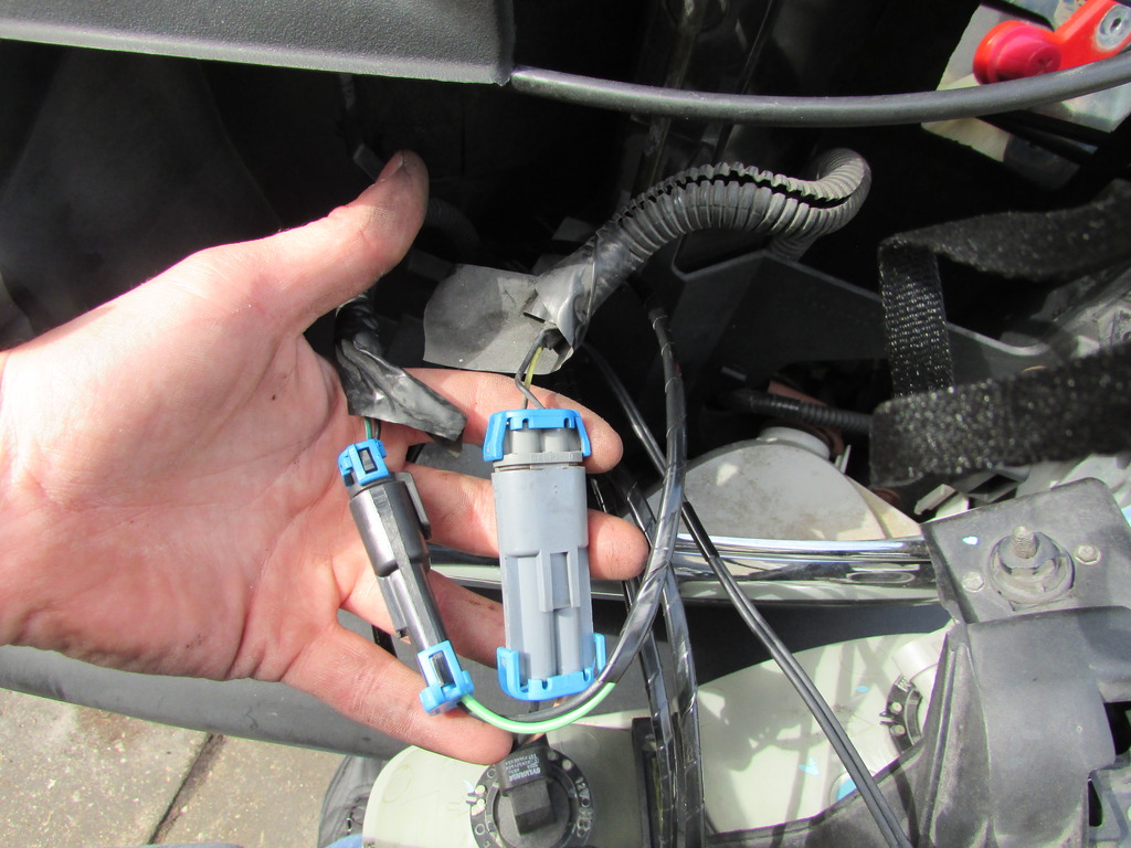

So, I bought the Headlight Relay Kit for the 9005/9006 lights that is made by the man himself, Tony Candela of CE Auto Electric Supply (www.ceautoelectricsupply.com). This kit is pretty heavy duty. It's very cleanly put together, and sealed tight everywhere in order to protect from corrosion.
OEM harness lighting
Install
Relays
Unplug OEM
Plug OEM into HRK5
All plugged up
Replay power wire attached to battery
And lights after the HRK5 kit is wired.
4-hi mod with the HRK5 kit installed

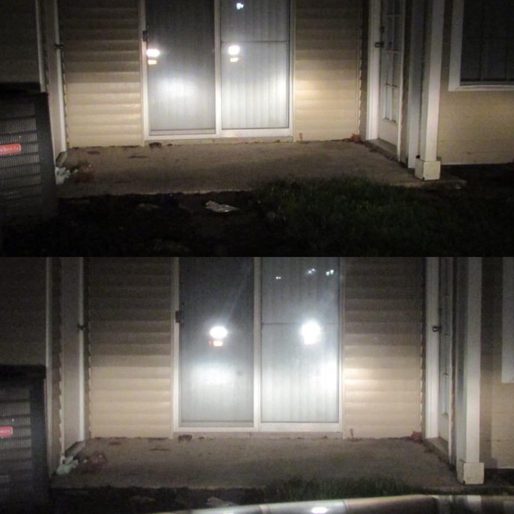

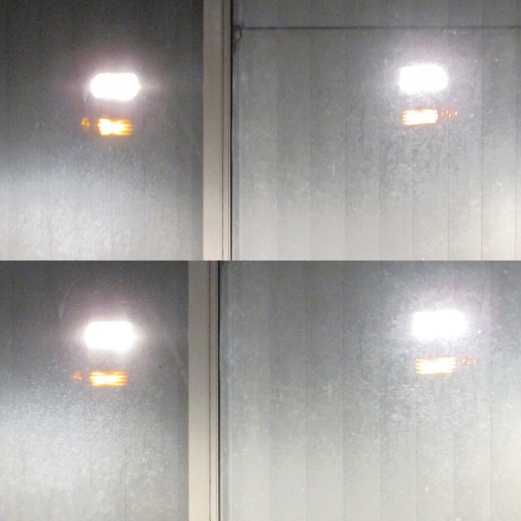

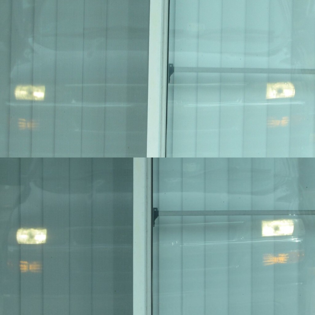

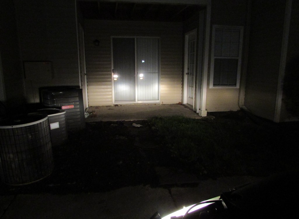

I'm no expert at taking pictures of lights obviously, but here are the pictures "side-by-side" for comparison. Top pictures are OEM, bottom are with the HRK5 kit. It's faint, but there is a difference. I also have the PIAA Xtreme White Plus halogen bulbs on the way to replace the not so bright Sylvania's

nothing with audio. I swapped out the cheap eBay blue interior LEDS that didn't work half of the time with some clear white LEDs from superbrightleds.com. I installed the secondary battery tray, and am now waiting on some 1/0 and battery terminals to ship.
