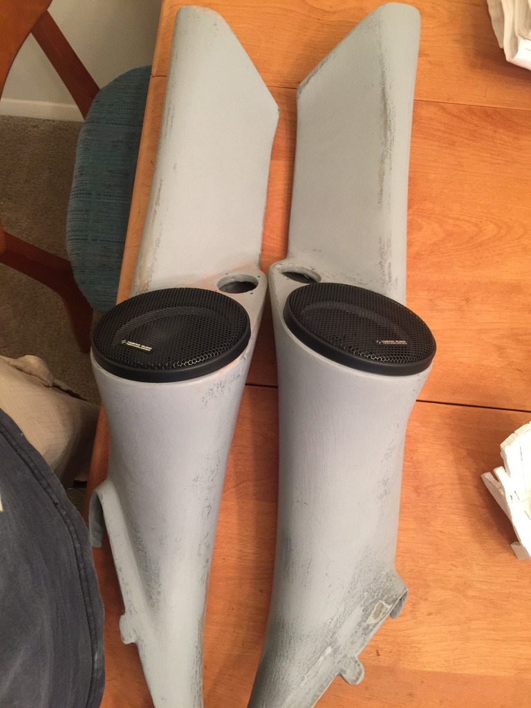

Smallest progress update ever.
i finally got around to working on my pillars. I can't take credit for the glassing or anything. I bought these off of someone else, sanded the paint down, and now I'm doing a little filling in some small spots where the body work and edges were damaged when it arrived. Once I'm satisfied I'll use the SEM paint I bought which is a medium gray. The current color you see is from primer filler to see what spots need work.

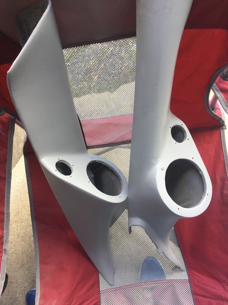

Coat of primer
theres still sand scratches and imperfections, but I'm ok with it.

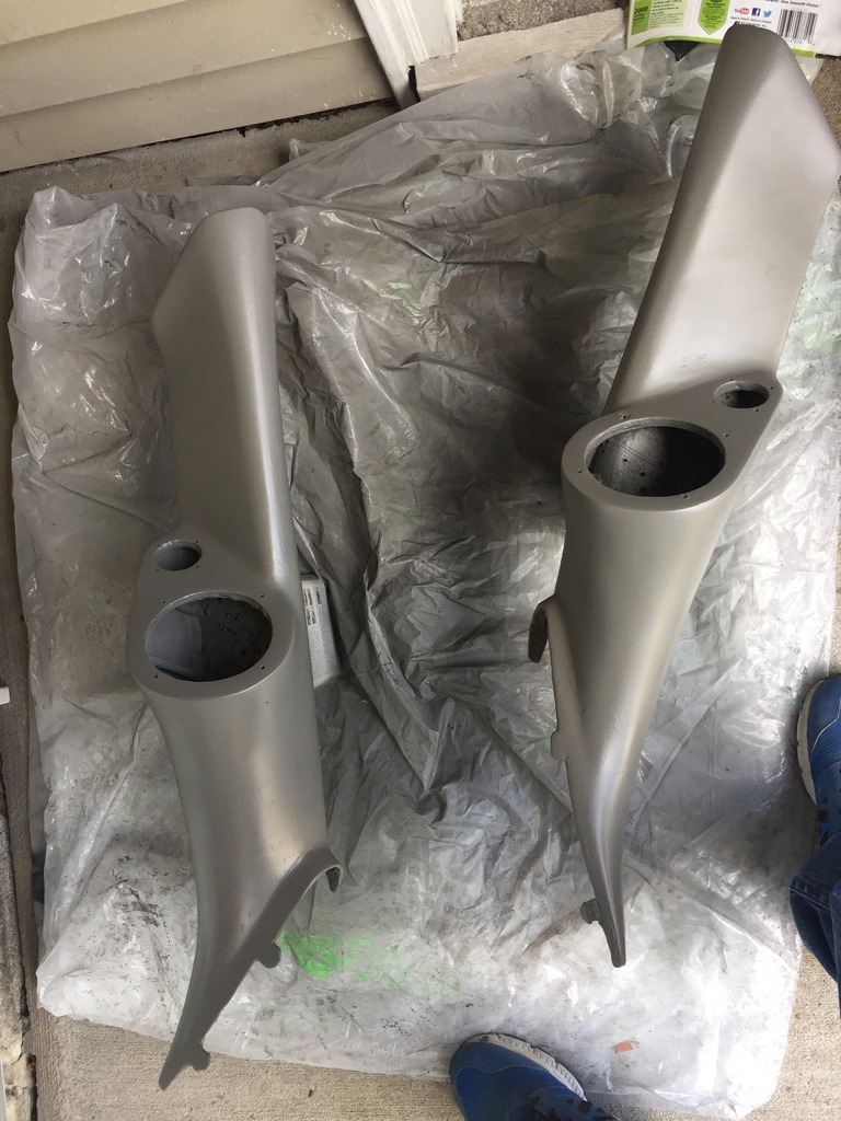

base coat of the color they'll be. SEM Medium Dark Pewter. Matches the interior panels, except maybe it's a tad darker than the OE stuff
They fit perfectly on top of Bondo resin cans so they're not touching anything while drying between coats
