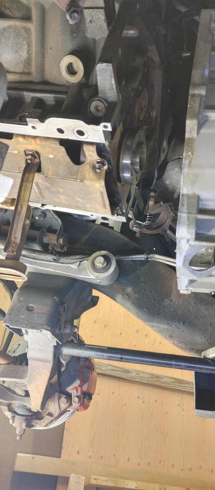

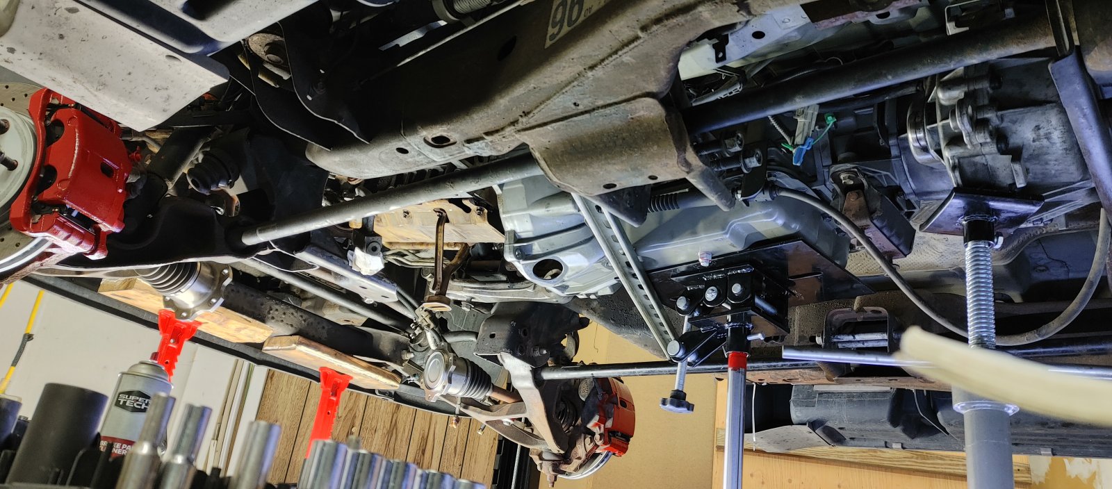

Yes, it is possible. I have swapped out the rear main seal by pulling the transmission back, it will give you about 5 or 6 inches of clearance. Mind you I had a 4 post lift, transmission jack and tall Jackstands to hold the trans and transfer case. Also a piece of strut or wood underneath the very front of transmission (for safety) and the strut or wood riding on the torque arms for the front tires. Zip tied the strut to keep it from moving. Got to be careful doing this but it is very doable. Don't forget to undo transmission lines, and cables, fuel line brackets, running to trans and dipstick tube. I think I've performed this about 3 times. Also while you have the rear main cover off, replace the oil barbell with an aluminum one. Might as well do the oil pan gasket while you're there to. Use a centering tool and take your time. Also don't forget to put the right stuff gasket maker in the lower corners. One last thing. I ran the engine without the trans hooked up to make sure no leaks for at least 20 minutes ( with transmission cables hooked up, the computer needs this to let it start). This has saved me a lot of rework since I discovered leaks several times before I got it water tight like a frogs butt.
