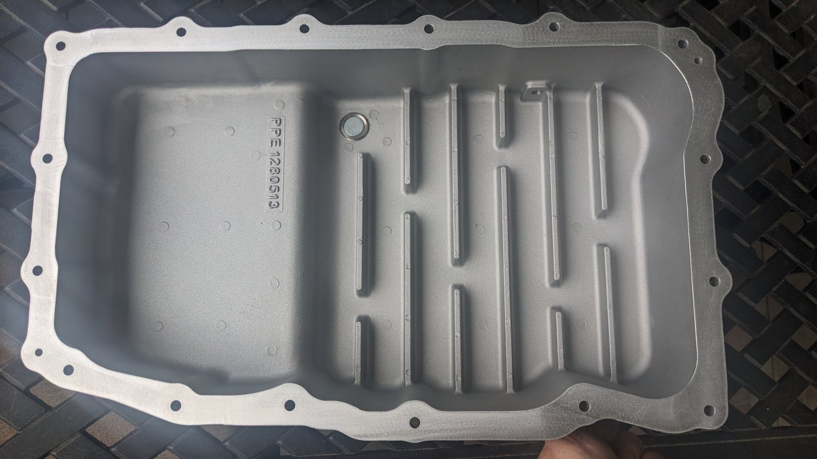

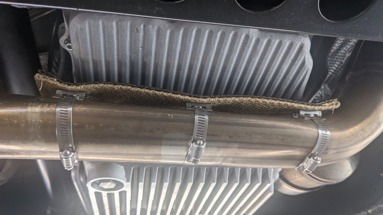

In theory the trans pan gasket is reusable, however, I would not reuse it if over 2-3 years old. The OEM pan is only slightly thicker than a beer or soda can, easy to bend, warp, distort. The key to a good seal is use brake cleaner to clean the pan, gasket and transmission gasket surface. Any oil will compromise the seal and a bad trans pan also is a problem. I would recommend installing a PPE pan with a drain plug. The PPE pan is a solid cast pan with a strong, flat gasket surface that will not distort or bend. Then get all oil off gasket and mating surfaces.
