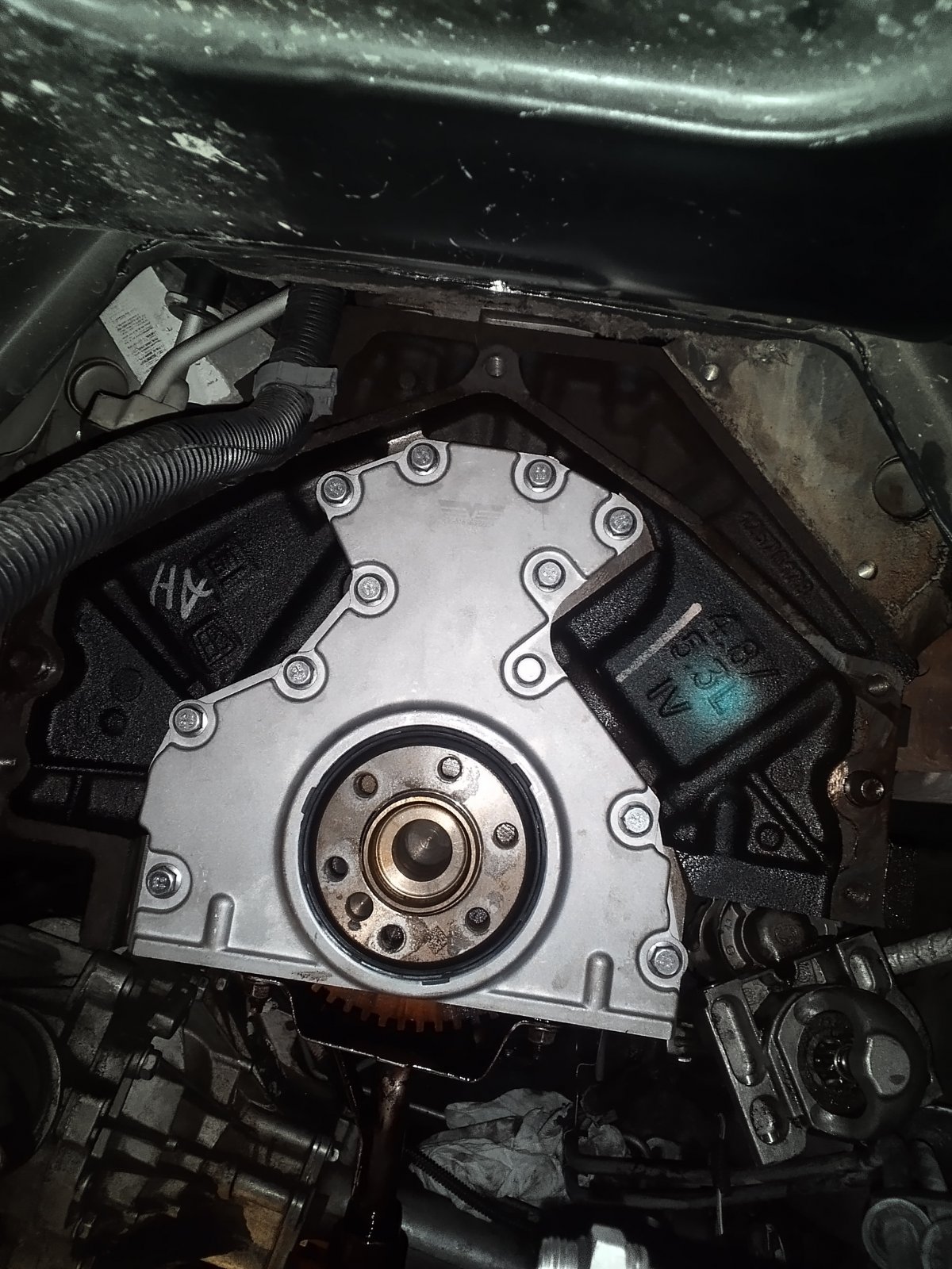

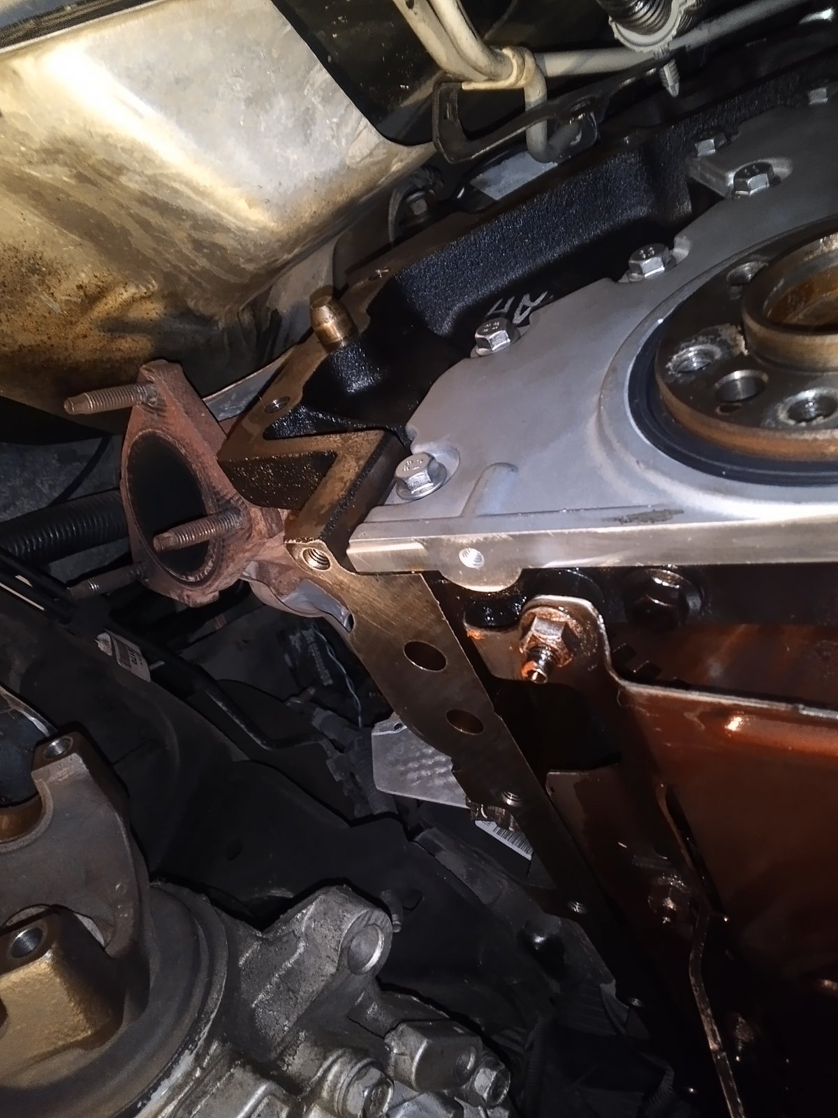

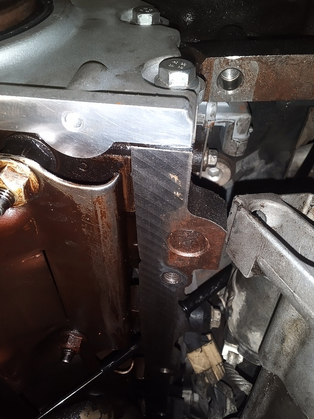

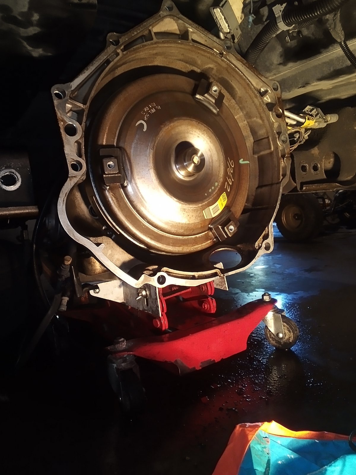

Last night got the rear cover and gasket on. I tried my best to make sure the cover is flush with the block. One thing I did notice was the bottom edge of the gasket was protuding a little too much so I loosened the bolts and gently moved it up a little.
Another thing that had me curious was the instructions that came with my rear seal instructed me to tighten the rear cover bolts to 22 ft lb. I researched off google and alldatadiy it was suppose to be 18ft lb. I contacted tech support and they told me that the engineers said it was tested and best to be torqued to 22ft lb.
The Oil Pan gasket and O-ring for the pickup tube should be here tomorrow. Hopefully I can replace it without any issues. Then next up will be the transmission seals. This little trans jack I bought 20 years ago from harbor freight came in handy. Used it a few times to change a transmissions on my older fords and chevys.
52,954
I would use a metal straight edge to line that up, like the metal ruler on a t-square, to simulate the trans being there. Maybe just check, I think it looks fine but it’s hard to tell. And those gaps right where the cover meets the block- that’s where the RTV goes when you install the pan. You’re just filling that gap because the gasket can’t seal a gap.

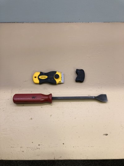

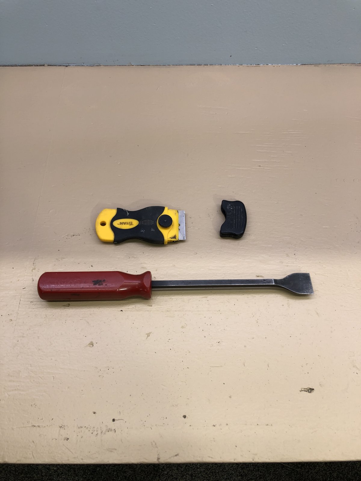

what are yall guys using to get the old transfer case gasket off the case well around the bolt holes. the gasket almost feels as hard as concrete..im trying to scrap them but I will be forever
89Suburban
Bull in the china shop
Space X Supporting Member
Jan 10, 2013
18,032
51,355
SE PA
I remember they made a spray can gasket dissolver years ago. Been a while since I used it.
52,954
I generally use a gasket scraper. A straight edge razor blade will work too. Combine those with a solvent like lacquer thinner.

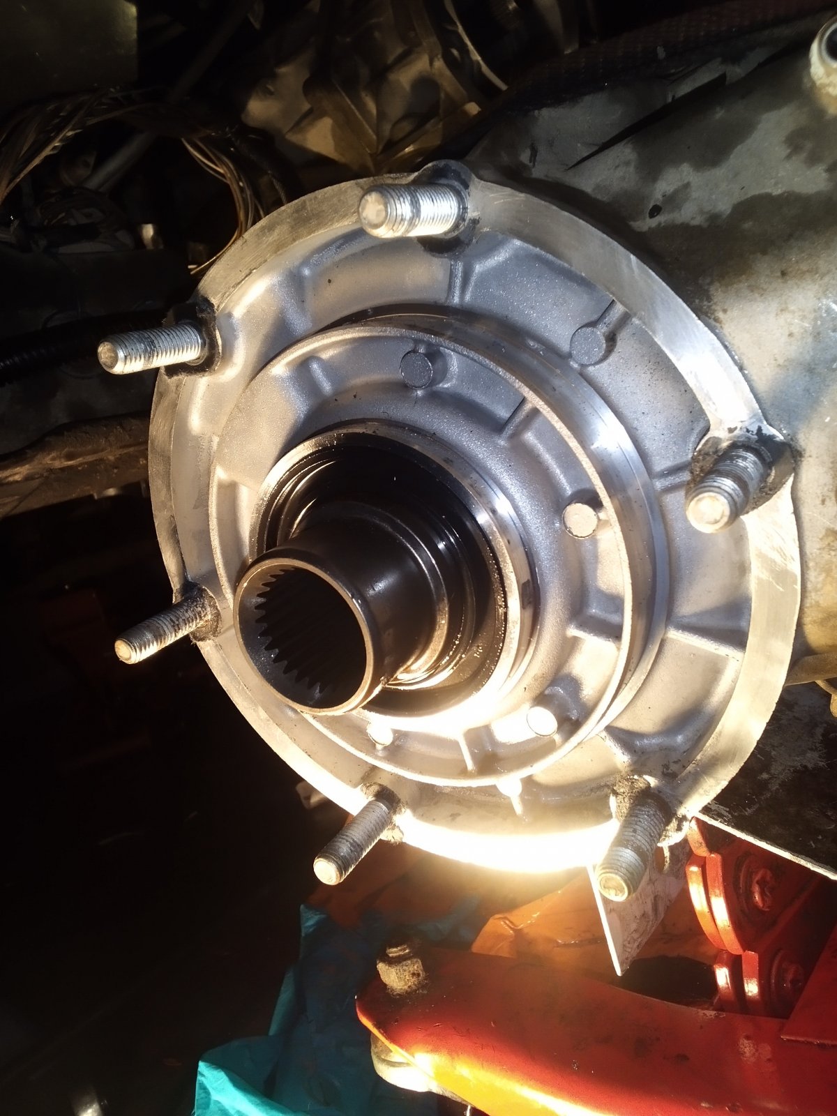

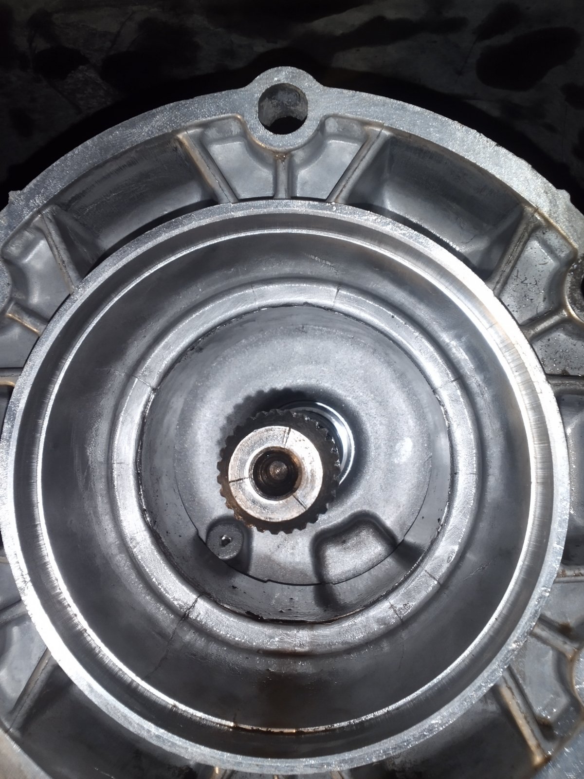

Im wondering if brake cleaner will loosen up the old gasket. I got tired and called it a day. Hopefully someone has ran into this issue.
Also does it look like my transfer case adapter is cracked or is that just the way its designed
52,954
The gasket scraper tool I referenced will work on that. Harbor Freight sells them under “scraper”. Anybody that’s worked on something with a gasket has run into this.
