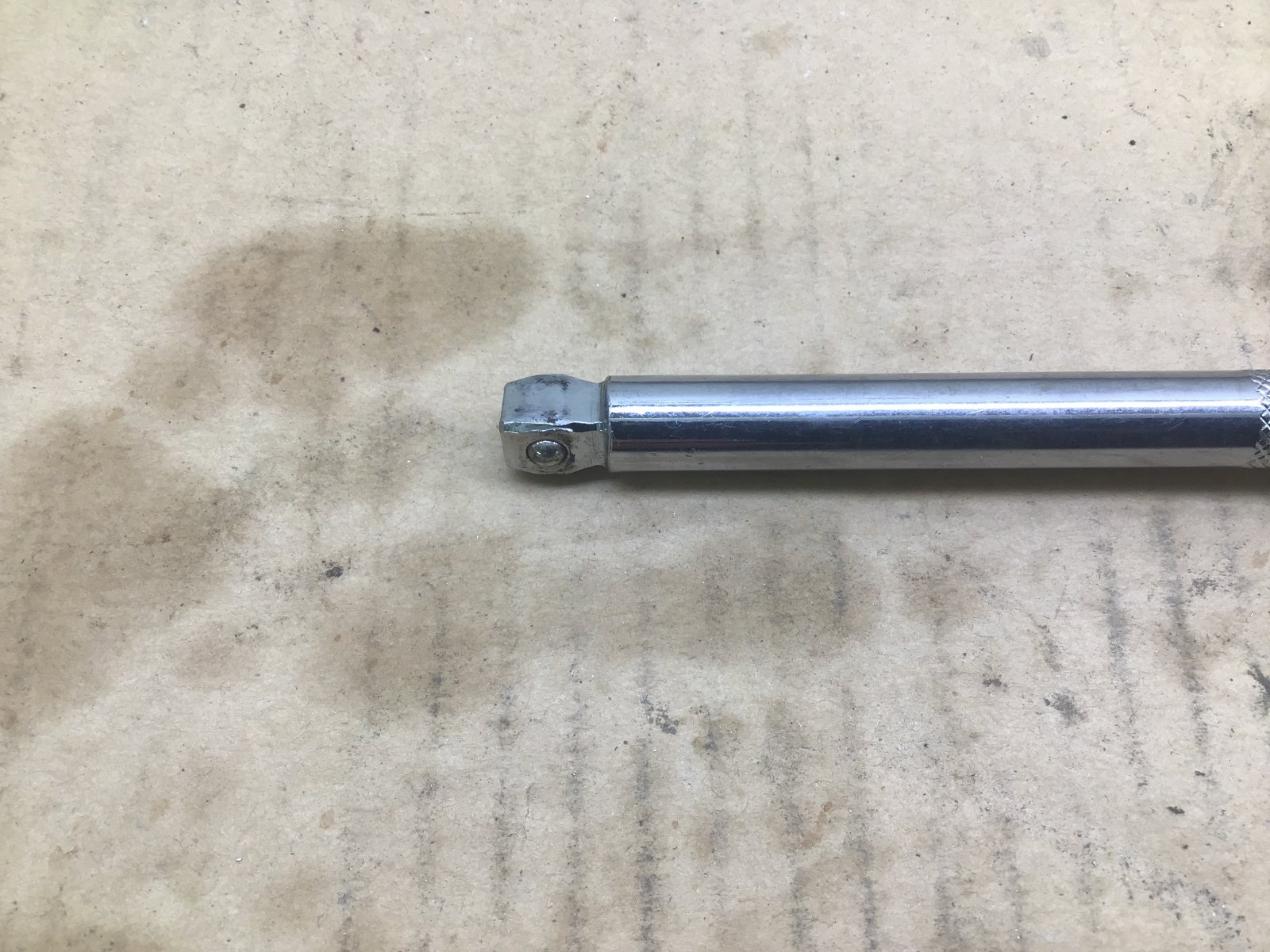

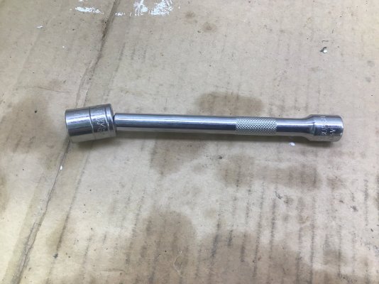

Just don’t round off those bolts or you’ll be screwed. In other words, make sure the socket is seated square. They make wobble extensions that allow the socket to be square to the bolt but the extension and ratchet or impact can angle a bit.

With extension and swivel it kept trying to slide off the bolt I was afraid I would strip it and then the motor kept unlocking..so today I'm going to see if I can pick up earthquake xt and borrow my father's compressor

I wouldn’t use a swivel on an impact myself. A wobble yes but a swivel is too easy for it to slip and you can’t push on it which is what an impact does. That’s my experience anyway.

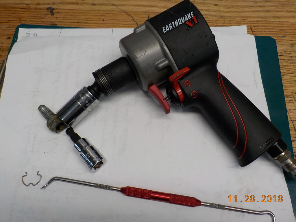

The factory must use loc-tite on them? Here's what I used, see post # 13 here: https://www.tahoeyukonforum.com/thr...7-yukon-denali-6-2.108334/page-2#post-1291646
from Harbor Freight

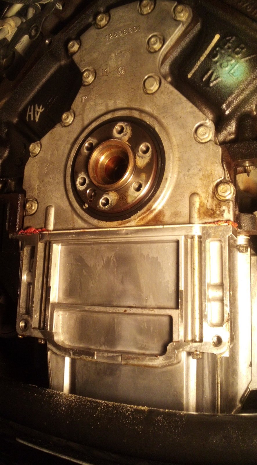

finally got all the bellhousing bolts out, and flexplate bolts out. I was able to wiggle the rear of the trans and it seperated from the motor. Im looking at the rear seal and its sign of a little oil but not much. The area to the left and right of the rear cover appear to be wet. Heres a pic does this look like this could be my oil problem?

Now I am curious. Has anybody checked if those rear main seal cover bolts came loose like the VLOM bolts? Or perimeter gasket failure compared to the actual rear main seal failure?
52,954
The rear cover has a gasket that can leak for sure. I replace the rear cover and rear main seal as one unit when I have done this. Never heard of the bolts coming loose but I’m sure it’s possible if the proper torque and application of locktite isn’t followed.

Well my leak seems to be coming from the bottom of the seal. More than likely it was leaking enough and the flexplate/crank was slinging it around in the bellhousing.

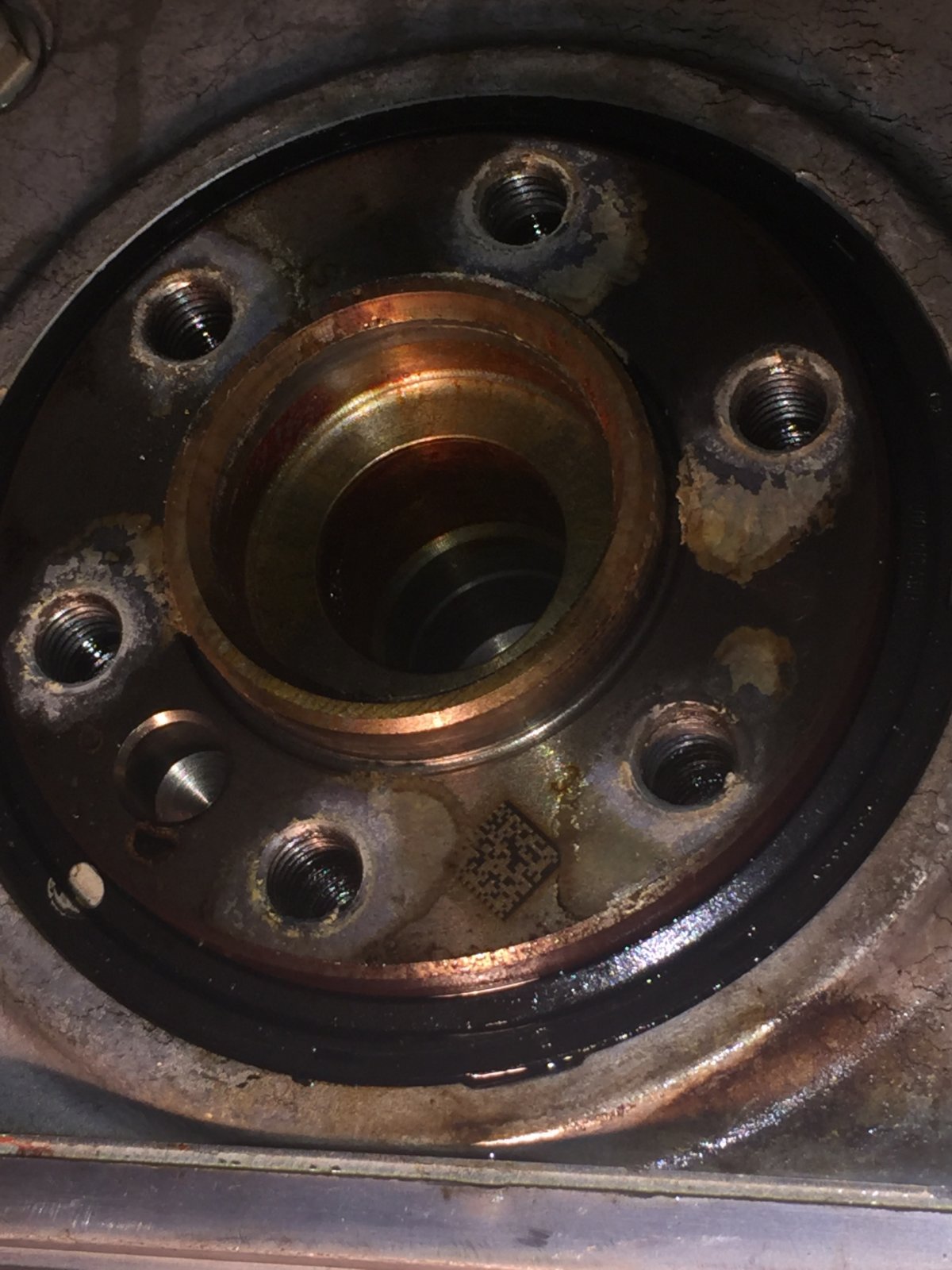

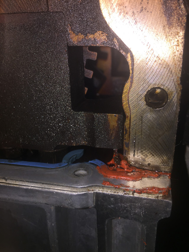

Ok cool I guess ill go that route. Just got the rear cover off to check the rear of the oil pan gasket and look here
This oil gallery plug is sticking out just a tad should it be flush with the block?
