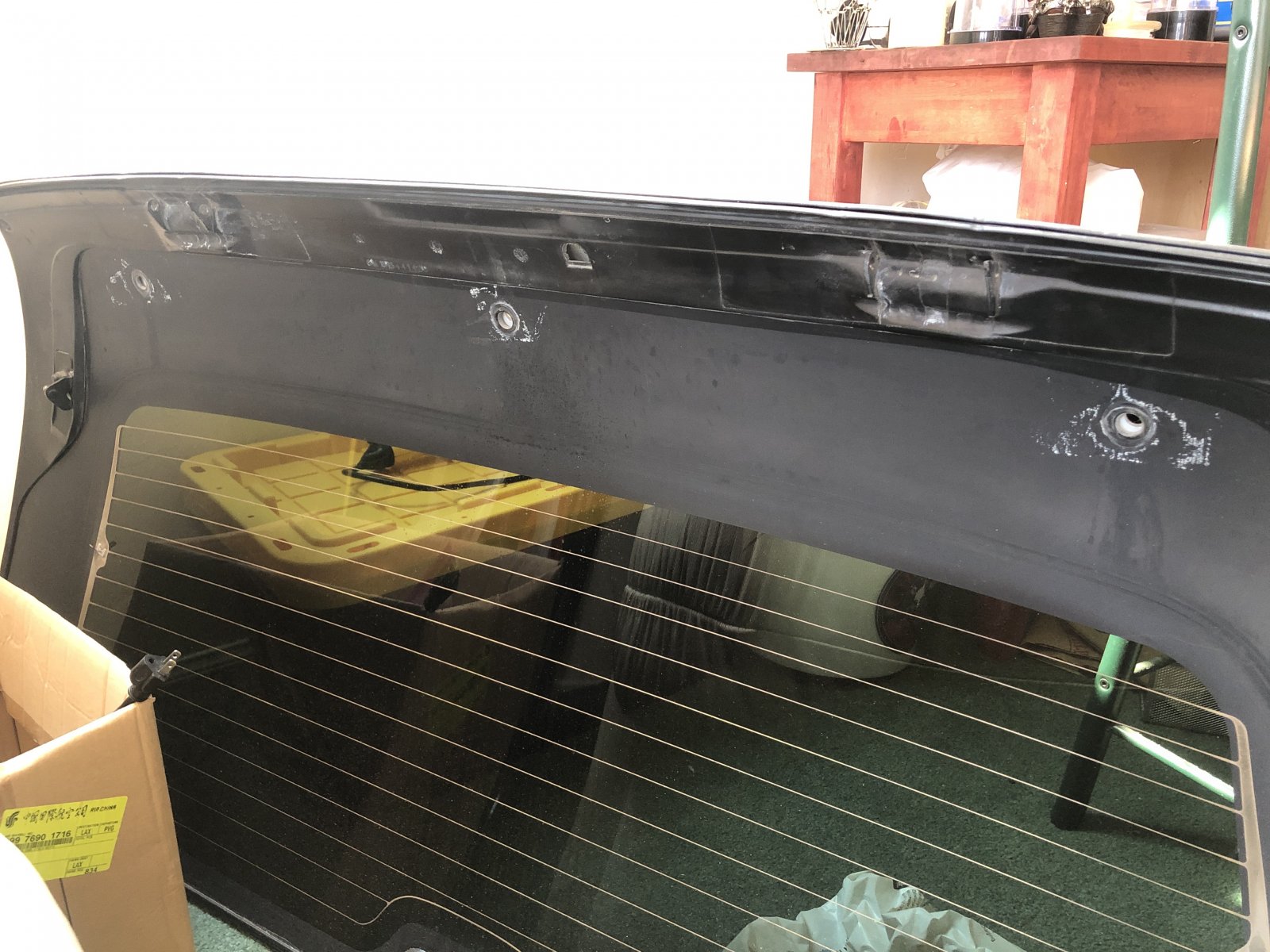

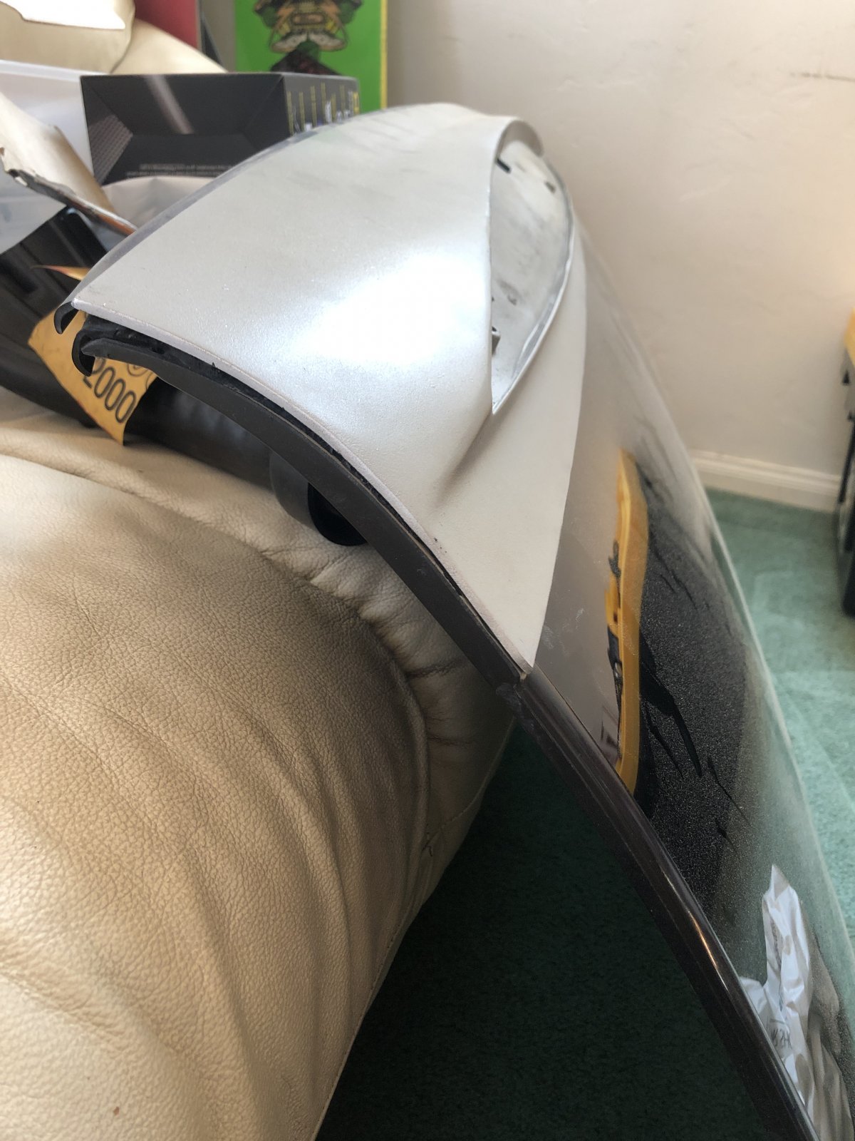

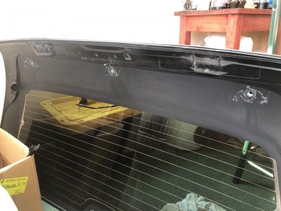

The first esky hatch I bought was a 2004 esky hatch. After a couple years on my truck the lift support hinges delaminates from the trim. The drivers side had a pretty huge gap. I was afraid if I kept opening it that the glass would shatter eventually as I’ve heard of it happening a couple times. Anyways I scored a really clean hatch off a 2002 escalade the first day it was made available at the junkyard in the high desert at the base of the mountain I live on and it had the tail light base still attached when I got there, though the light had already been grabbed. The third tail light base on the Escalade is glued with adhesive to the exterior portion of the glass, not part of the trim surround, then there are three screws that go through the glass and the base mount and screw into the underside of the tail light. Here you can see the three screw holes:
I took the 2002 hatch that I scored with intact lift support mounts, and used heavy grade JB weld all around the area where the lift support mount meets the trim, before mounting on the truck. It’s been on the truck since June and the lift support mounts have held up with the JB weld. No separation as of yet.

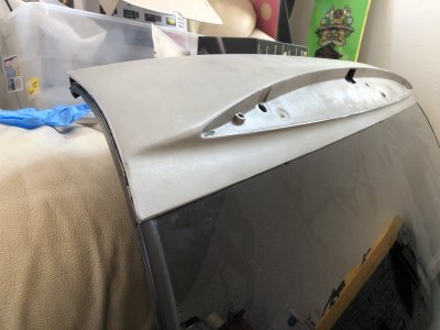

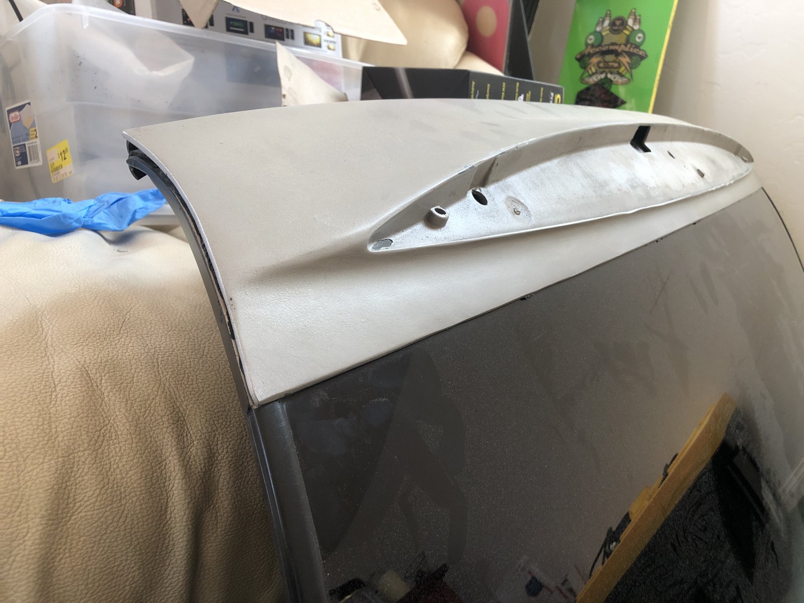

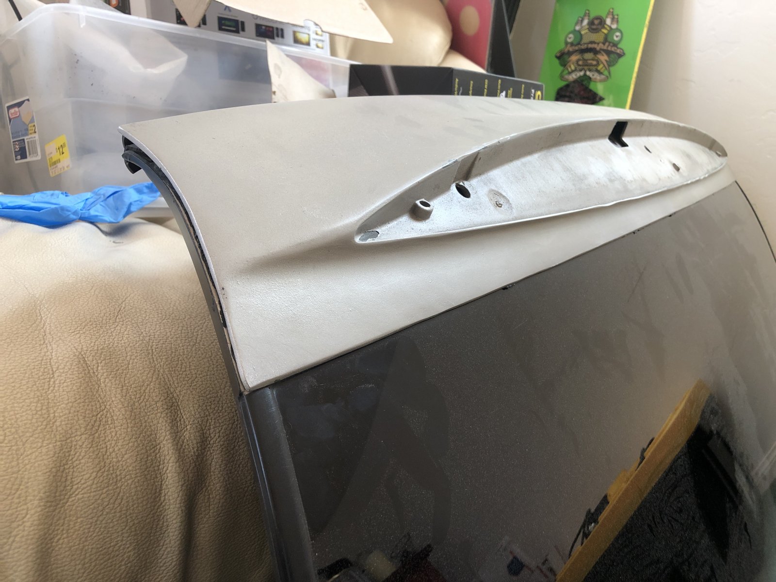

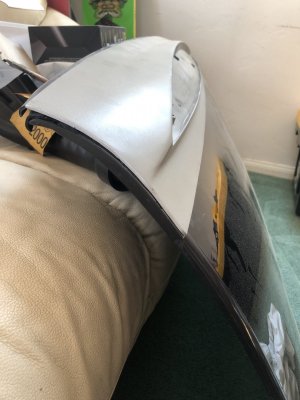

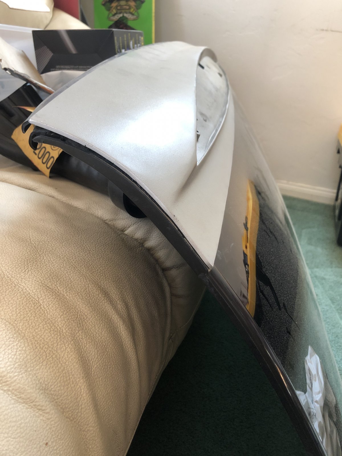

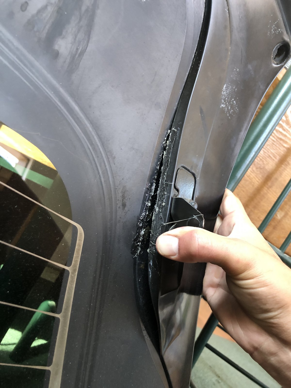

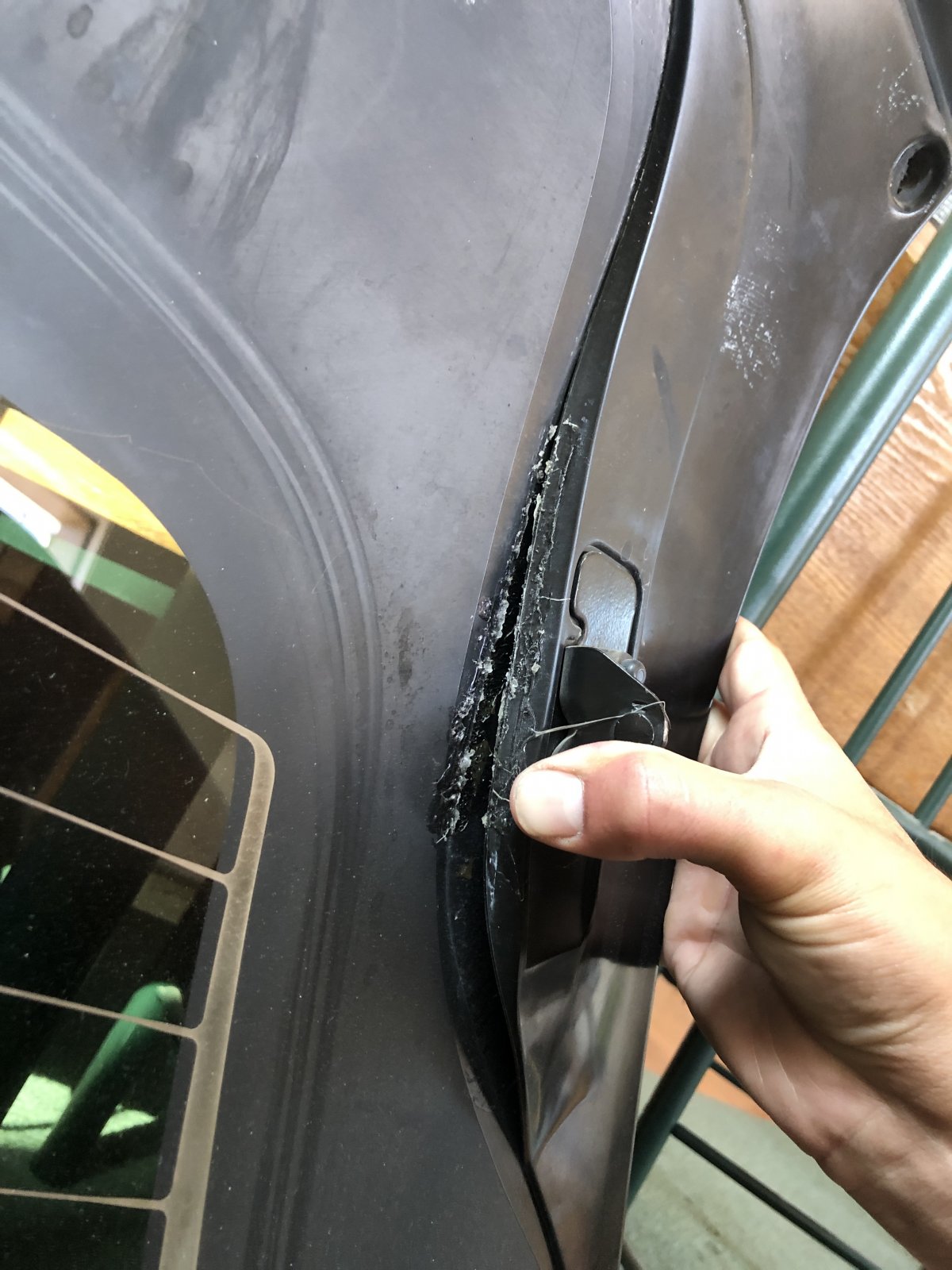

And here you can see the tail light glued to the exterior of the glass over the trim surround piece and the lift support mount separating from the trim surround:
View attachment 258433 View attachment 258434 View attachment 258435
This is exactly the problem I’m having on my ‘03. I was thinking to Expoxy/JB weld it and use speed clamps while it dries (carefully that is). Thought maybe the replacement gas struts were too strong causing the separation but it seems to be a design flaw. Thanks for the write up !!
