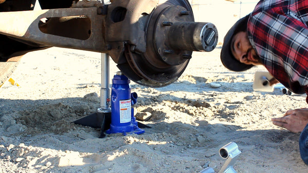

I have a set of 4 of those same jack stands. They work well and have performed great for last 6 months since I got them.
This is a debatable and fluid statement I'm about to make but: They're the best bang for your buck jack stands ever made for retail sale
I've not examined any High high end jack stands in my life but after a thorough examining of these, I can't see too many ways they could be made better than these things are
HAHAAHa I didn't remember saying the debatable and fluid part of that post. At least I'm finally learning to CYA or CMA.
Thought of this exchange we had when I saw this companies stands last night. Not sure what happened to their two legged stands though, the Renn Stand?? They're no longer available on their website. Safety issues maybe? They look pretty innovative but I would have to think it would be hard for anything with two legs to be more stable than something with four
The stand they have available on their site now (bottom pic) looks like it would be real nice for use on softer surfaces and would neatly tuck away under a seat between deployments.
I love finding small companies that use good ol American ingenuity to make useful stuff, that works like it supposed to

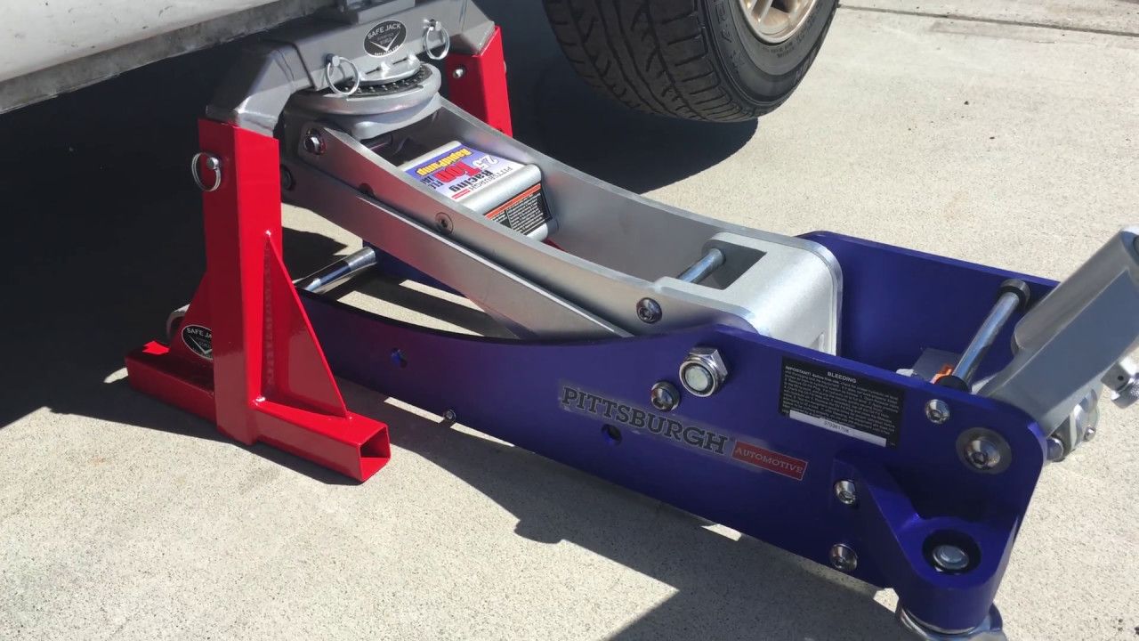

While looking at jacks/jack stands earlier I found this thing. Never seen this before but I'm definitely getting one of these, esp if there's one MADE IN USA. Uses exhaust to inflate. Lifts up to 8800lb 31.5" genius
