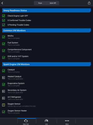

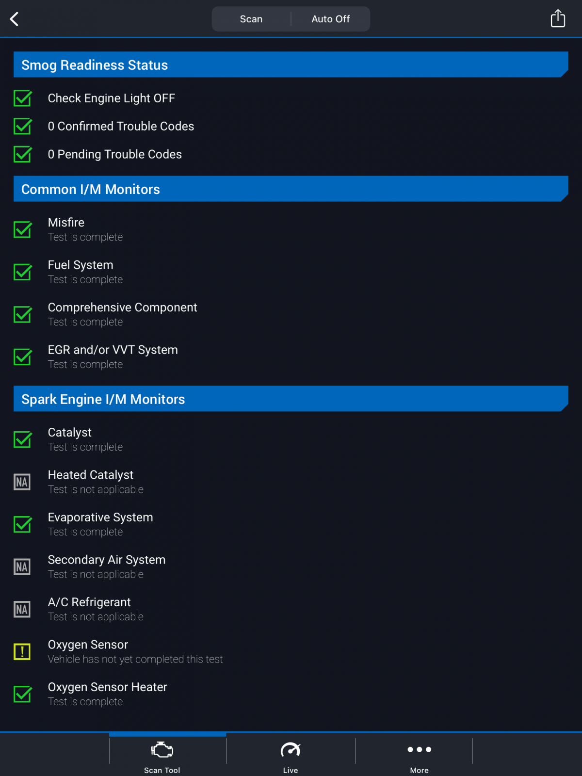

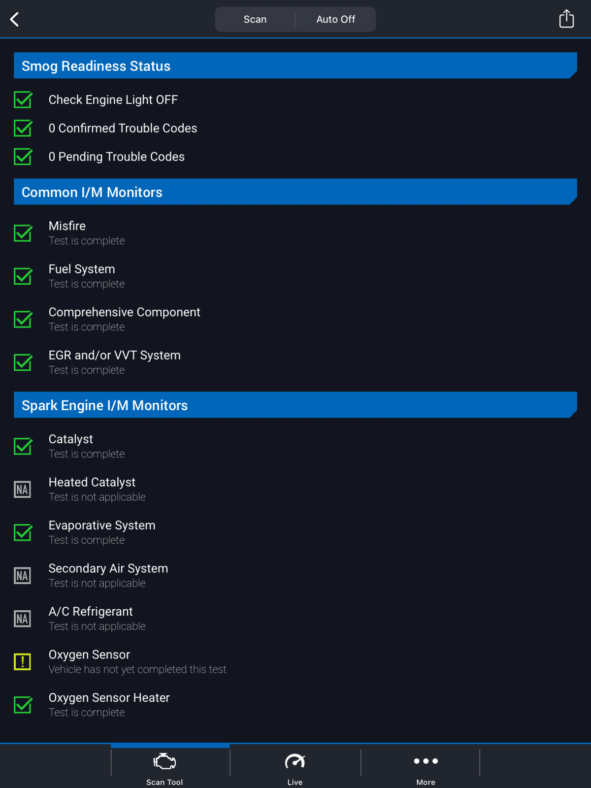

I did a quick test on theothertwin today with the blue driver. The evap is fine. Only one warning for O2 test not done.
