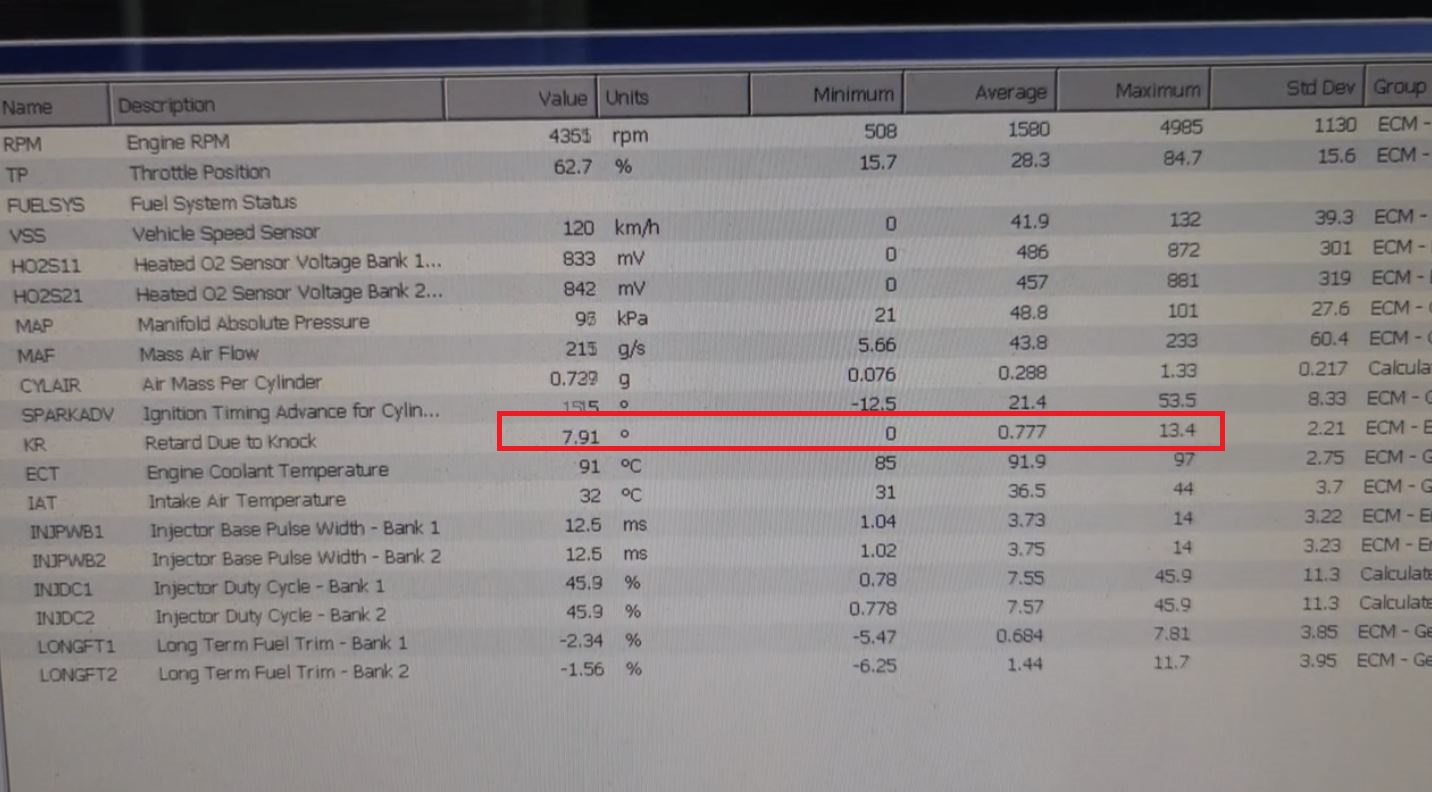

I burn them up, it happens when you drive a vehicle like it's a F1 car
THEN what happened in my case is the regular front cat's blew so much crap out it clogged up the 3rd non-monitored cat, so had to have that hollowed out
that's what was causing this problem, was fine if you drive like gramma but try to do anything , pass someone, accelerate, etc and it just caused massive backpressure

they were not melted just discolored and could only see a small bit of light thru them, failed enough to throw a code.
that 3rd cat was a issue not only causing knock retard but associated heat as well on drives in warm weather and going up a hill or mountain the temp would climb beyond normal
I can see the difference now that the clog is gone, can't say if the cat's are lasting longer now or not the last set both broke apart inside within a couple weeks of each other.
