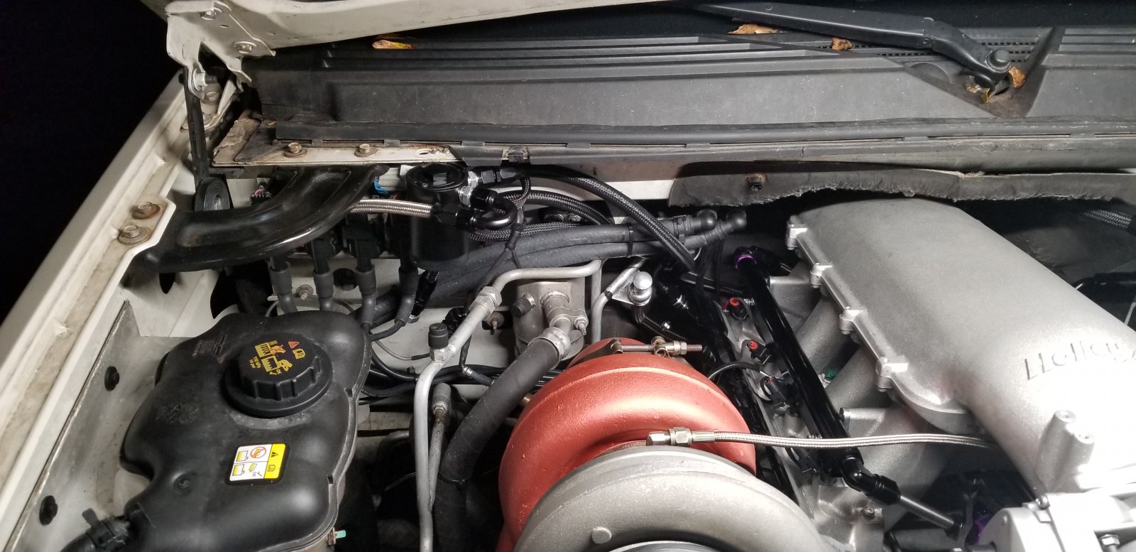

If I cant get everything hammered out and working I'm just gonna park it till next week and I have a few days off to eff with it...sick of 10pm nights every night on it

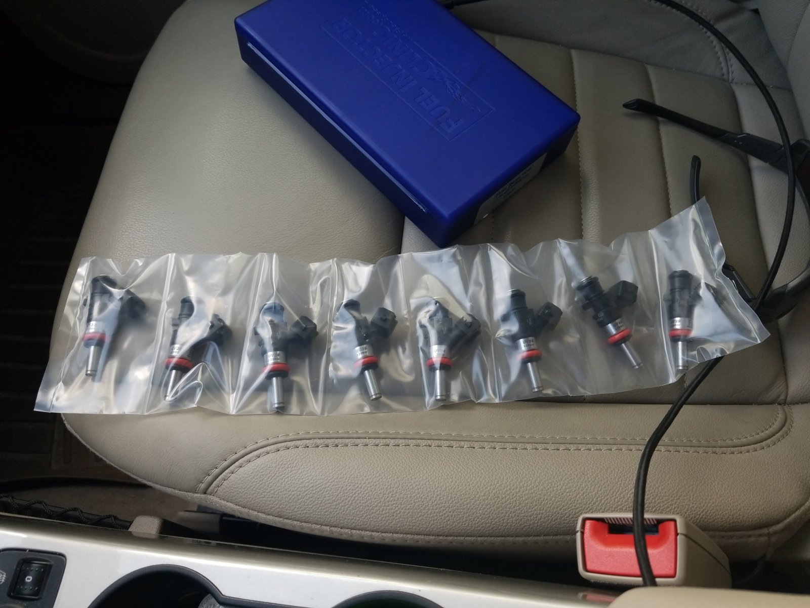

Injectors cleaned and flowed , dude said they really werent that bad. There was some trash just in them that fell out when I pulled them and turned them over. I messed with pretty much every hose so good chance some trash was left in there.
Grab valve covers from friend. No mounts for coils, I'll have to find somewhere to put them and make up ends that will take a couple hours. But ill give it a shot prob

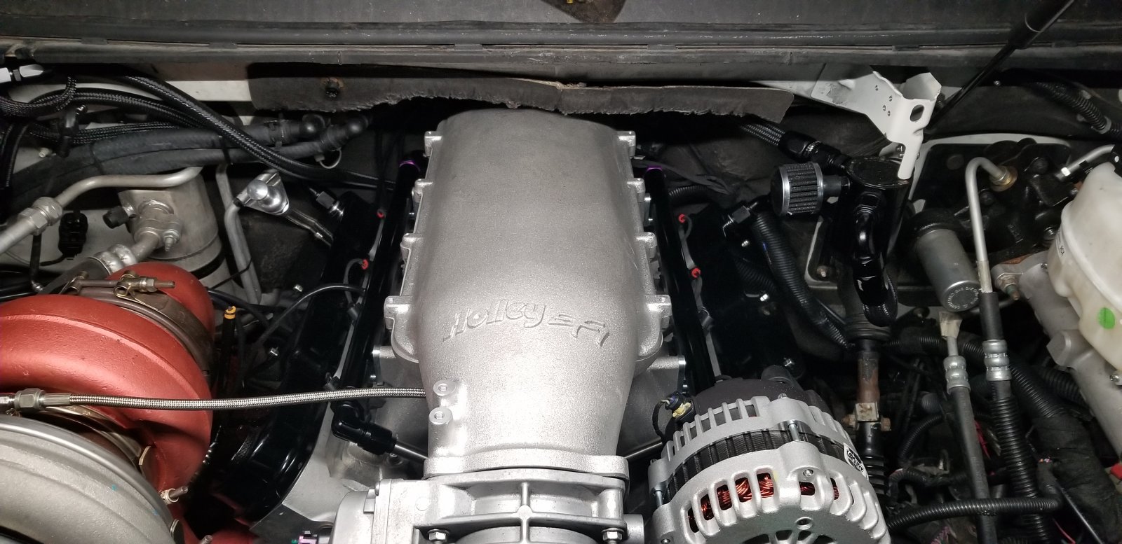

Valve covers not sure if I'll be able to fill with oil but I'll figure that out, one side done relocating coils. Going to run out of the correct crimp ends for ls coils onto these wires cause I've had two pull the end out of the ceramic insulator (factory made end) so trying to figure out how to half ass or to work

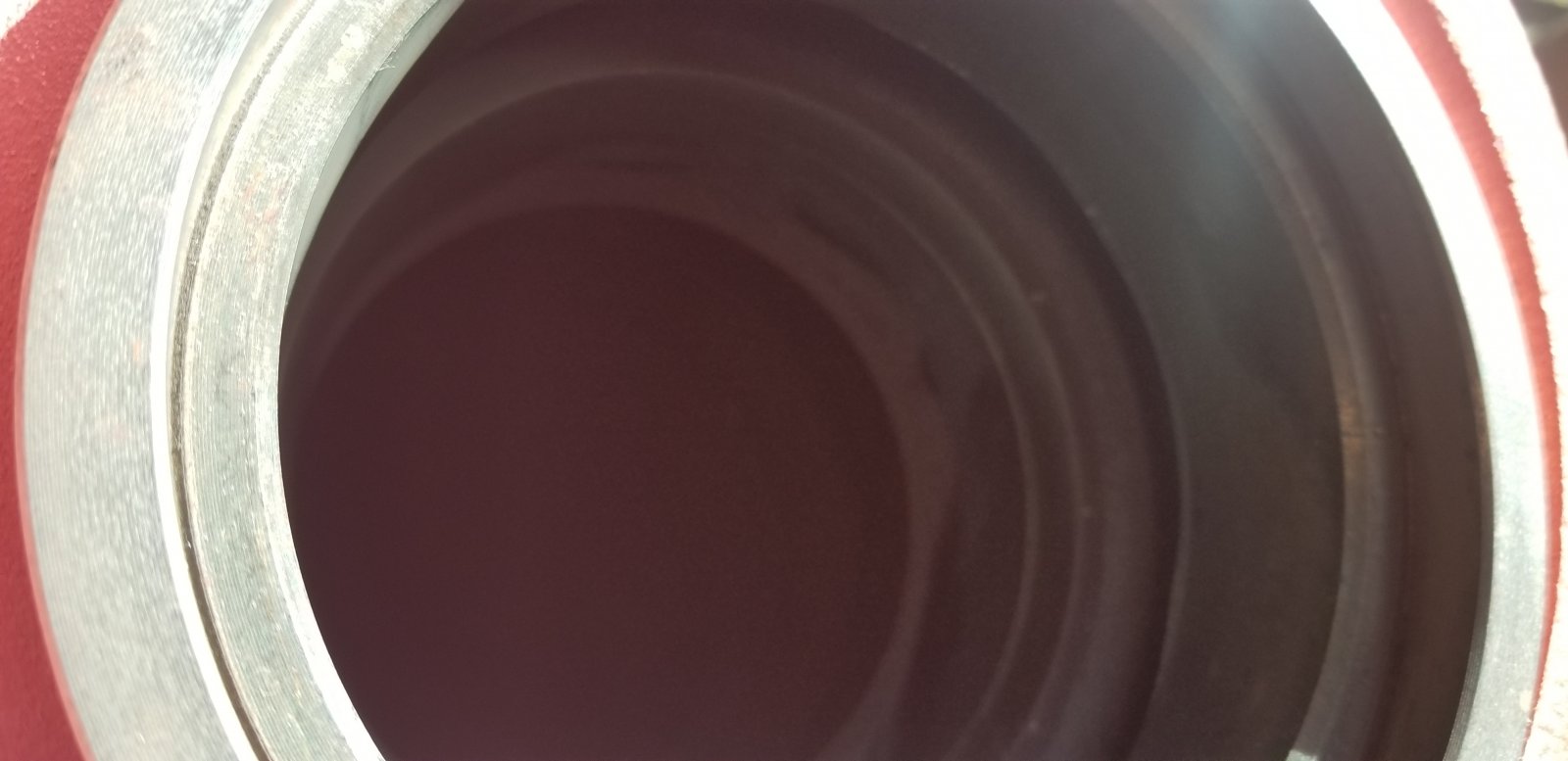

welllll screeching sound "may" have been self inflicted lol
so i got home - kid and i were at universal past couple days - decided to pull the turbo apart. got it down to the exhaust side (still in truck bolted to manifold). noticed one of the clamps was kinda bound up like it may not have been completely seated.
noticed there was some little scrape marks on the inside of the exhaust housing (white lines). sounded about a billion times worse that that looks but o well.
started truck up without the turbo guts, STILL shows fn knock . i just take a deep breath and put it all back together a little more carefully that last time aligning/seating the turbo center to the housings.
start it up, let it idle for a while, knock is a while lot less.
take it for another drive just in case and no more screeching sound and pulling time! drove it for about half hour, through some timing back in the low rpm, did some logging. everything seems to be ok

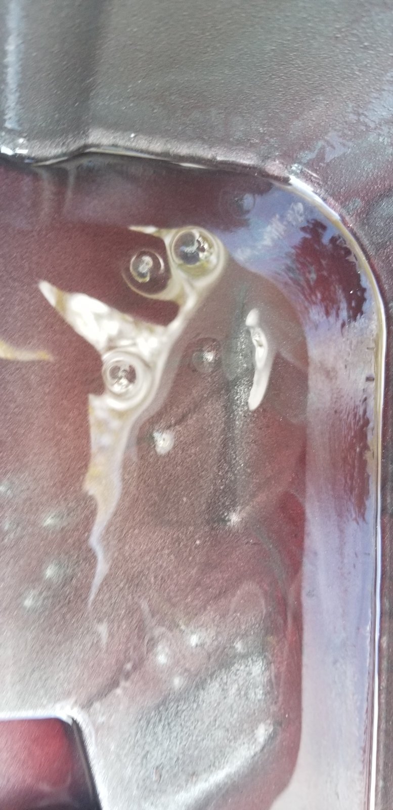

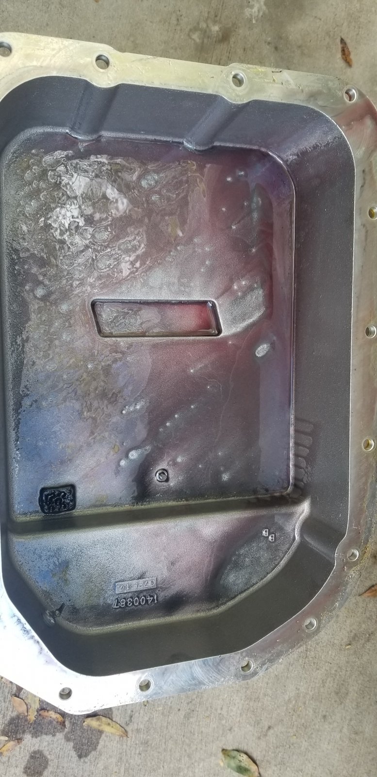

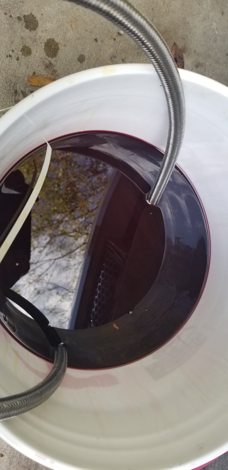

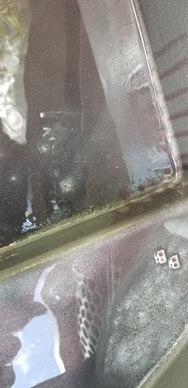

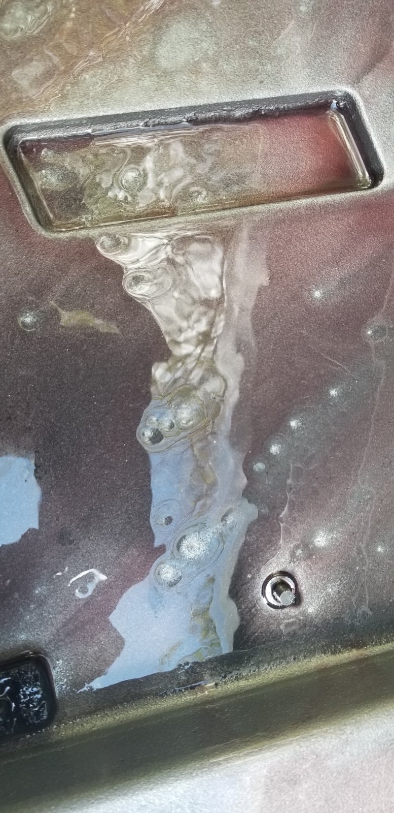

makes a wee bit o noise in a moving gear, park/neutral alls good. acts like it has zero stall speed what so ever , kinda wants to stall the engine when put in gear, temp climbs uncontrollably even locked up and at idle, sounds needs to be up to hear kind of a grinding noise
literally in between /\ those vids it just works fine, noise gone.
fluid was trashed... i pulled the return hose let it pump itself out to make sure there was no restriction in the hoses or coolers - pumped about 10 qts into bucket in under a minute, i ran another 2 qts of clean fluid through it, drained pan, swapped filter. still junk i'll post some pics from my phone in a sec of fluid and pan

either way need to get it and trans pulled back out, that amount of material i doubt could all come from the converter so going to have it cleaned and freshened back up while its down anyway.
