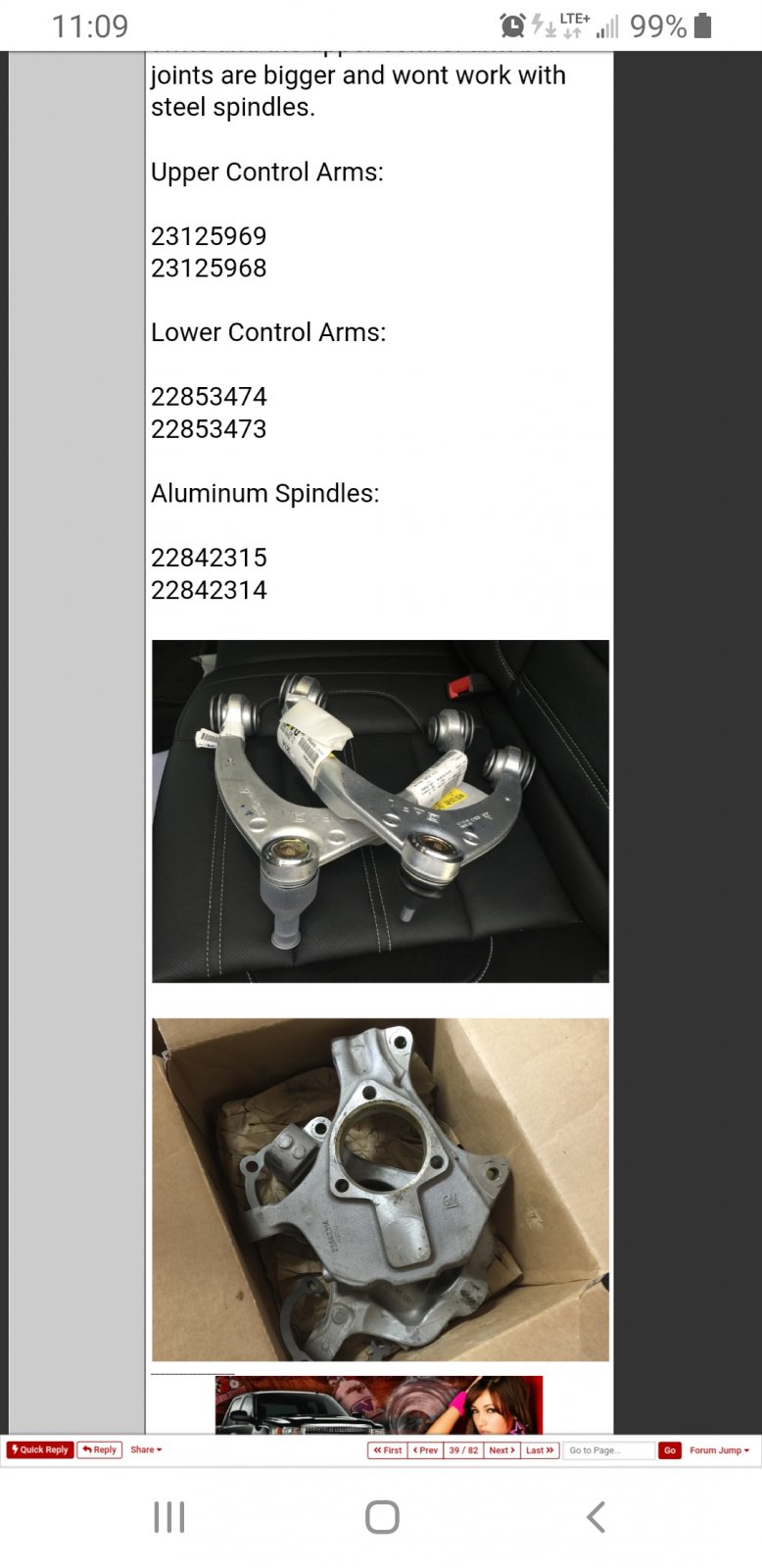

i guess the 15+ trucks come with aluminum arms and spindle up front that will all bolt up to gmt900s, maybe see if the electric power steering rack will work just powered? it looks like it mounts the exact same as the gmt900 hydro rack. hydroboost would still need hydraulic pressure but i guess theres also some electric hydro pumps that are pretty common from some volvo's pumps are cheap used >$150 come with integrated reservoir and can mount anywhere. and larger brakes/wheels are still on the list but crap keeps breaking.

I like the look of the K2 UCA, looks beefier than the ones on my 09. The LCA's on mine are aluminum and look like the ones I googled for the K2's
from my understanding they use a different upper ball joint that goes into the oem alum spindles, im sure the taper on the steel spindle can be drilled out but theyre made to go into the alu spindles

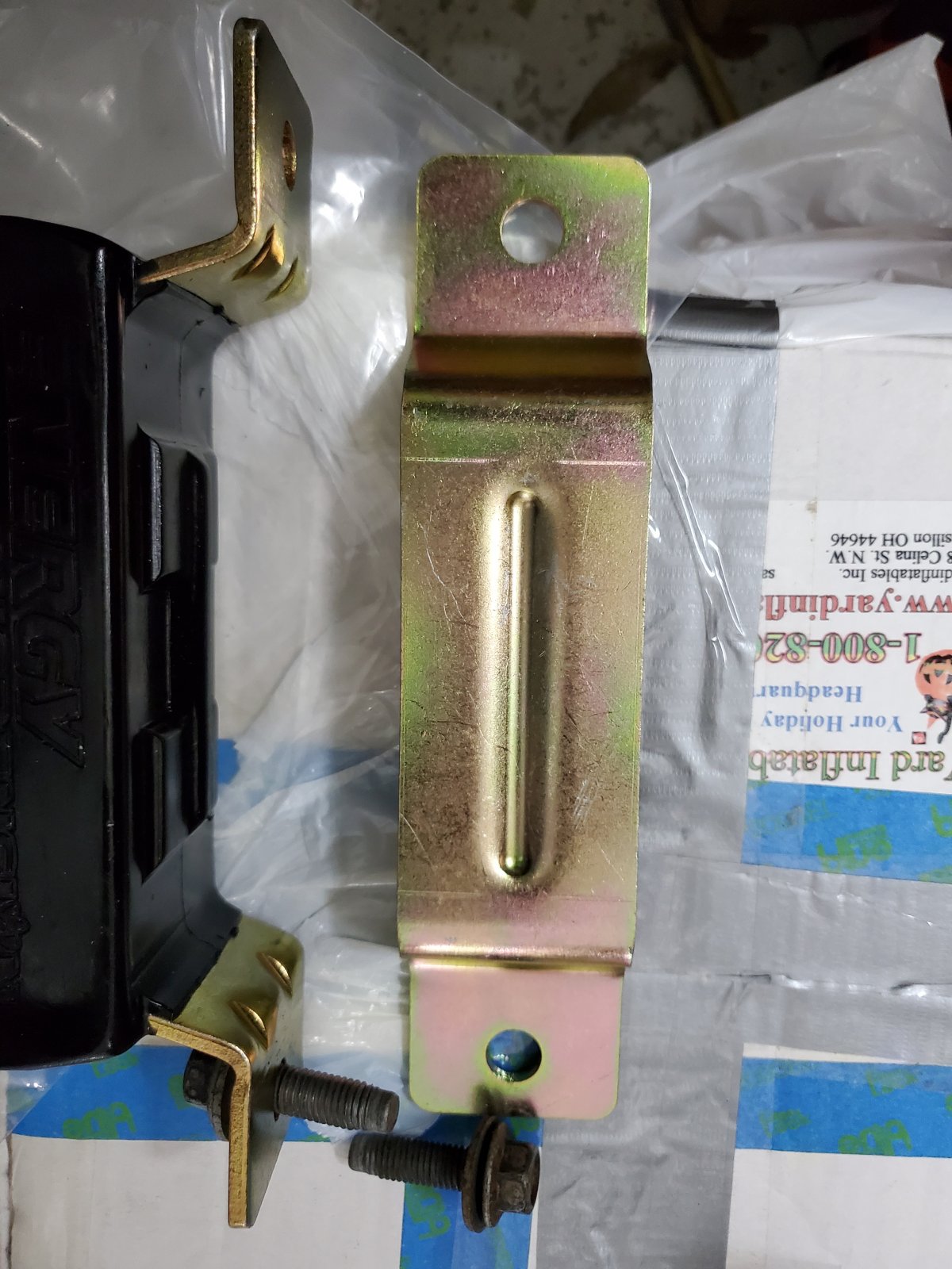

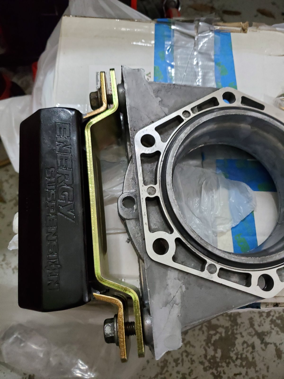

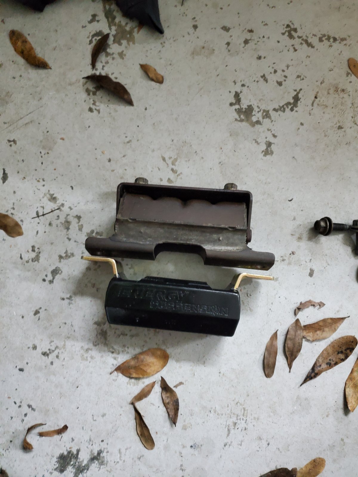

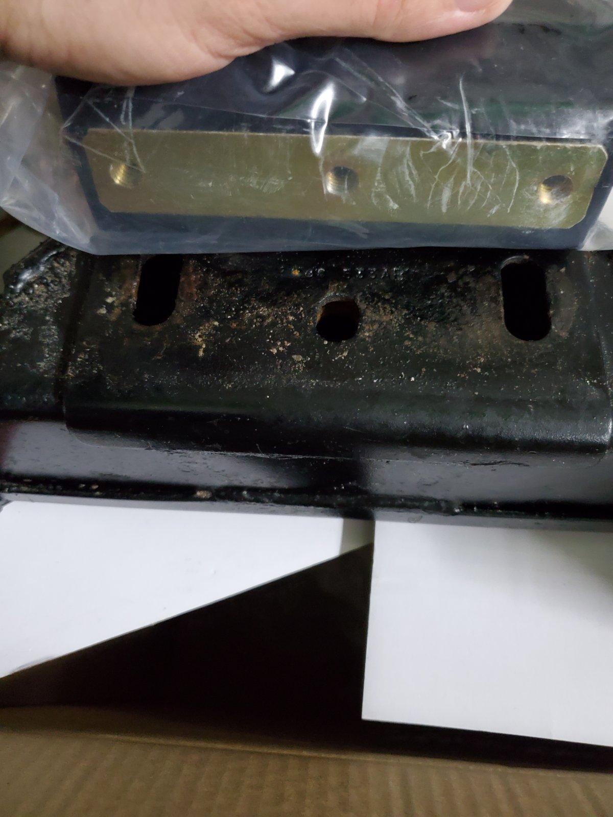

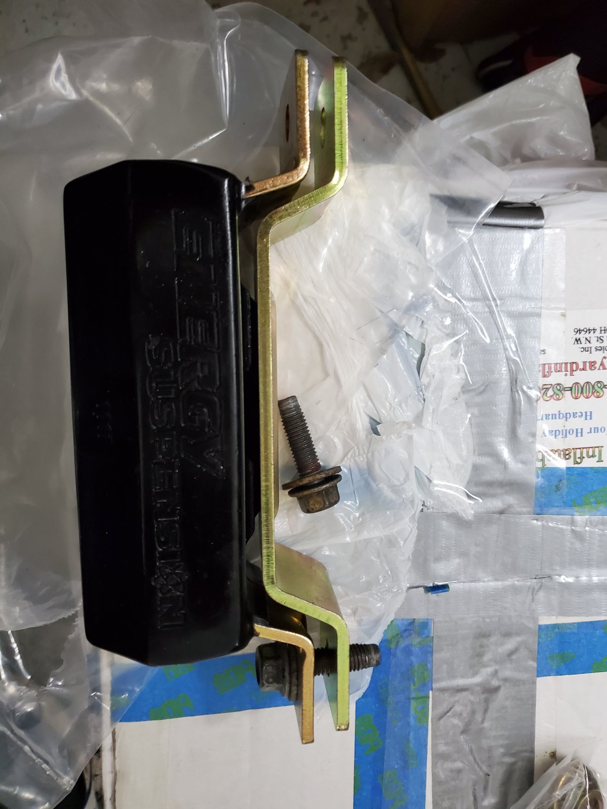

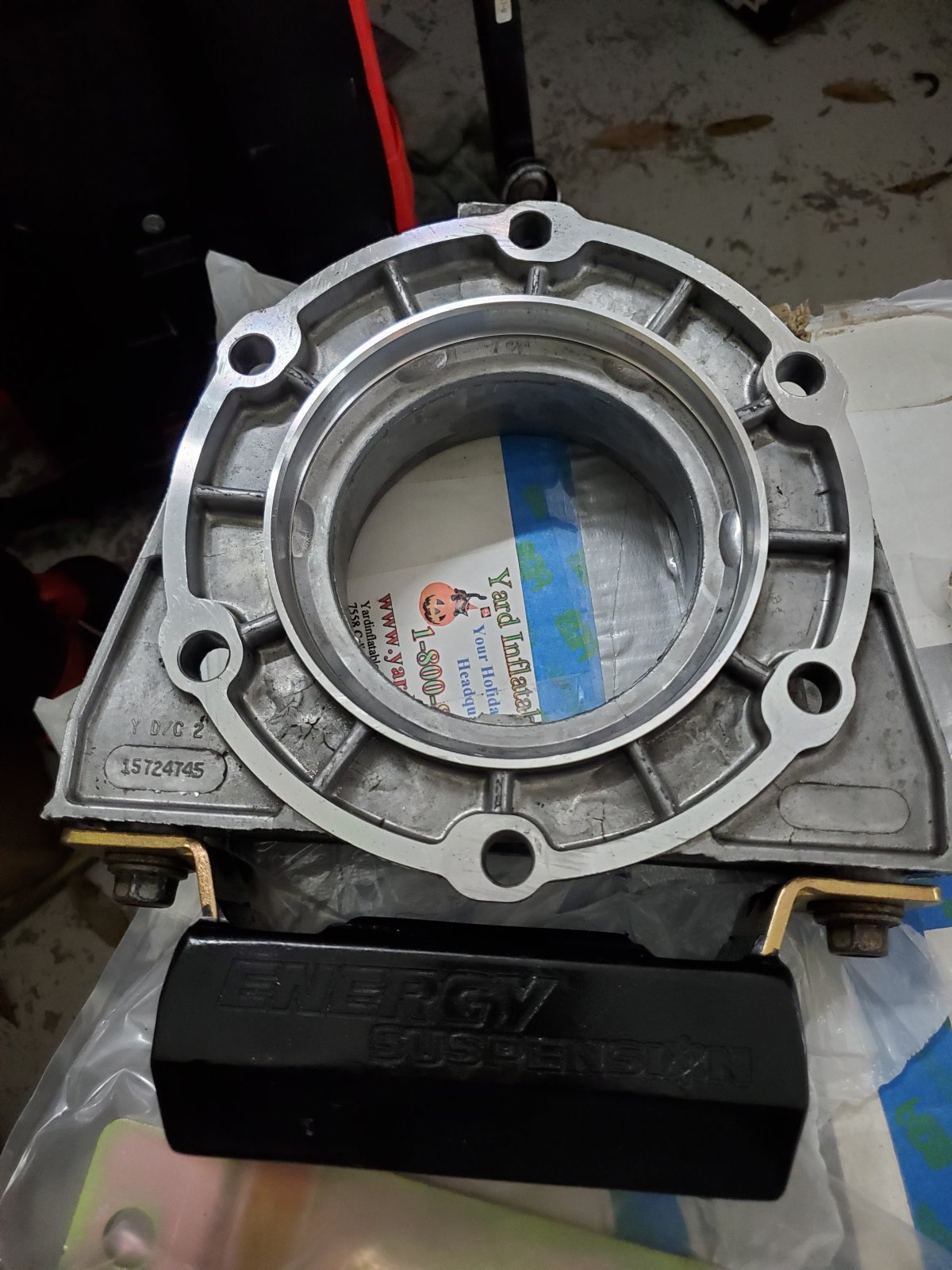

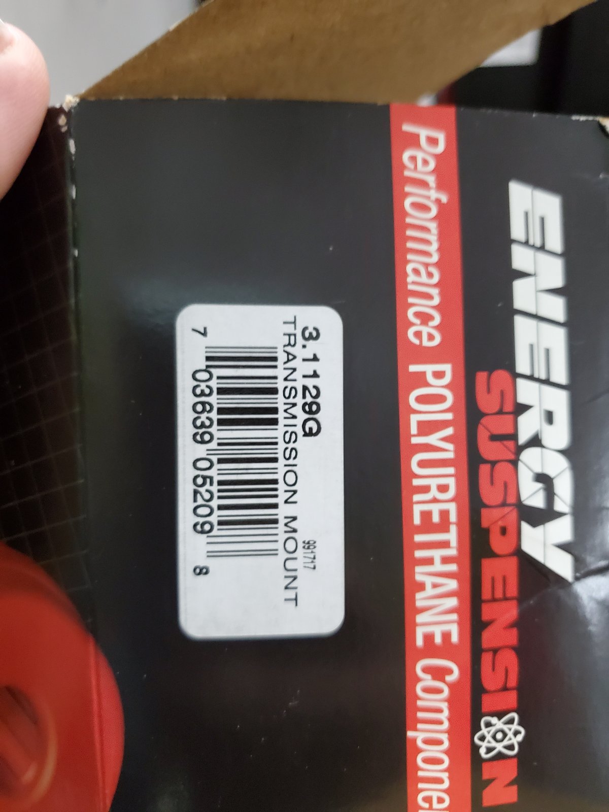

Energy suspension poly transmission mount? Didnt see an application for mine on their website but this looks like it will work for me and 6l80 4x4 (used stock mount till now so all should be the same)

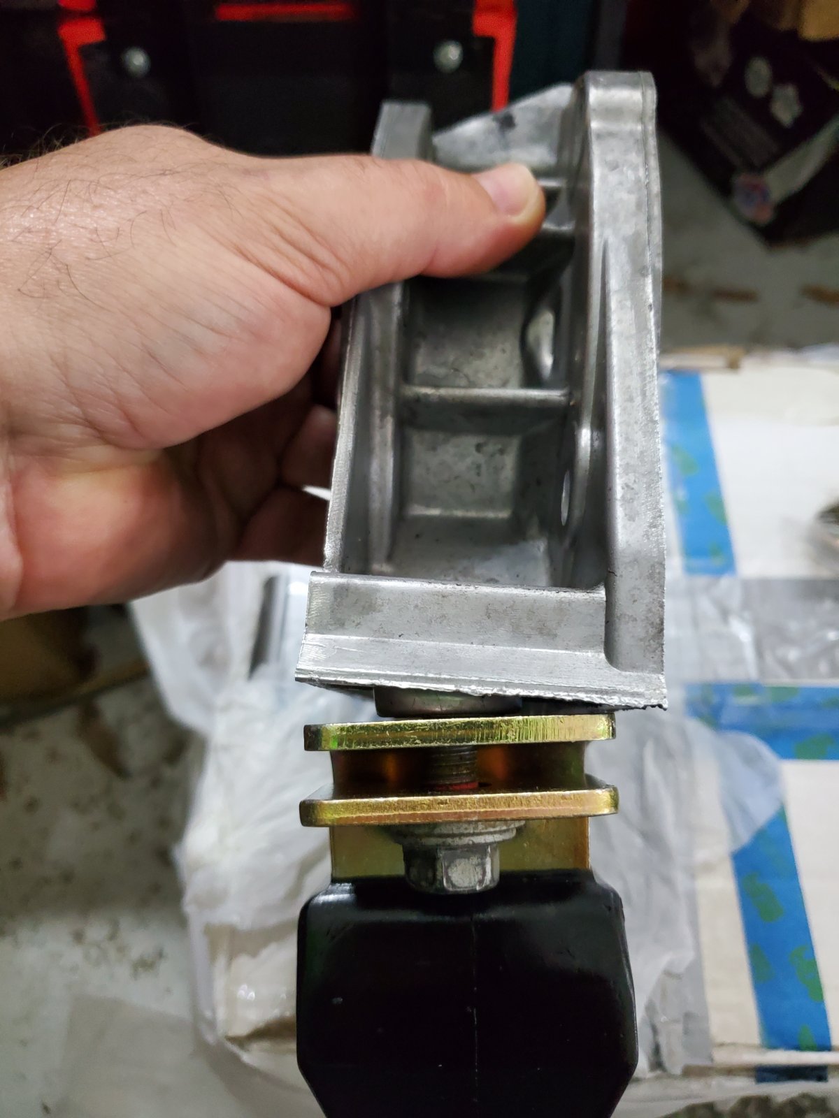

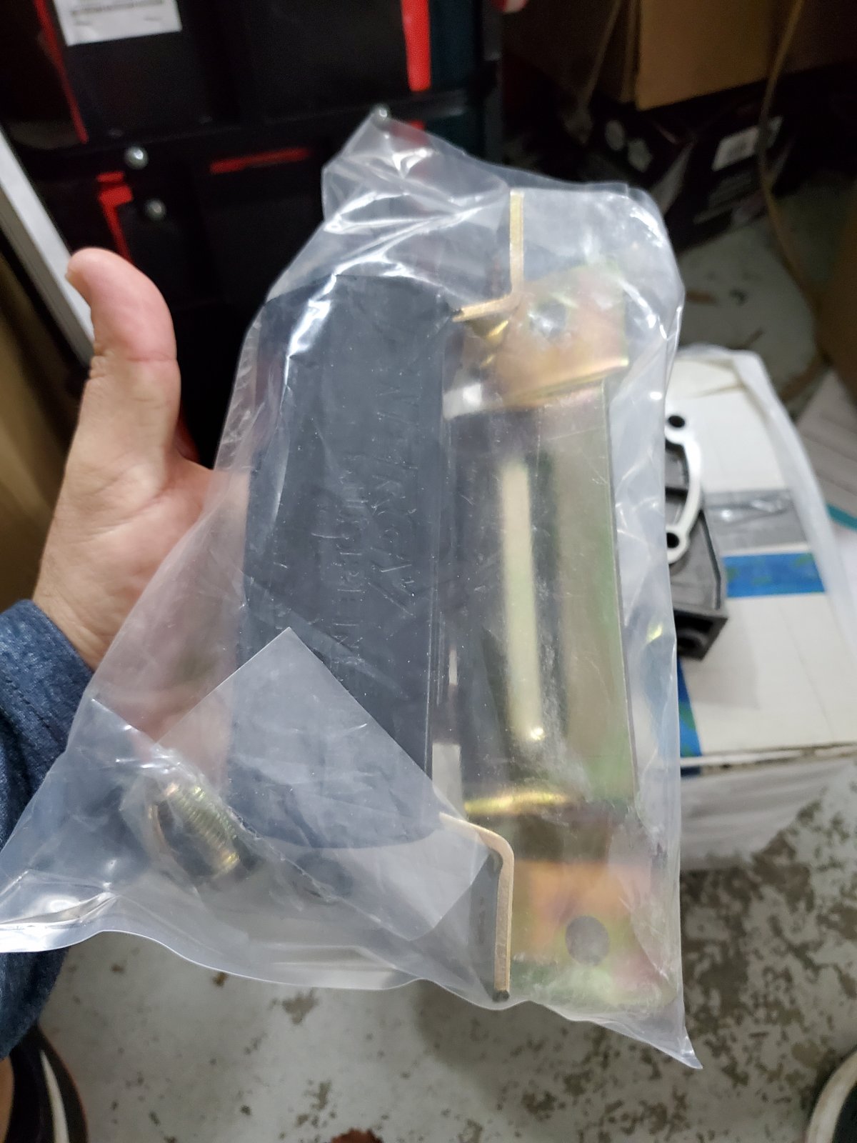

Also has this other metal bracket that looks like it stacks on top of the the one that is there? Anyone have any idea lol just kinda winging it here. And I noticed the adapter that goes between trans and tcase has an angle in it
View attachment 237996 View attachment 237997
View attachment 237999 View attachment 237998
It looks like the second plate is designed to put some preload into the mount to firm things up.
Interestingly, the Summit page on this mount says due to the firmer mount, it may cause more vibration to transfer to the body.
https://www.summitracing.com/parts/ens-3-1129g/
yea the few installs i saw of it looks like it just allows for a little bit of angle. the stock mount looks like it would move about an inch if you let it. i've already got the poly motor mounts so not so worried about more vibes

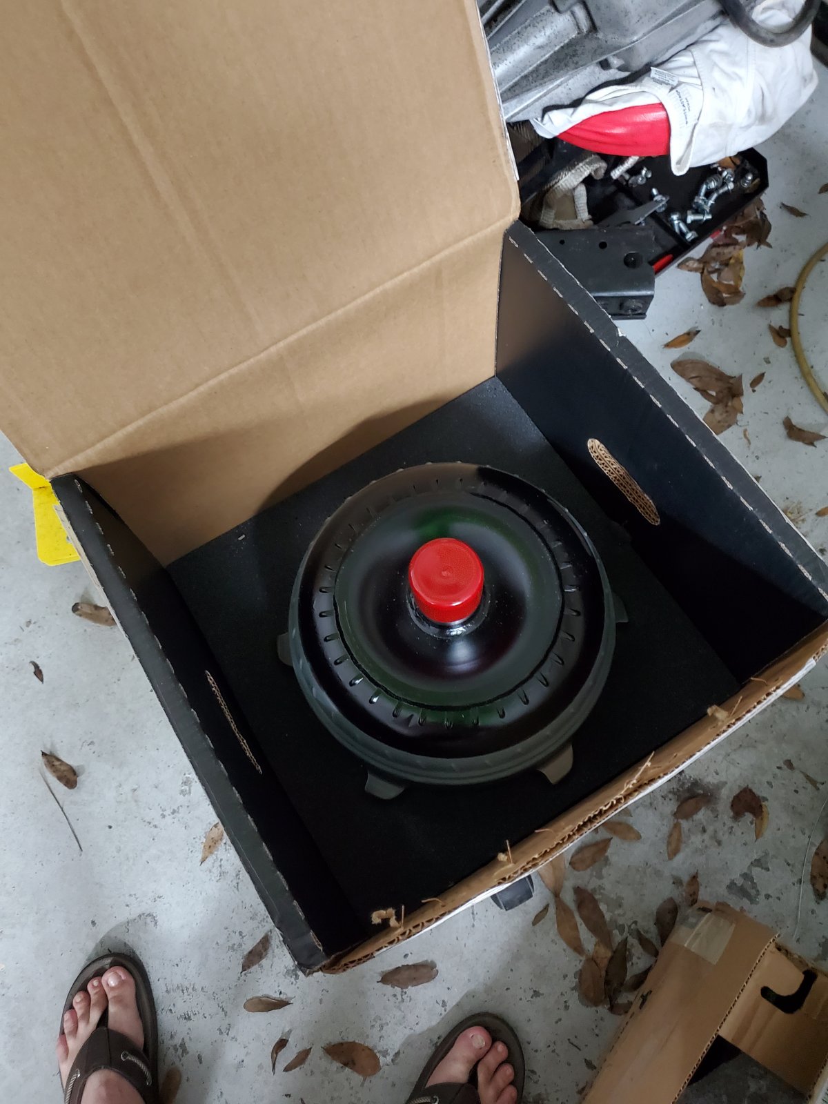

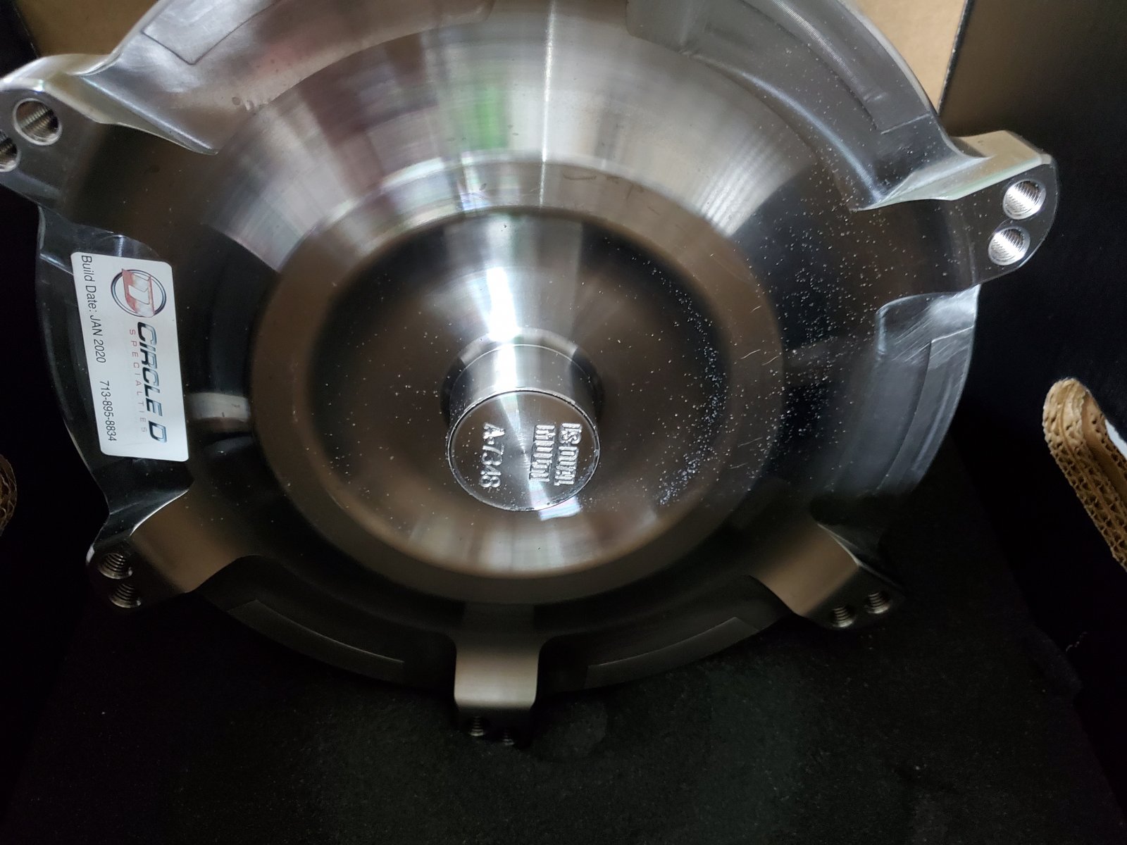

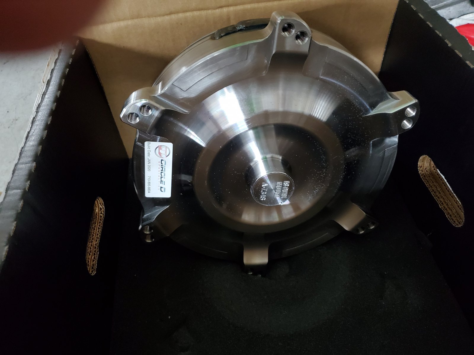

More junk, not broken yet.
Best packaging in the biz.
Got another 4 gallons of dex6, grabbed some of those upf48 oil filters, yall had my worried the pf48e was going to ruin my engine. The wix xp filters I was using would prob work but they're sposed to be for thin syn fluid.
