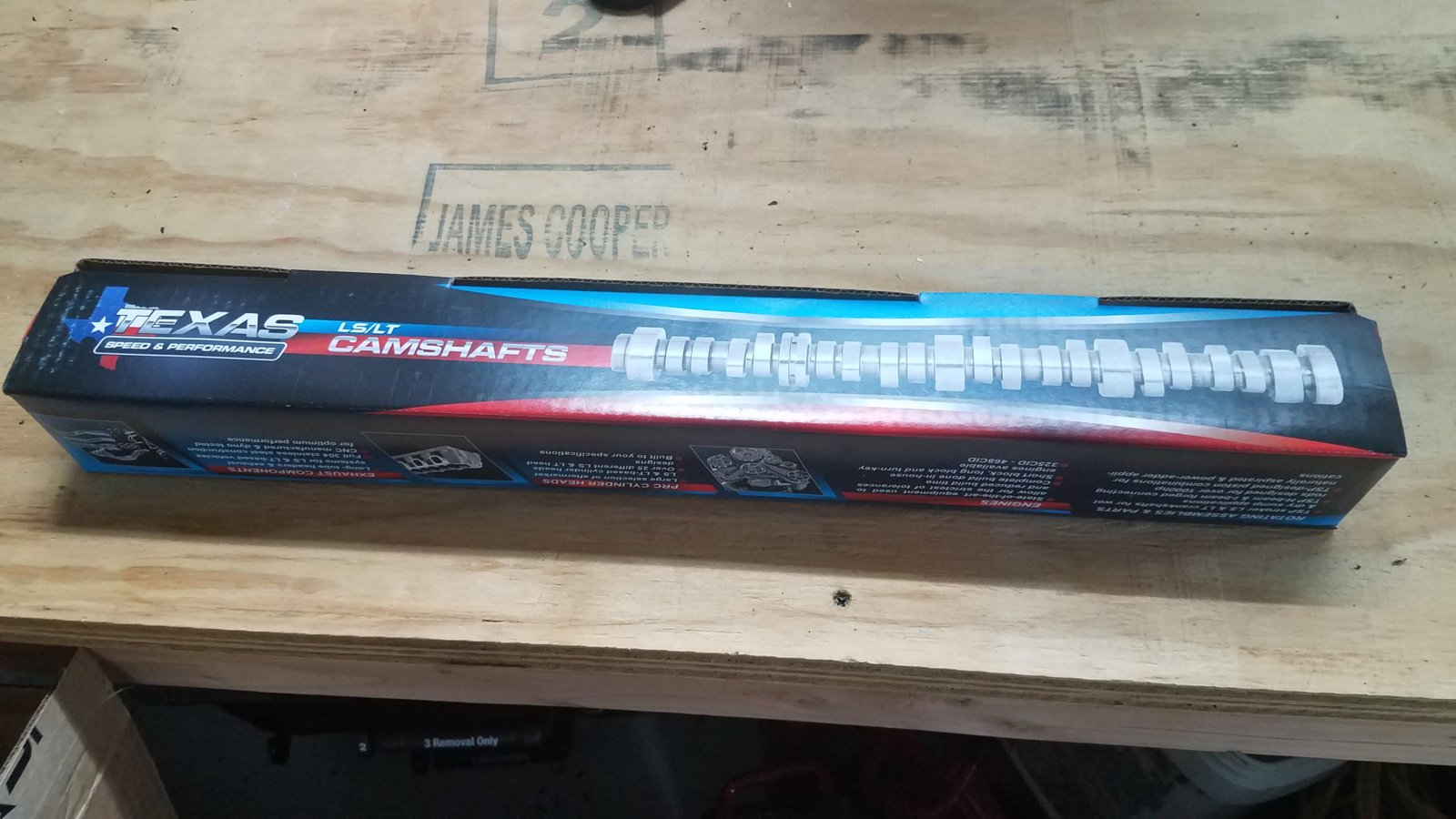

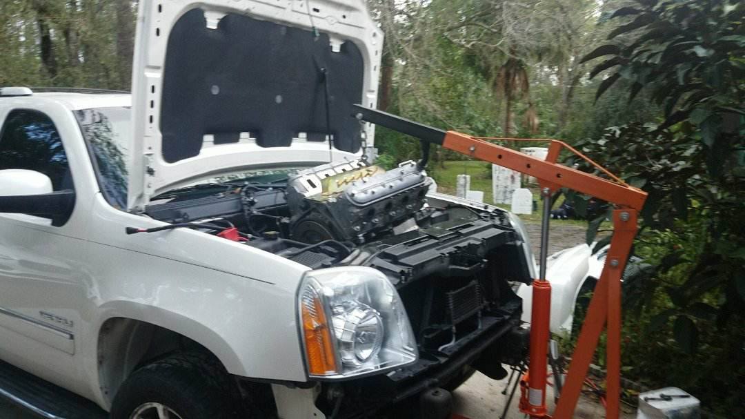

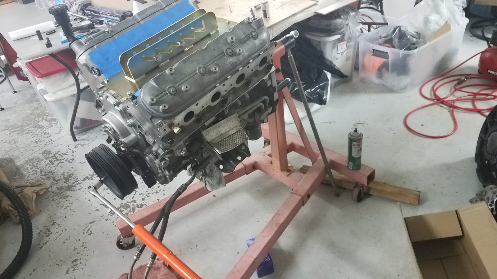

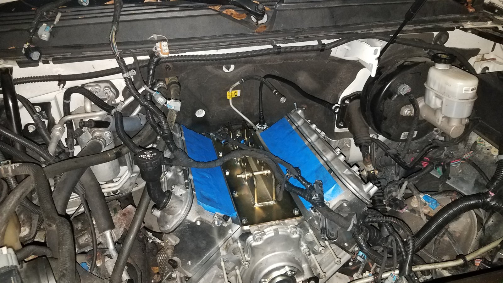

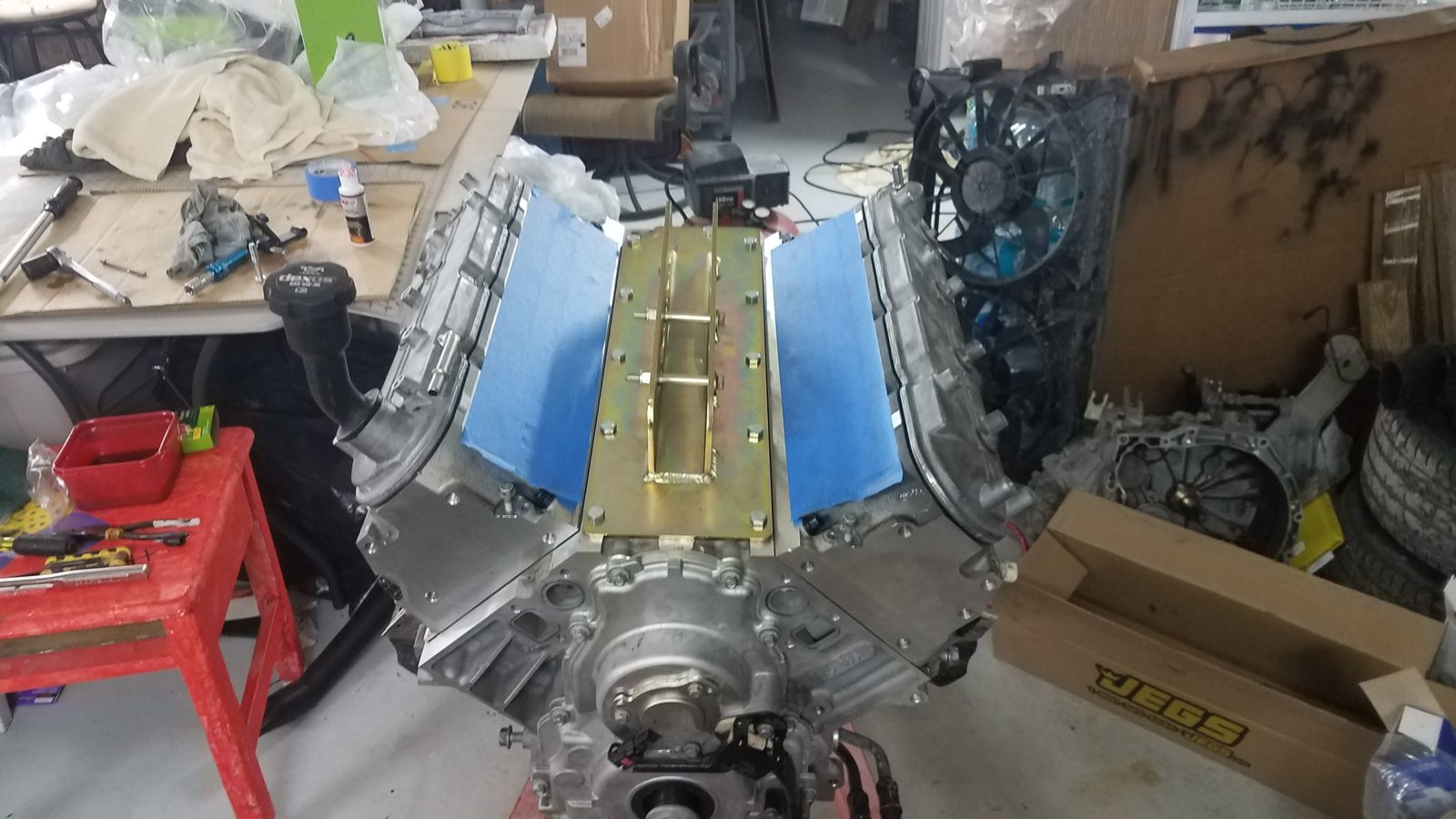

First on the to do list is mechanically delete the DOD, Ive been gathering parts for a few weeks, waiting on a few more things to come in. I ordered a complete kit head/water pump/ exhaust gaskets, lifters/trays, orings, crank bolt, head bolts, etc. It has kind of snowballed however and I now have a cam, springs, lighter intake valves, long tube headers/no cat ypipe, converter coming from circle d, transmission cooler...few other things along the way
I wanted to keep it somewhat subdued as this is still my "family" vehicle. It will keep stock denali catback and for now stay stock height.... new wheels at some point because chrome cladding is peeling off pretty bad on the stockers

Thanks guys! I'm getting anxious myself lately, got a little road trip this weekend to busch gardens with kiddo planned, prob try to get rolling on it next week.

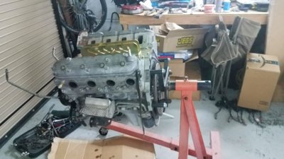

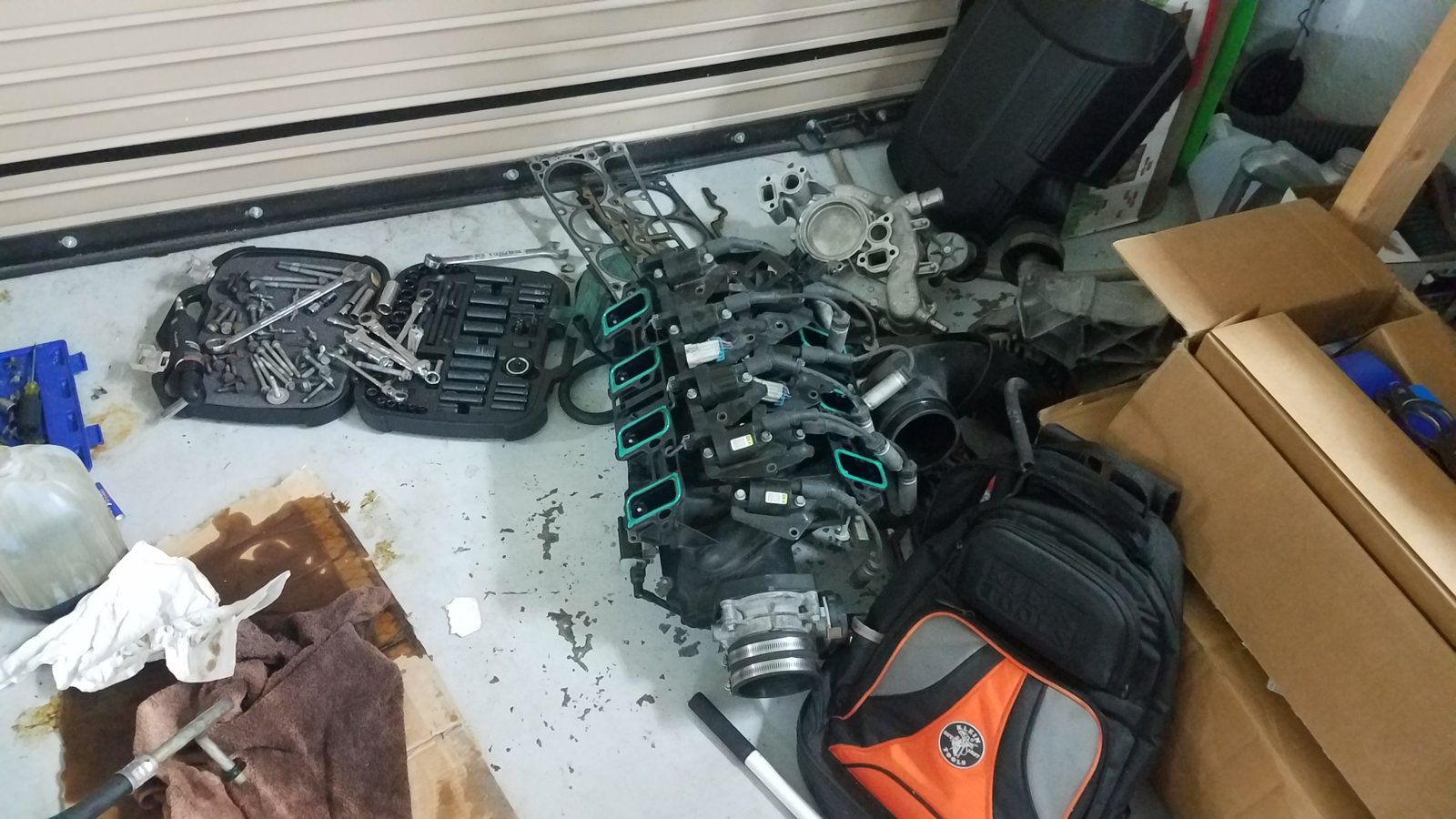

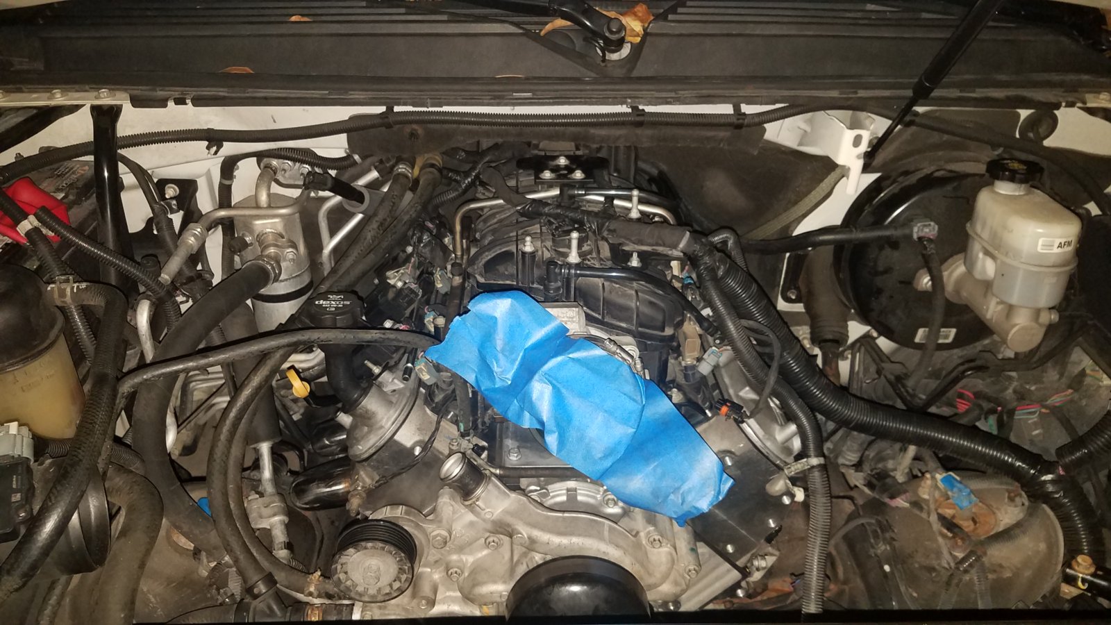

I'm still debating to just pull heads while still in the truck swap everything and get it back together probably be down a couple days, find transmission shop to swap converter, with the awd i figured atleast $500
OR
Pull the whole engine and throw it on a stand to do the cam and top end work myself or find someone to assemble it. If i knew anyone I could trust just to assemble it there wouldnt be any question, but dont really know anyone anymore - most machine shops just want to mill the heads and do a valve job so they know where they're starting at - which i totally get but until i pull the heads i dont think it needs any of that done. I'm hoping i can break the heads down lap in the new intake valves, put in new seals if needed and be done. pulling the engine will also let me swap the converter in at the same time (-$$).
Id need to buy/borrow a few tools if i did everything myself but pretty confident I can get it all done lol

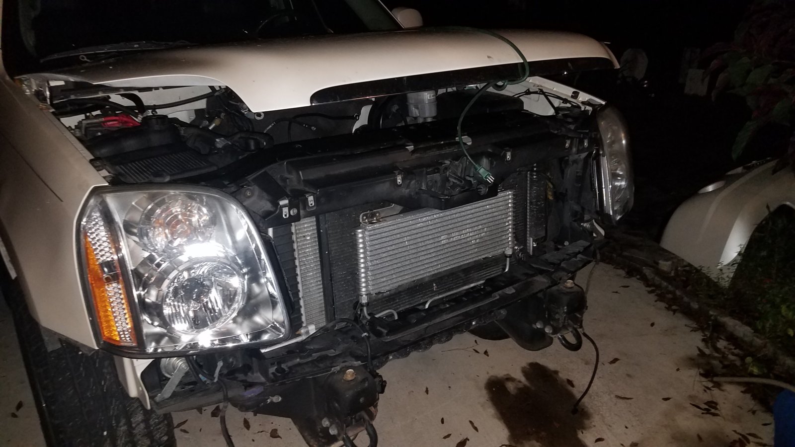

Ordered the trucool 40k mounting brackets from user on pt.net if they get here this week I may go ahead and get it mounted and plumbed in.

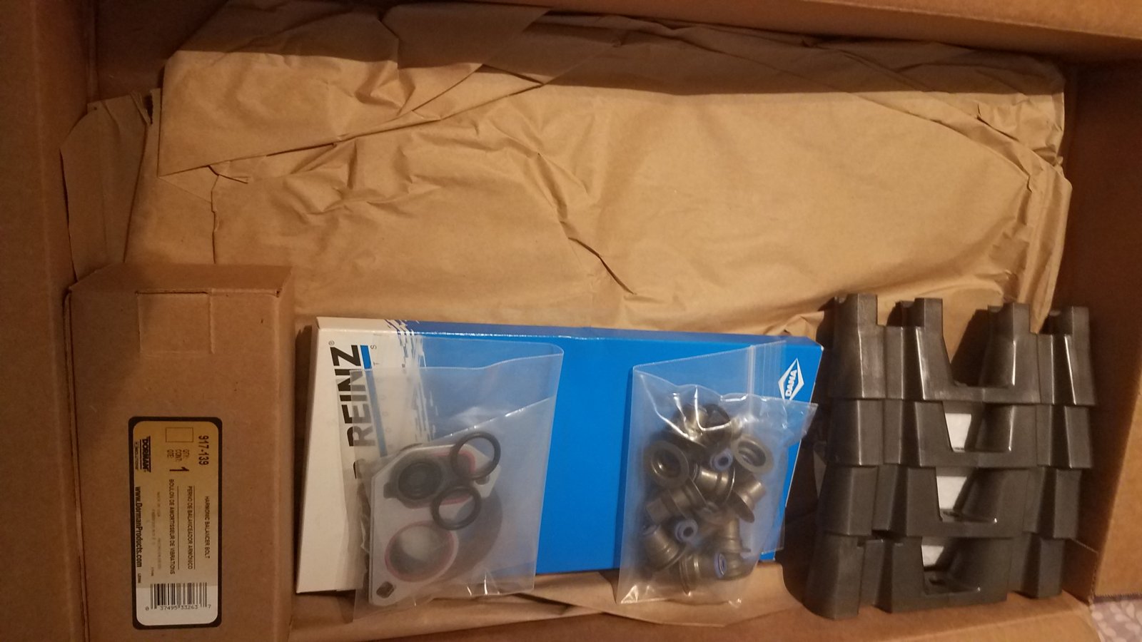

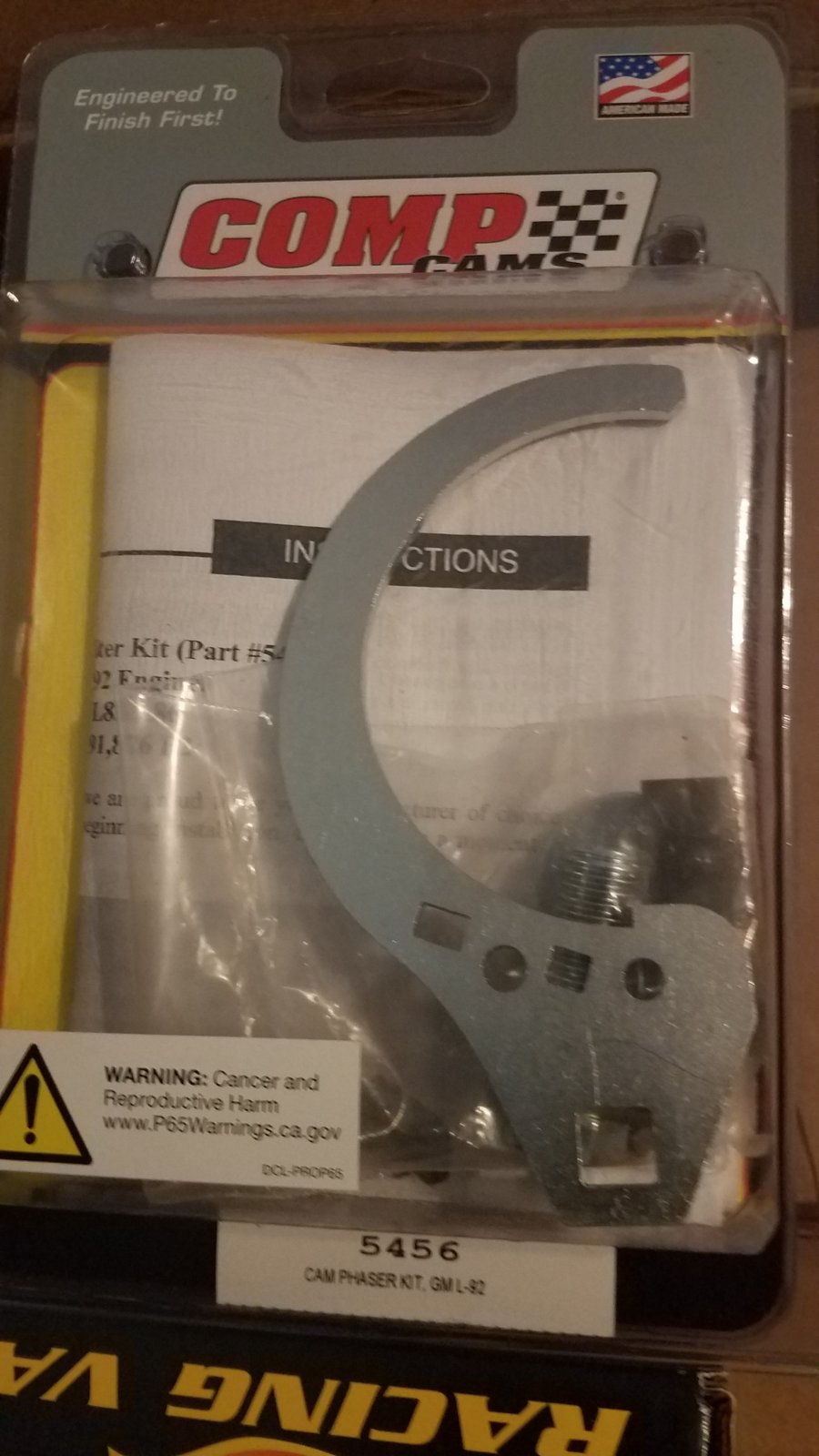

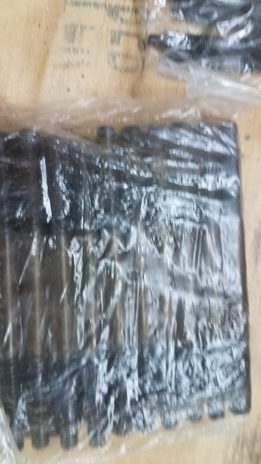

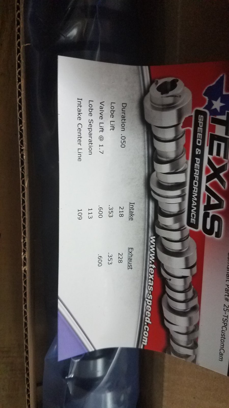

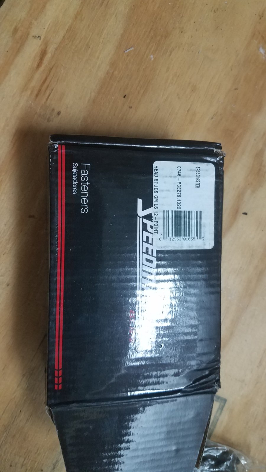

All i have is more pictures, I swear at some point i will start installing all of it!

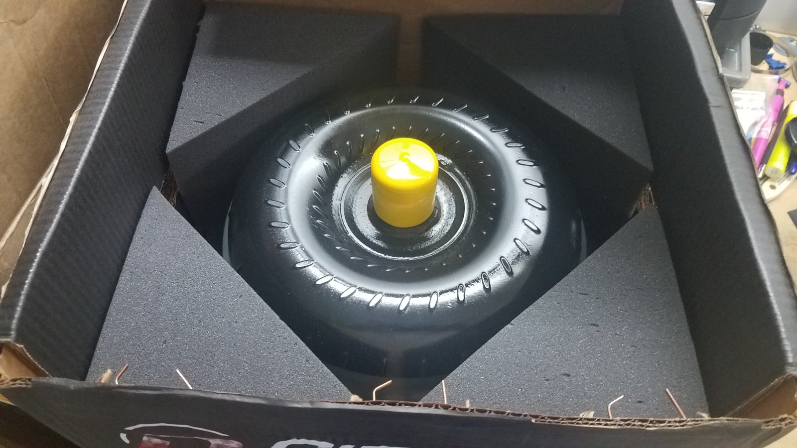

I started out looking at gear swaps and was about to pull the trigger on 4.11s front/rear. With the 6L80 and 3.42s stock i thought it was a pretty good combo but slower than hell off the line. I think i found somewhere comparing the gear ratio it ended up being like driving a 4l60 with 4.56 gear.
I had been to 1/4mile track a few times and 60's were terrible 2.3-.4. i noticed similar trucks, even 5.3s that were cuttin 1.9-2.0s. I didnt realize it but the stock converter on mine only flashes at like 1600 rpm on the foot brake. So hopefully converter will help out, and way less $$ than the gears after install.
Not sure how we are about naming non forum sponsors but they were extremely helpful, responsive, and got it out to me quick. stall should be around 3k rpm
Along with the converter the LS3 intake valves arrived, I went back and forth about installing them for a while. Stock valves are big and weigh in the 110g range,LS3 valve around 90g, plenty of people say dont worry about it put on a good spring and let it roll. But i wanted to keep valvetrain nice and light to see how high Justin wants to tune the shifts :D.
The headgaskets that were sent with the DOD delete kit I dont really like. they look like a metal shim with two crush layers, they swear they've used them in all kinds of builds with no problem but meh...L92/LS3 would be plenty but since thickness is the same I ordered some LS9 gaskets since FI may be in the future.
