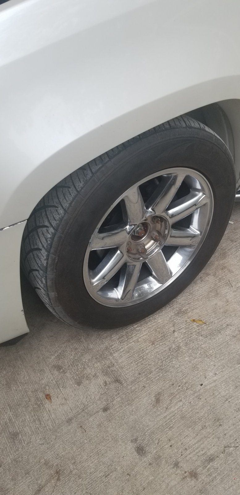

Catastrophic issue on the way to cars and coffee....
Lost my damn lug cover

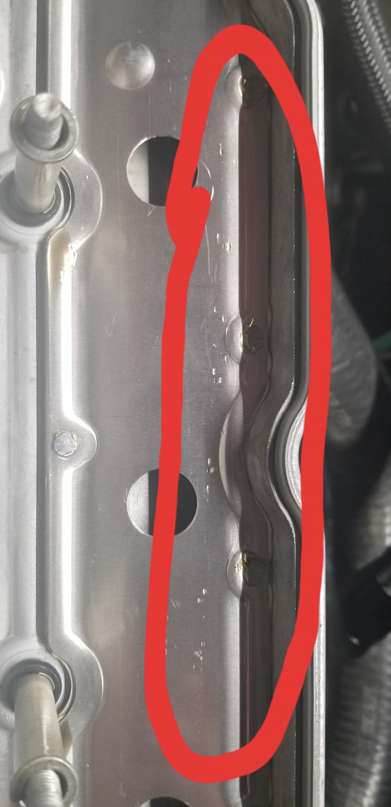

Also have been baffled by some errant knock sensor readings at low rpm or even idle. it would idle along smooth for 5 minutes then knock sensor would pick up some noise and throw in like 8* retard. and you could audibly hear noise, but not like spark knocck and when you shut it off you would hear the same noise for a few minutes afterwards. couldve been lean cyl fire cause of injectors i dont know but that wouldnt explain it doing it after shutting it off. its a lot more noticeable on the passenger side but driverside valve cover is a lot easier to get off so i pulled it and it looks like rockers are hitting the baffles in the valve covers. so hopefully a new pair will get that straightened out

I'm now exhausted after following all of that! Good catch with finding the rocker contact on the baffles. Wouldn't a new pair just be the same? I'd dent the baffles with a straight line, like with a hammer on a wide scraper or chisel, for clearance.
Or, since those were modified, grab some risers?

those would prob work but would bug me lol
a friend of mine has a pair of smooth ones from motion raceworks with 10an bungs already, i would have to relocate the coils for real though which isnt to bad might take an hour or two to make up all the ends and crap but wouldnt have to wait to order anything. he said come by and grab them if they work good if not just bring them back. i was looking at the stock ones they really arent all that low profile with with the cap and everything. just low on the sides where the fill cap is its about as tall
https://www.motionraceworks.com/products/motion-raceworks-gloss-black-valve-covers
also the rockers are hitting the baffle for the pcv not really the valve cover itself, so thats a good idea i could make a little hammer modification or just remove the baffles out all together
