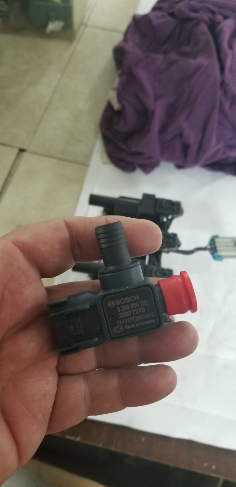

anyone have any idea what this thing wants to see? it is (was) in the vacuum brake booster, swapped to hydroboost last go round . i assumed it just wanted to see vacuum so i hooked it back up to vac source. but last time it was running after driving for about 5 minutes the stabilitrac and abs would error out and disable itself.

no but if you have a tech2 and unplugg it and then run a diagnostic it should at least tell you what it is, or look up the part number on it and try and find out that way. where was it located kind of looks like it might be the fluid level sensor, if it is the fluid level sensor you should be able to just leave it out/unplugged

its the check valve that goes into the vacuum booster itself, hose runs to the back of the intake. I checked it with a multimeter hoping it was just a simple switch to let it know what position the check valve was in but not the case. three pins in it, across one pair of them is like 4800ohms across the other is like 5400ohms with no changes as you manipulate the check valve- i cant imagine it reads pressure like the map sensor as well but who knows. the check valve in it isnt spring loaded or anything it can be sucked/blown into with position (open/close) and stays there. i found a welding rod cap that fits it real tight so i am just going to try and move it to either position and see if it works. will borrow friends scan tool and see what the actual fault im getting the code for also could be unrelated all together

ok, I looked under my hood and I see what you are talking about, no where for it to go on the hydroboost system? I wonder if it needs to be deleted from programming then, what I mean is to re program the bcm so it knows it has hydroboost now, did you get the hydroboost out of another gtm900? or was it a kit of some kind?
***I would try just setting the valve so it thinks it has vacuum, make it stay in that position and try running it that way.

any idea if can you make changes in the BCM with a tech2? or would i need to find a vehicle with the correct options and flash the entire bcm?

you should be able do it with a tech2 and acdelco tds (via computer usb serial adapter/tech2 passthru), but you will need to know the specific rpo codes you want to change. The tdsweb programming is $40 for 2yrs of programming (per vin number) once you create a account and pay the $40 you can program it as many times as you want

Well I guess let me see if having it just capped off accomplishes what I want. Mostly dont like looking at lights on the dash. Dont care about function
I would think as long as it shows having vacuum it would be fine, but gm does weird stuff my 18 Silverado has the active shutters in the Grill and apparently there a pia to circumvent

yep thats what i assumed last time ... i actually used it as a check valve for the pcv system so it would have vac on it. going to try it with no vac source and check valve in either position capped and then vac source with other side capped i guess
