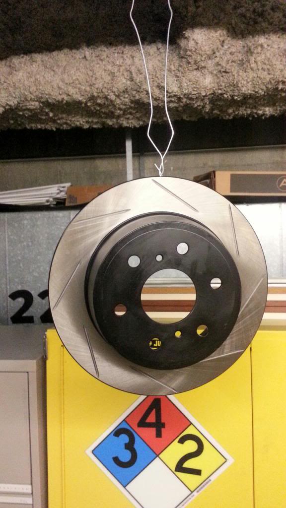

When you get the rotor they come coated but its not all the way to where the pad touches so if you just install them in a few days you will see a rust ring which looks horrible. So what I've been doing is cleaning down the rotors and using Rust-Oleum semi gloss black paint and spraying over the rotors.
So you start with this (you can see coating doesn't go all the way to where the pad touches)

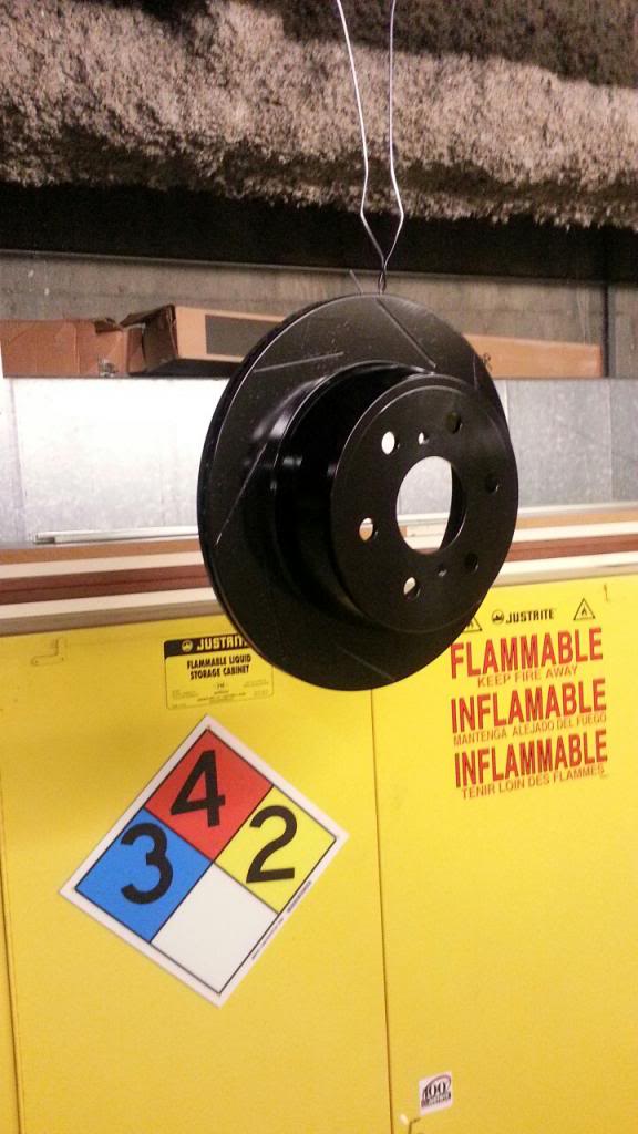

And end up with this
Now when painting the rotor what I do is focus much of the paint on the hub area and the edge right after it meaning the part that doesnt touch where the pads hit on the face on the rotor. I then just do a few squirts on the slots and then on the top edges and inside vaines. This will just keep the rotor free from rust longer giving it a better look especially behind big wheels. I do the same on the backside of the rotor and dont worry if the paint runs on the face of the rotor as soon as you go for a test ride it will wipe the paint away and leave you with a clean surface.

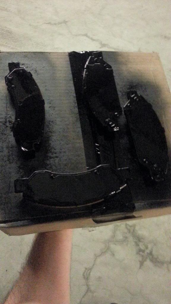

Also dont forget the back plate of the pads

does the veins remain painted when the pads grind off the paint?
Also to clear things up you said just rostoleum paint , did you mean caliper paint or just regular paint ?
I would imagine regular outdoor paint would chip off due to the heat

Rustoleum high Performance Enamel is all ive been using no chipping issues at all or peeling. The veins are on the inside of the rotor the only thing that gets wiped away is the paint on the face of the rotor where the pad touches everything else will stay black.

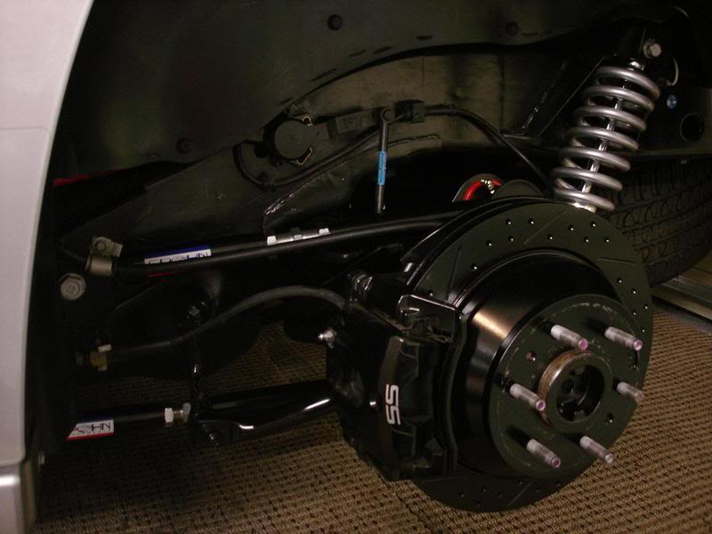

i forgot this is my escalade same thing done. I've had the brakes on for 1 year now im going to prob clean up the rotors next week and spray it black again to make it look new
No rust pretty much all brake dust

You spray the pads too??? :think: That doesn't ruin them??
49,924
15,506
The back plates not the actual surface of the pads
I gotcha. Now the paint that is on the surface of the rotor. How does that affect braking performance?
