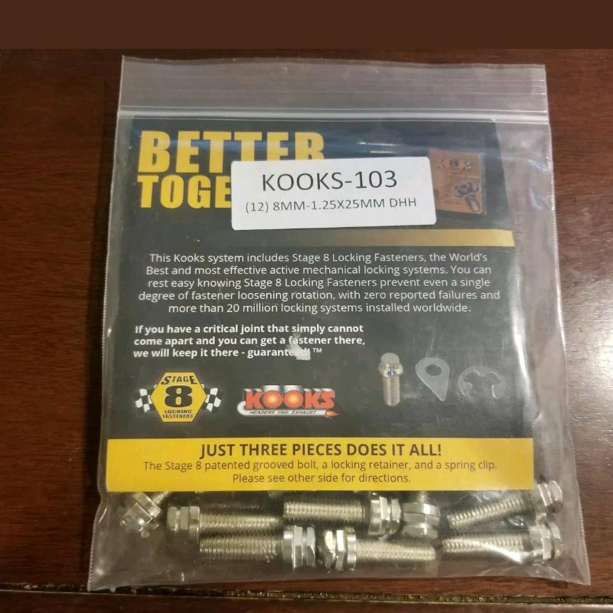

I believe it... when I bought my Stage8 bolts they had a sticker on the bag with a Kooks part number on it.

K, do you happen to have a part # for the stage 8 bolts?
I was considering ARP studs but like the locking feature of the bolts.
Yeah, they are Stage 8 #8900
#8900 Chevrolet LS1, LS2, LS6 Header Bolt Kit - Stage 8
https://www.stage8.com/product/8900-chevrolet-ls1-ls2-ls6-header-bolt-kit/
Mine came in a bag like this...
Found them on Ebay for like $20.
