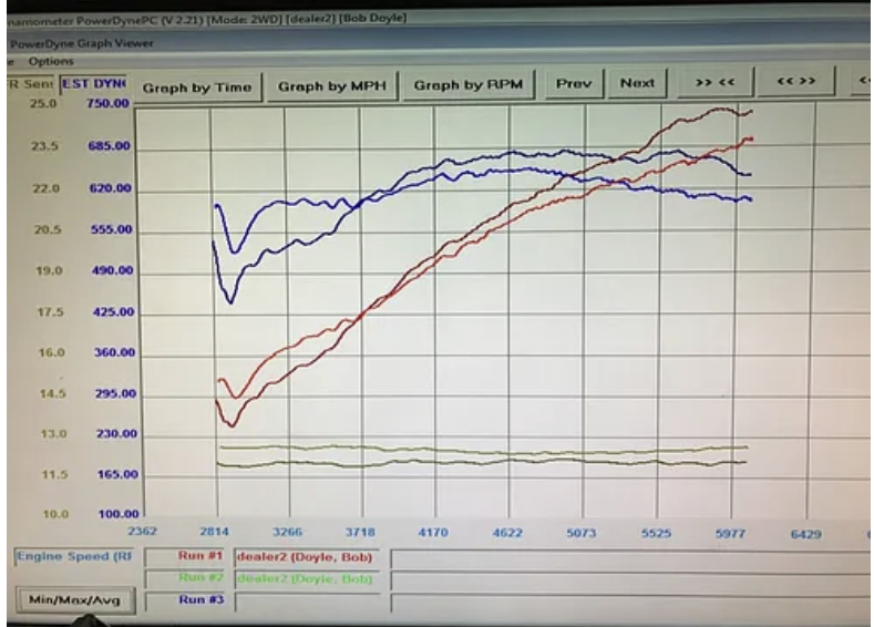

Correct and Exhaust flap is gone....OEM resonator is still in place. Transmission is tuned and running a small converter and cooler. Running a tad over 10lbs of boost putting down 750 on a mustang Dyno. Honestly I could care less at this point to loose a few HP to have it quieter. It’s hella fun to drive and the shock on people’s faces is priceless. But I have other big HP toys so this one doesn’t have to be so extreme for daily duty I’m sure it will still be fun with a little less I just don’t want it feeling like it’s choking to death.
