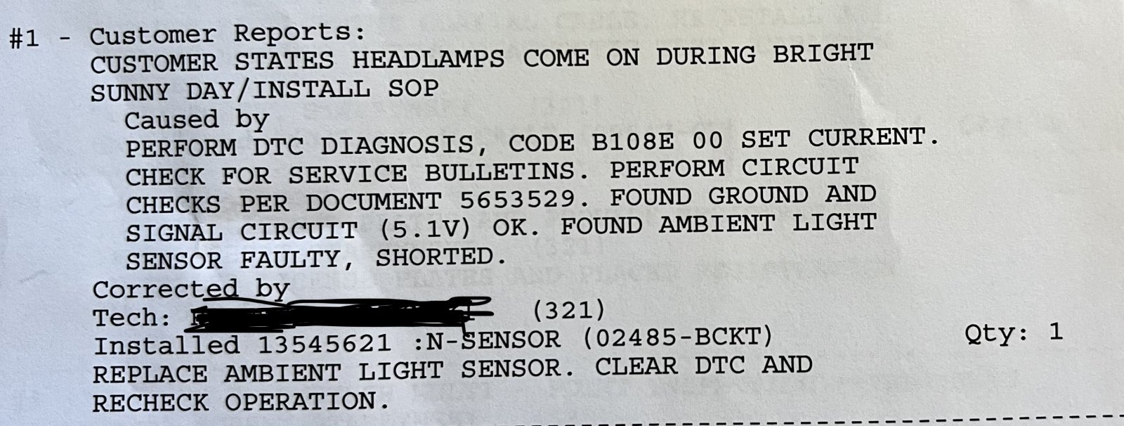

I had the same issue (headlights coming on in my Denali in bright sunlight). Dealer found an error code, replaced the light sensor and now everything is working as it should. DRLs during day time, headlamps come on when it gets darker. I attached the service report here in case helpful.
