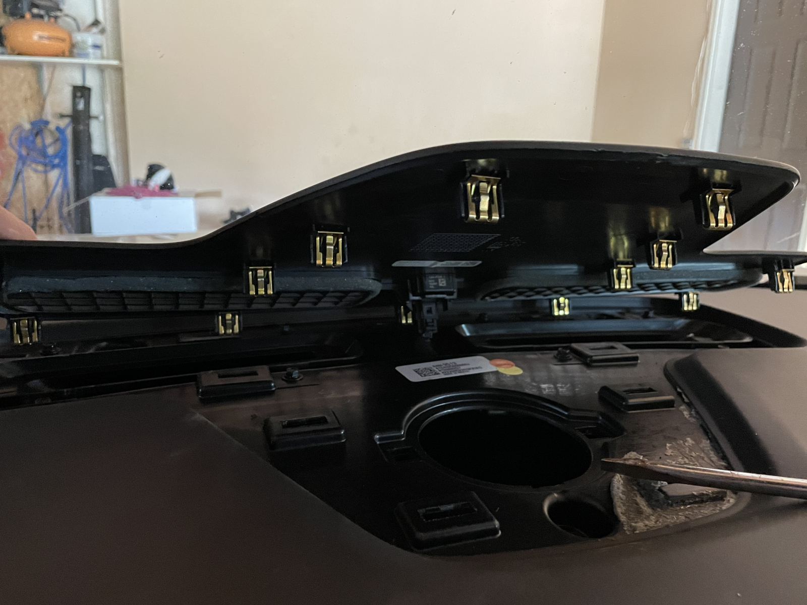

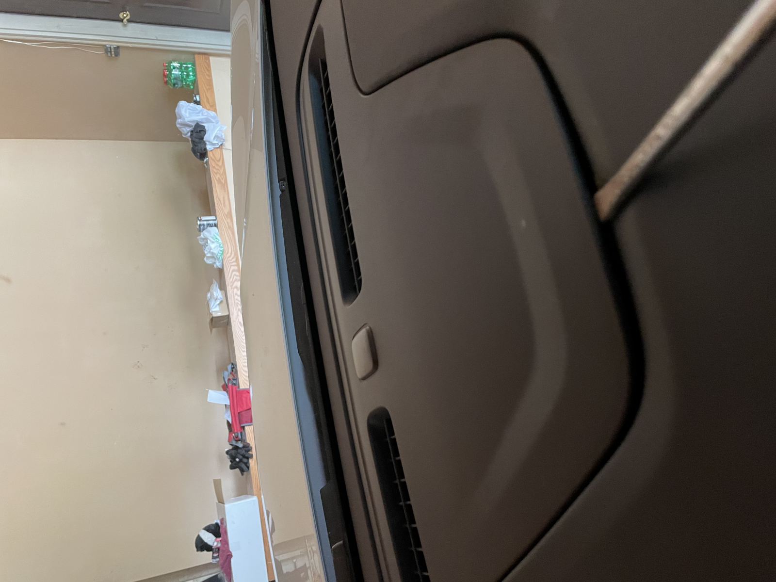

Just replaced my sensor in less then 5 mins and it fixed the problem.
Take a screw driver or something flat to pry up gently on the panel. Once you pull panel up remove the bad sensor. There are a couple of plastic clips. Just push them in. Replace the sensor and push the panel back in the clips.
I am not a certified GM Technician and it was easy to do. Do at own risk.

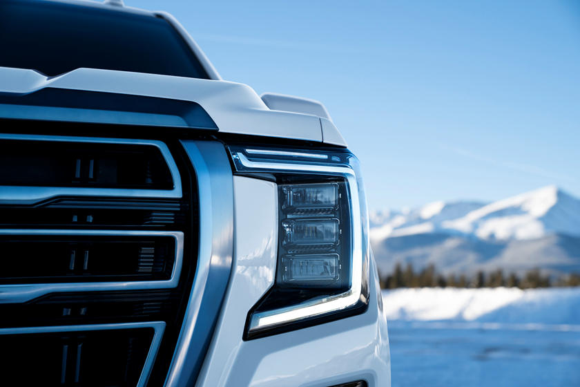

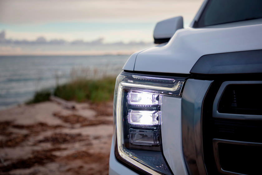

Sorry for this stupid question but please confirm my understanding. I think my low beam headlights are also incorrectly on during bright sunlight (switch is set to Auto). A short phone call and description to my local service dept said they are functioning as they are supposed to. I don't think he is correct.
To avoid descriptive errors on my part, here are a couple example pictures to illustrate...
What my headlights look like in bright sunlight:
What I believe my headlights (DRLs) are SUPPOSED to look like in bright sunlight:
Sensor is bad. Needs to be replaced. You are correct on what it is supposed to look like.
