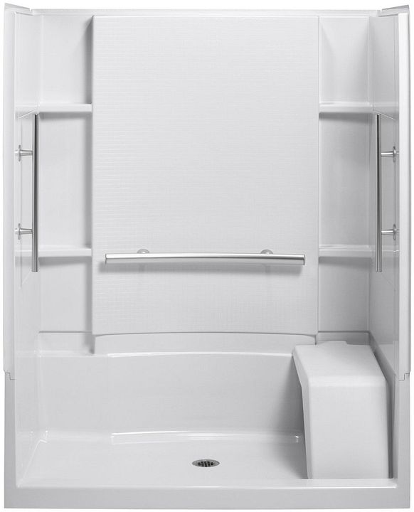

If mold is a concern, stay with what works for you. We hated every tile shower we ever had, they look great but are less than ideal to keep clean. There are decent fiberglass models available, we went with this as another tile shower just wasn't going to work for us any more. Getting up in years, this model made the most sense for us, there are much nicer ones than this, but this was old person friendly, the glass doors were hard to clean before the water softener, now they are fairly easy.

Thank you for more real world feedback. I really appreciate your input!
Some hotels we've stayed in have solid surface, tile "looking" finishes in the shower. While not a huge fan of the feel, they look like real tile.

Maybe I've just been lucky.. we have tile in all of our showers, granted a very thin grout line. I dont think I've ever seen mold grow in the grout lines. I don't even clean the showers. I have a cleaning lady come every other week who does. Even with that, I dont see build up.
The only thing I despise about those shower inserts is the sounds they make over time. Seems like they get loose over time and make cracks and whatnot when you step in. Or maybe it's just because I'm a larger fella.

i pull out a lot of fiberglass tubs that have no solid base under them. That’s the most important step of installing a fiberglass tub. That’s why they make sounds after a while.

My house has a fiberglass insert and it's solid. I think a lot of people don't install them correctly. I've noticed what you're describing it hotels.

It is important to bed fiberglass tubs/inserts in either mortar or plaster. I used plaster for the upstairs tub and mortar for the Master and Casita. It feels like concrete when you step in, no hollow sound. The side walls do have a more hollow sound but you rarely touch them so it is no biggie to me.
