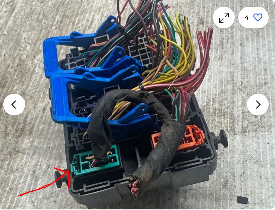

*I started investigating and first figured the clicking was comin from the Cabin Fuse Relay Junction Box (Or power distribution module). Figured it was just not grounding properly or a bad internal relay, so I replaced the junction box completely. and that took the clicking away, and it seemed to run fine, except all the ABS errors were there, and the parking brake light was on and all that stuff, but it drove fine. I plugged into the OBD reader, and had 0 connection with the ABS module.....So I rechecked my junction box, and realized that I had forgotten to plug in a plug in the back of the distribution module. Plugged it in...and BOOM, issues all back like they originally were!
*Plugged in my code reader to see what changed, and it will connect to the ABS module, then when the power glitch happens, disconnect, and repeat.

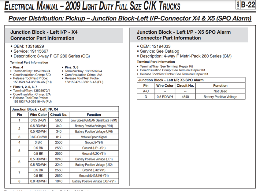

*I got an electrical manual to figure out just what that 7 wire plug did to cause so many issues. The plug in question is X3 on this image I'm attaching a pin-out and a picture of what it looks like (green plug). it has a few grounds, some data connections and a speed sensor wire.
*I'm not 100% sure that the ABS module that has actually gone bad (I'm sure its $1500+ to replace). But I could be wrong. It could be a lose ground, but who knows...
*I also cleaned all the chassis grounds (2 behind front tires, rear chassis, ground stud under the windshield dash)
*Checked the main ground cable block and chassis connections
*Checked the ground strap from the block to the frame
Does ANYONE know what this specific plug grounds or controls?

Sounds like water / moisture intrusion in the fuse box under the hood. Start with inspection of all the fuses and relays in the under hood box.
Is that doesn’t help undo the bolts, being alert to check if loose, and verify if the back of the fuse / relay board is corrosion free.
