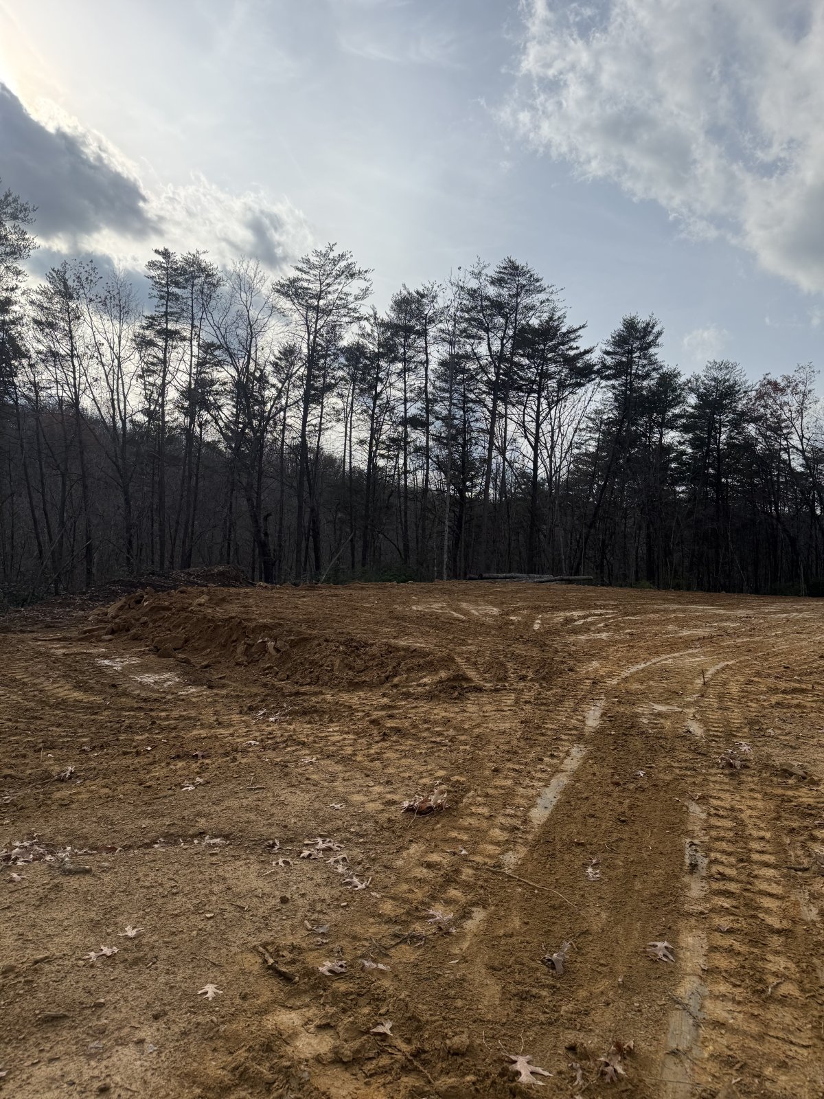

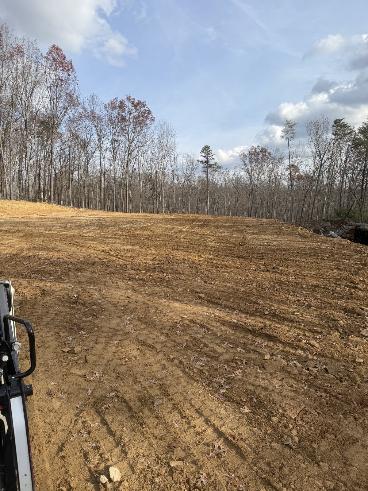

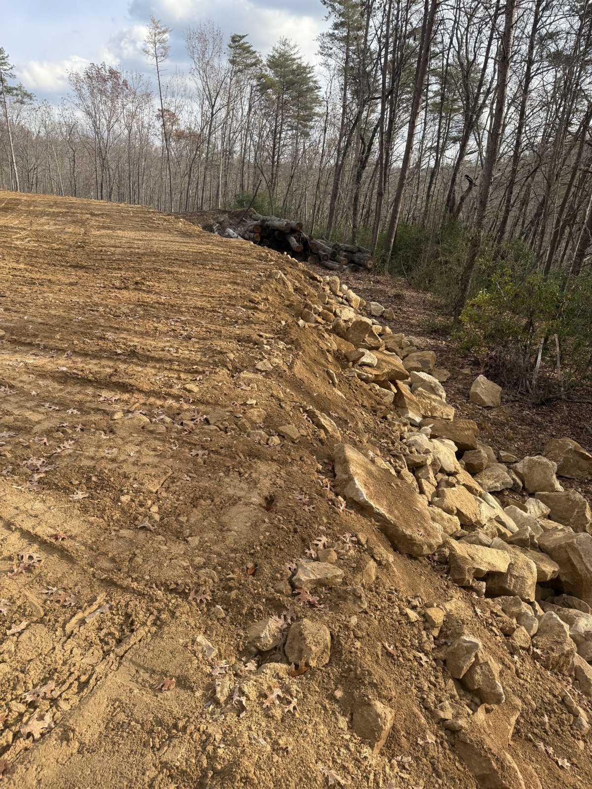

Dirt is moved. Grading guy sent these earlier today. Rain is coming in tonight through tomorrow. If it's not a mud hole out there on Friday, I'm going to meet him after work and rough stake the shop pad. The area closest to the house is going to have to be blended. Not real happy with the looks of it currently. Once the shop pad is staked, we can decide to blend back or fill in with the massive pile of waste dirt I have.
That back side of the slope will also make use of said waste dirt to cover the remaining rocks and slope it better. Then we get some grass growing.
He said we gained around 15' the full length of that pad, which is roughly 150' long if I had to guess. Lots of dirt seemly disappeared for that little bit of gain. I'm happy
