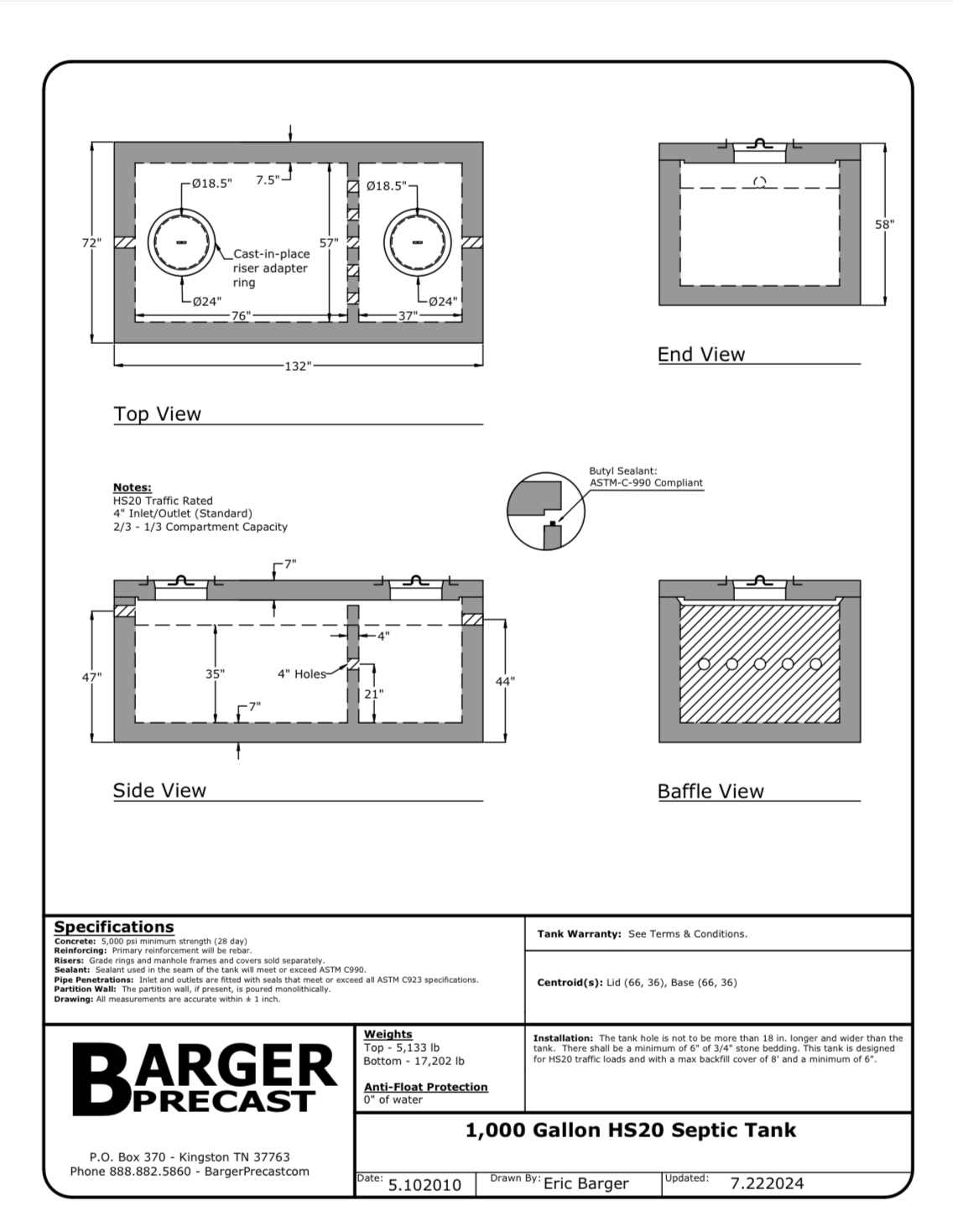

If all goes well with the soil scientist, this will be the tank I install. It's traffic rated so anything you can legally drive on the interstate can drive over it. This is generally only used in commercial settings. It will have a cast iron frame and cover.
I've submitted this to the state for approval. Residential rules are different from commercial so hopefully they approve.

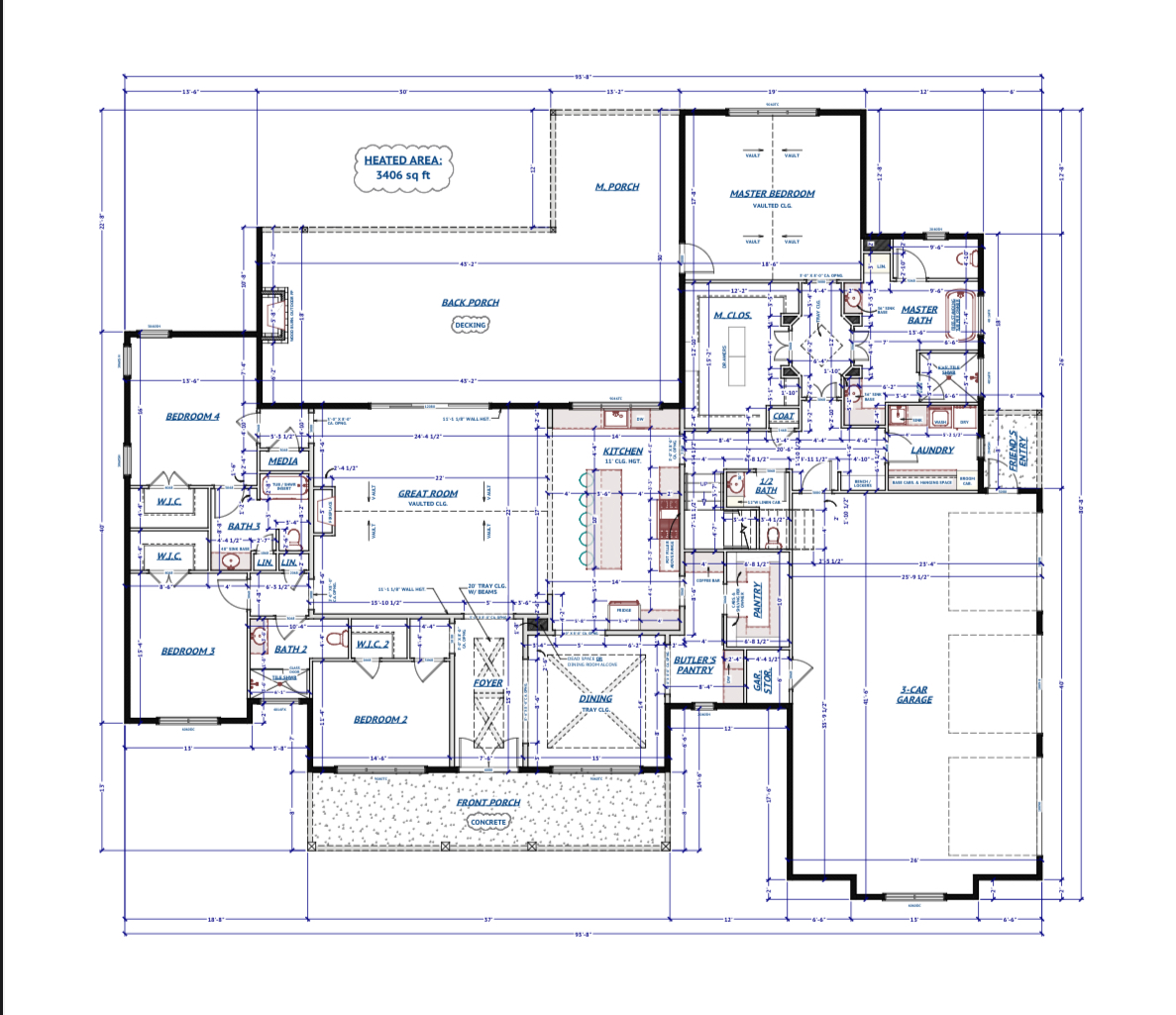

Well boys, I got the all clear from the soil guys. I have to submit their findings to the state and then get the final permit.
I also go the first draft of the floor plan. She's still working on the garage.
I can already see a lot of mark-ups are coming. We requested 8' doors and that was completely missed. The island is way too narrow. The list goes on.
What's your thoughts on the bathroom configurations? Those were the basic changes from the original plan.
Just in case the pdf doesn't work, here's a screen shot. The front bedroom will be my office. I want a closet in there though.
