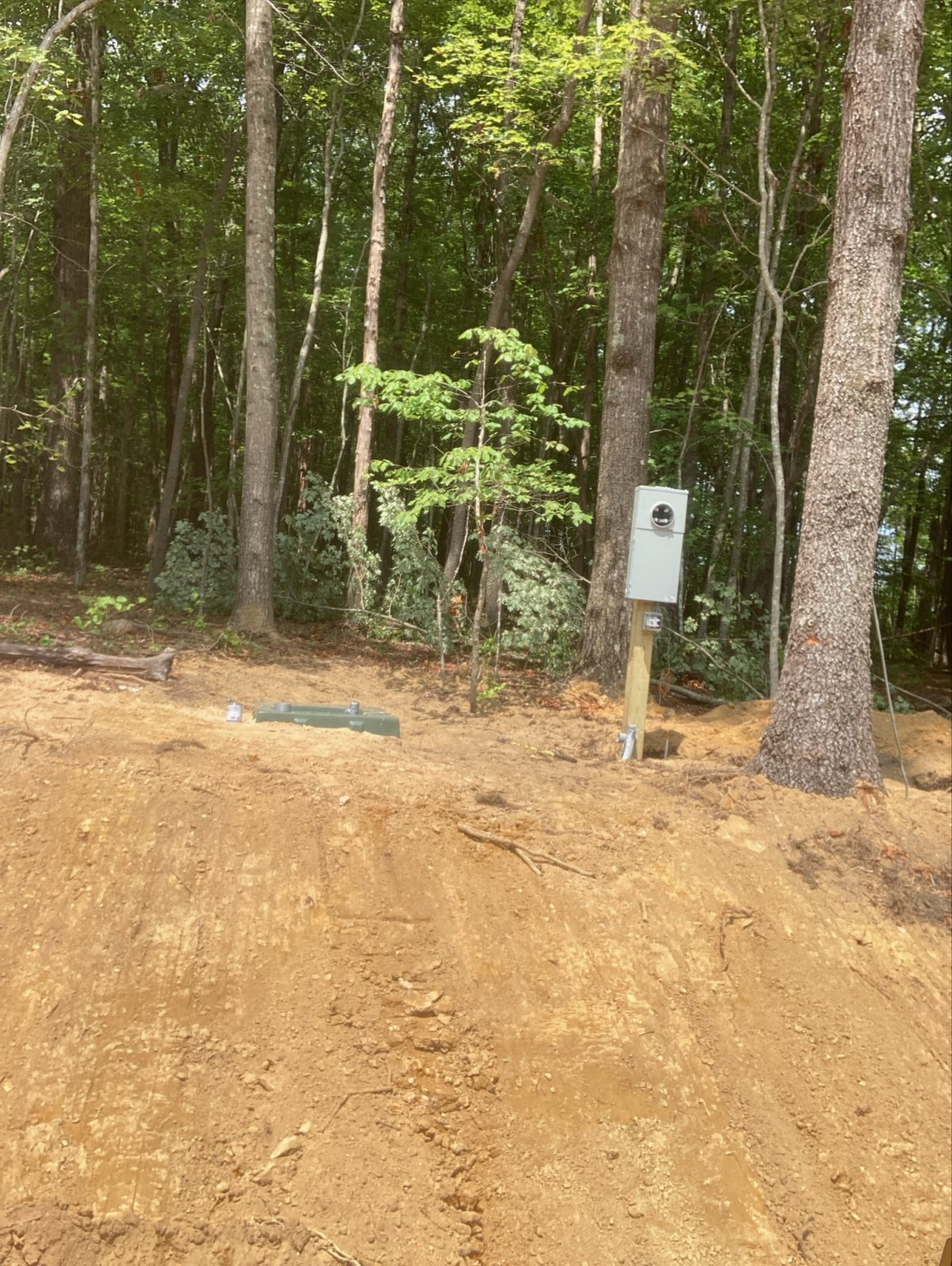

Just got off the phone with my excavation guy. We passed inspection to allow back fill. Once that's done, they come inspect again, then I'll get the stamp to have service connected. I'll have Steph go pay that fee when she's off on Friday so we have no delay.
One step closer fellas

Damn, that's gotta be inspected too?
Yeah, they have to verify grounding all that. I bought the assembly so I know it's up to code. Luckily my guy is an electrical contractor so he can get the inspection done under his license. In this instance, it's just another permit I have to buy, but that's how it goes.
I'm sure a lot of people build their own service assembly and don't know the rules. I didn't wanna learn the rules so I just had the supply house build me one. I think it was like $900. Easy peasy

Is this the first thing erected on your property, besides you?
Meh. I forgot the wall came first

$200 hook up fee paid for electric, just waiting on the inspector to sign off on it.

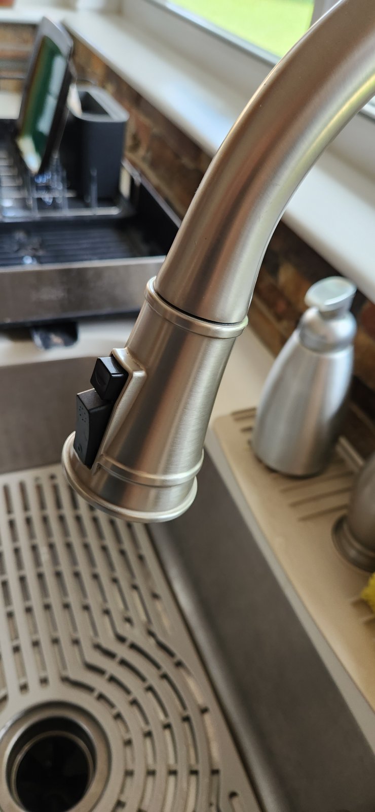

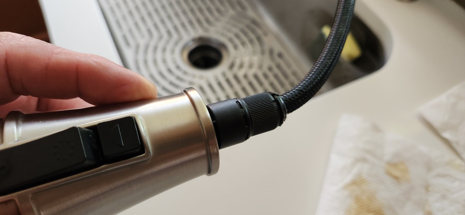

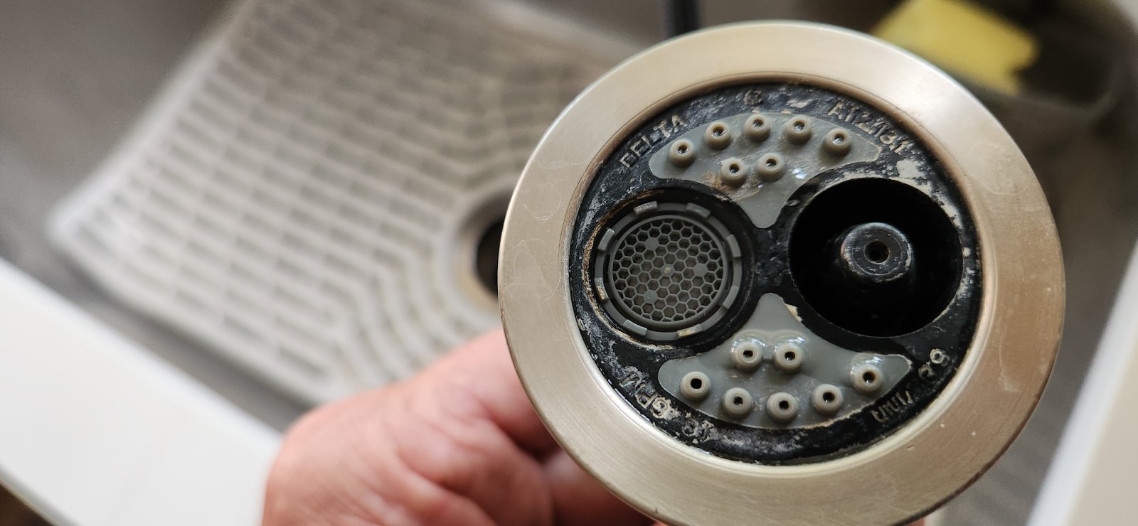

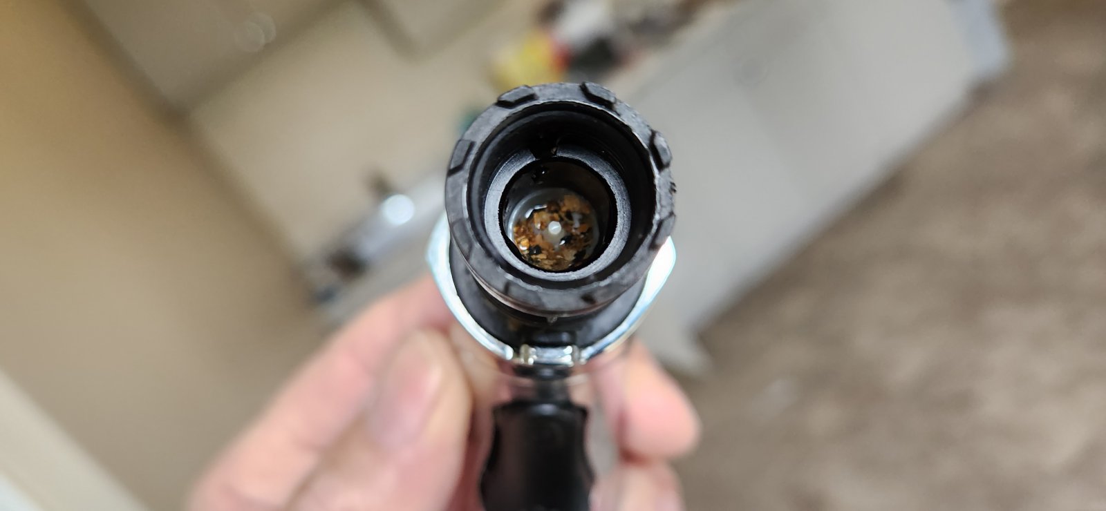

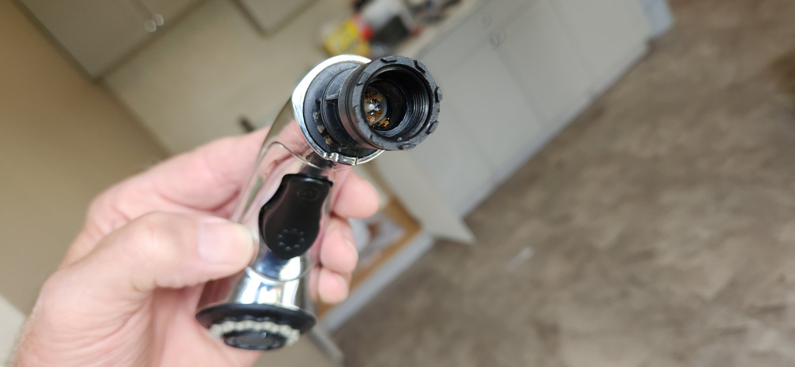

About water pressure….. I DISCOVERED a hidden filter….. Not ever shown in any parts/assembly directions….
I had very low water pressure from a good ‘pull-out’ faucet……. Absolutely no evidence I could find to cause it….
Guess what….. There is a ‘hidden’ fine-filter, INSIDE the pull-out hose, connector, BEFORE THE FAUCET.
Everyone knows about the filter, you can un-screw & clean, at the spray tip. ( LAST PHOTO)
But, I had no idea, there is a “pre-filter” before that one!! INSIDE THE HOSE CONNECTOR-TO FAUCET.
Using a needle nose, .. pull it out,…and clean….
