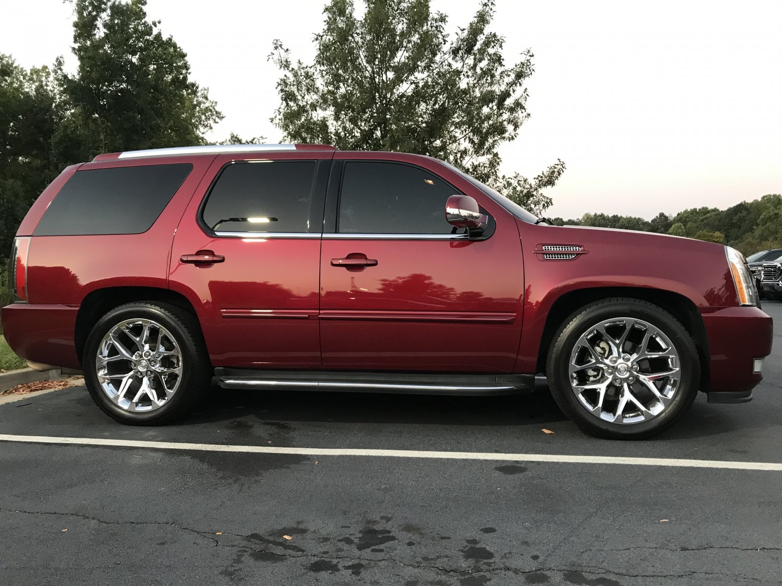

First off- you need to invest in metric sockets. Everything is metric on these rigs. Yes, SAE might be "close enough" to work, but that may be why that 13/16" is stuck.
The bump stops are there so the axle doesn't hit the frame, as in, metal-on-metal. With the FTM performed, you should have plenty of suspension travel to cover most any normal driving and hauling duties. Really, the panhard bar mount on the axle would hit the cross member before the axle hits the frame. If your springs are too soft, then you may have a problem. But, this can be remedied by different springs or load bags. I have a 4.5" rear drop using Jeep Wrangler springs. They're a touch on the soft side, but just a touch- not land yacht soft. For load capacity, I have AirLift air springs ("load bags") that I add air to as needed. I recently took the fam (two girls, so LOADED cargo hold) to Tampa, Florida and towed an electric golf cart back. With 10psi in the bags, it was a little cushy, but not unstable or uncontrolled at all and sat level. I could've put as much as 35psi in the bags. The rear shocks I'm running are Bilstein for a Jeep Cherokee because they were the exact length I needed for my drop and I had them on a shelf. They work great.
I also rolled my rear fender lips and have an adjustable panhard to center the rear. I'd say that a 3" drop is probably about the most one could possibly go on a stock panhard. At or beyond that, the axle is too far off center and the tires will hit the fender on one side and rub the inner fender liner on the other.
