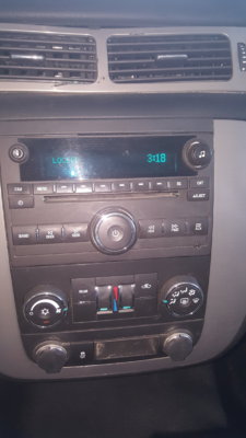

Got my notification by mail also, took in today and surprise...they are going to do the job on Monday was going to get my radio unlocked also, until I was told it was going to be around 70 bucks 20170901_111230.jpg

yeah they are pricey. Dash vents have a little damage, going to look over them over the weekend. Talked to a friend about the radio and got lucky with one pioneer aftermarket that he took off his Avalanche when he sold it.
