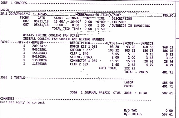

I guess I could be reading it wrong, but it looks like they replaced the following parts in 2018 as part of the recall:
  • 20903477 - Motor Kit
  • 84302501 - Shroud
  • 15698443 - Clip
  • 84220391 - Sleeve
  • 13580874 - Connector
  • 11549388 - Clip
So if I look up those part numbers, I guess maybe they didnt replace the whole fan, just the motors?
  • 84302501 - Shroud
  • 15698443 - Clip
  • 84220391 - Sleeve
  • 11549388 - Clip
looks like they replaced the whole fan assembly and the connector in that case, generally the shroud, fans and motors are sold separate, that's why the extended price on the motors is 2x, why they added $80 to the shroud cost I don't know dealer markup I guess.

Yeah, I guess my frustration comes from all of these replaced parts burning out in under 3 years and about 35k miles

I would check the part numbers maybe they installed faulty parts (aka recalled parts)... after recalls they revise the part number
