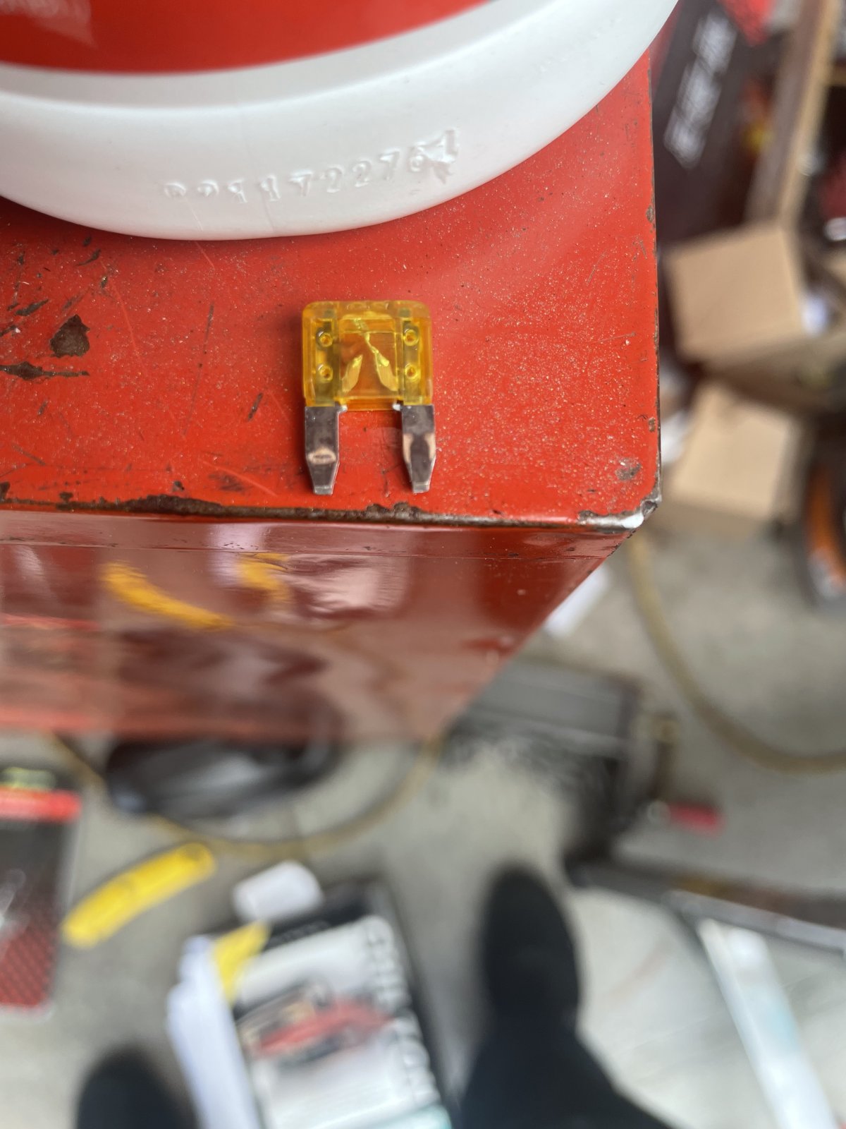

I finally had some time today to look things over and found the pictures fuse blown that was in the ENG-I slot 20amp. I checked the timing and it appears correct now as it turns over without sputtering and coughing. Still no start. I have rechecked the previously blown fuse and it’s not blowing now. I’m going to check for spark now. Maybe the coil is bad? I don’t have a clear procedure for checking the coil for resistance. is there a way to check the cap? Maybe the new cap got overloaded? for resistance. Does anyone have that? The reason I ask about the cap check is because after I cleaned the corrosion off of the old one it wouldn’t work so I replaced it fired right up. Thank you

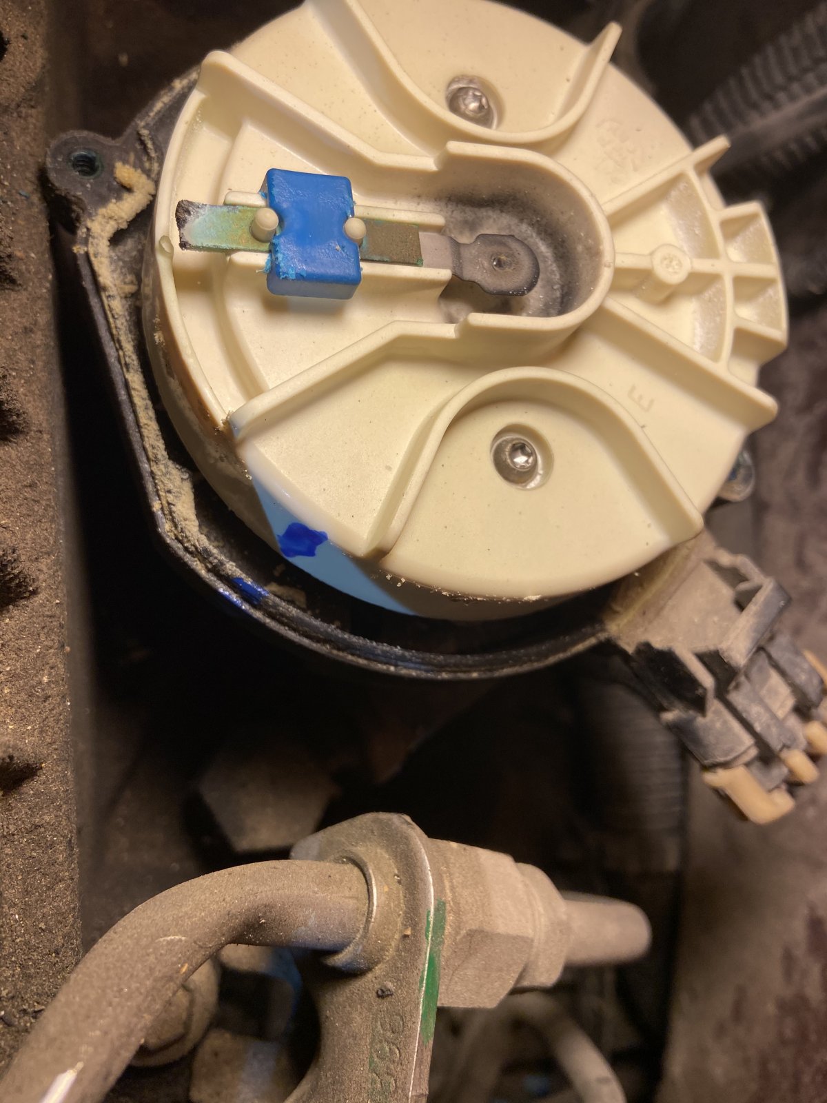

If you moved the whole distributor up a tooth (you wouldn’t be the first to accidentally do that) then I’d try to put it back to the previous tooth and first position that matches your original marks. Then twist it until the tab hits the intake, tighten down the clamp and try to start it.
Here’s a worn out one at zero degrees, note that the tab nearly hits the upper intake:

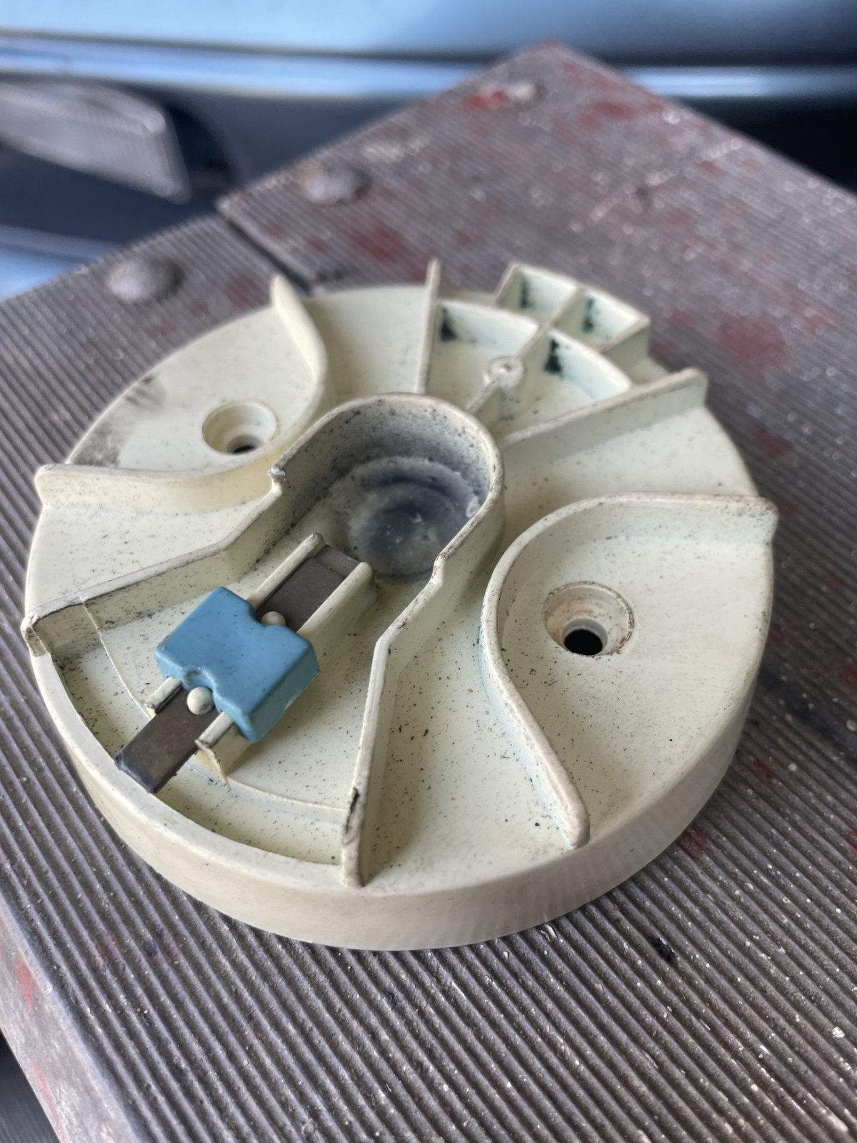

That picture is exactly what I needed to see, thank you. I was working on the Yukon today moved the distributor back to it’s original position (1 tooth) i have the cap on there just like it’s pictured, and it started but it’s still not right. I’m getting a misfire code along with maf codes. I’ve changed 3 things so far: eng-i fuse, coil and cps. Someone mentioned that it must be ac delco but i have a master pro. Could this possibly be the problem? The engine sounds like i need more advance but it’s pegged for advance (counter clockwise) and that’s why i was trying to get creative by moving it one tooth over. When i retard the timing it won’t start. My read out tool doesn’t tell me what the timing is. I have to borrow a neighbor’s sensor to see where it’s at but i can tell it’s off. This is a picture of my old rotor that must have caused the corrosion mentioned before under the cap.
I’m stumped…thoughts?

By the way this was not an ac delco part the middle fried off and was laying in the distributor. Sounds like I’m answering my own question regarding ac delco versus cheaper doesn’t it I could change the cps back to the original one that was in there or get an AC delco cam position sensor and see if that does anything. My only issue with that is the timing is still wrong.
