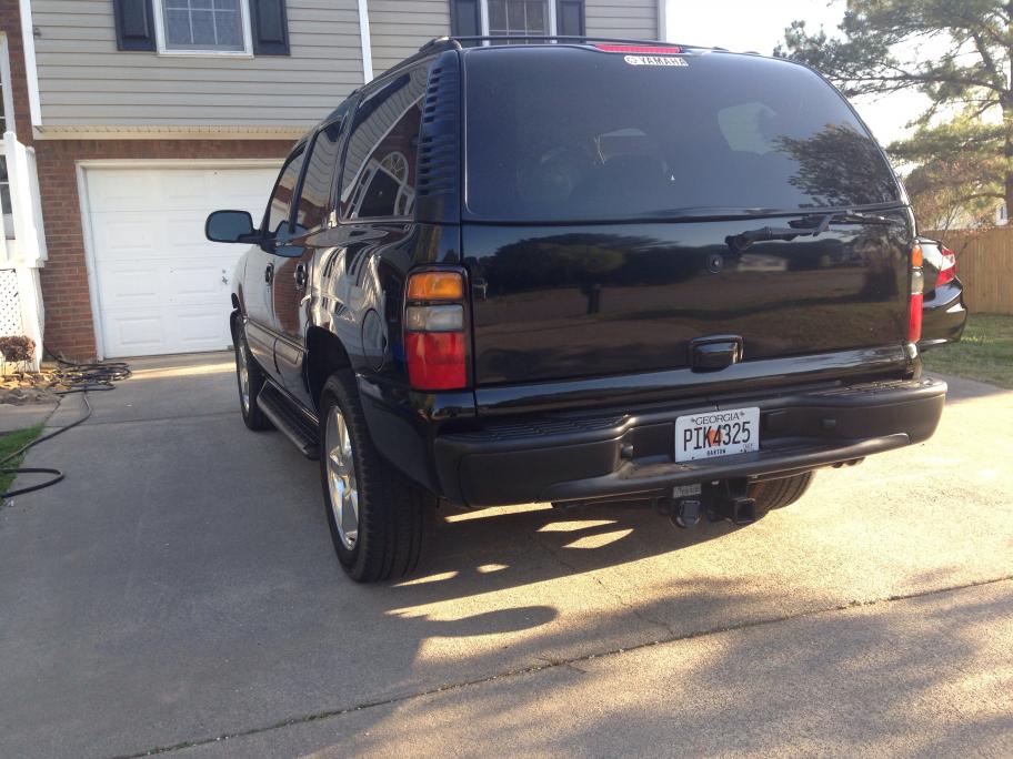

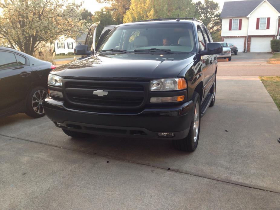

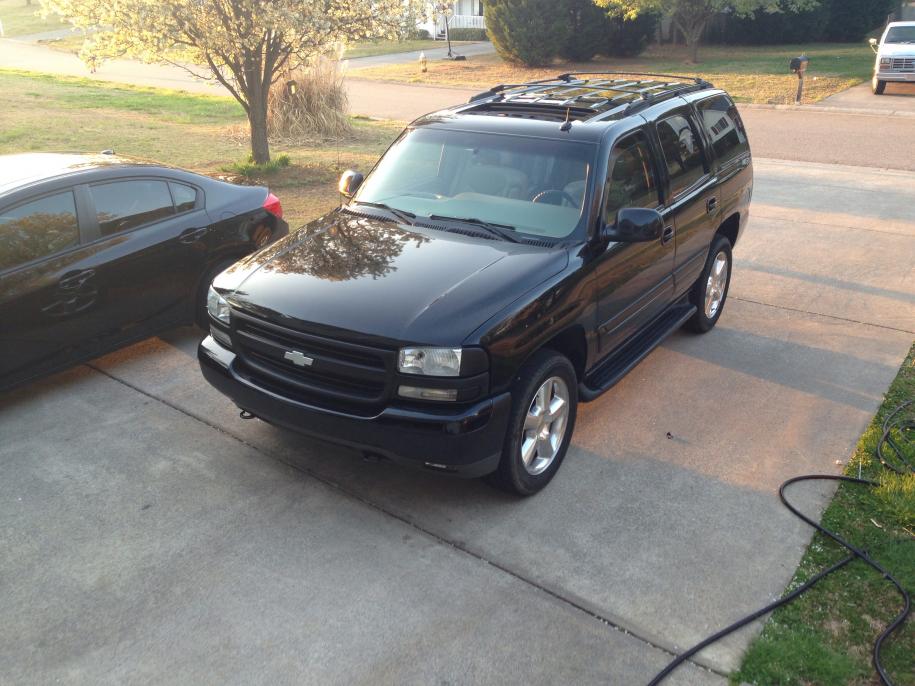

Went a little further with it today. Dipped the rest of the grill, side moldings and rear bumper .

Weather permitting I'm going to do my grill and bumpers this weekend. Hate all the chrome, all white to me looks cleaner. I like how your truck turned out. Last pic with the lights makes it look sorta like a trailblazer. Lol

Even messed around with the lights up front but didn't like it
Looks at least 10x better than the chrome! Seriously, the grille is much much nicer blacked out. As for the lights, I think they look good, but I woulda sprayed glossifier over them, or used Smoke dip instead of black, so the side-marker can still shine through.

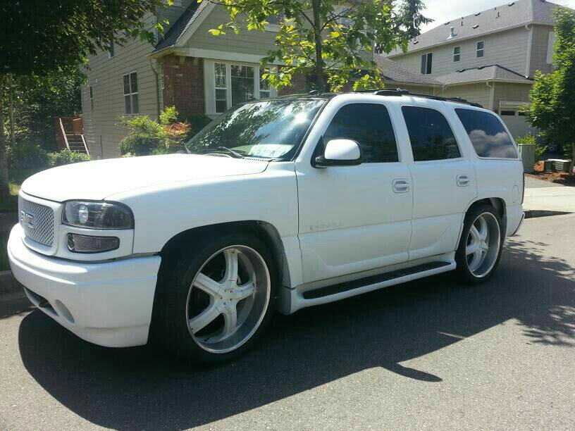

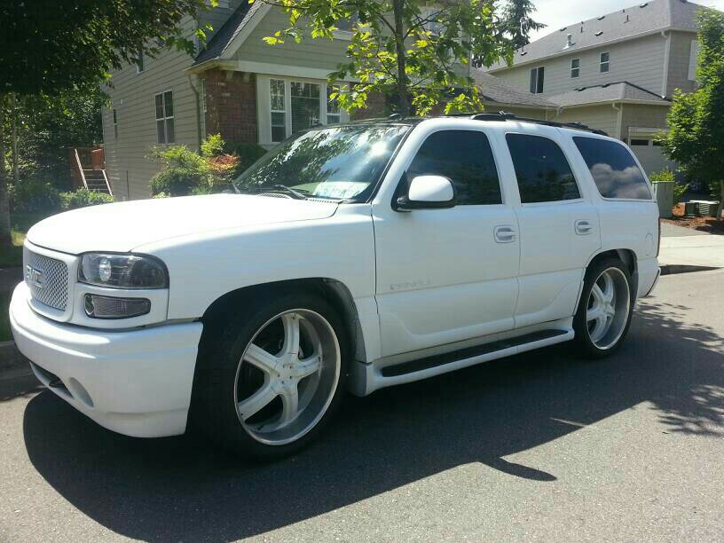

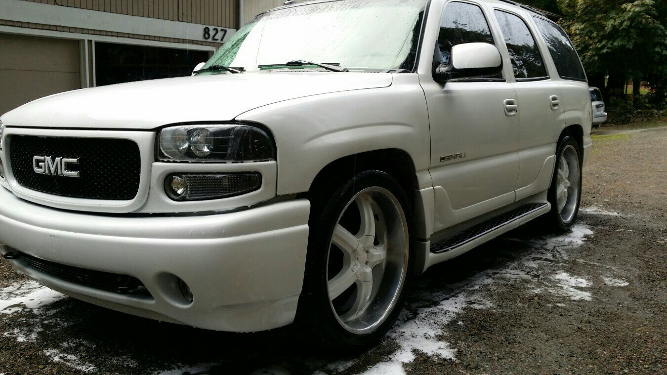

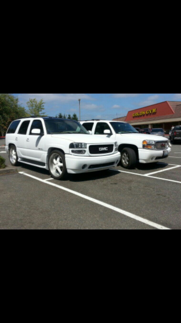

Make sure you buy enough dip. I used 6 gallons when I dipped my truck from black to white and I didn't do the roof. With that said, white doesn't cover as well as other colors, so it might be a little less depending on what color you're going with. I'll be dipping mine again in the next couple of months. Still can't decide on what color tho. Here's a pic if mine, it was dipped for about a year

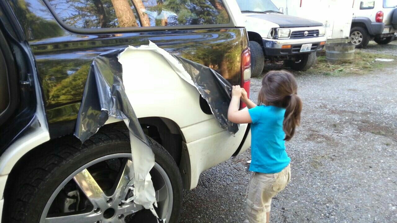

And one of my daughter peeling it

Yea I can see 5 gallons would work. You'll probably get full Coverage on the 3rd gallon if your doing matte black. 4th and 5th gal will just add thickness so it's easy to peel down the road. Like I said going from black to white suck lol! Make sure to tape your Window sills really good, that's the only problem area I had. I tried testing just peeling the seals but there's not enough separation from the body of the truck. So just tape them off the best you can, also tape off all lights and windows, that'll save quite a bit of product as well.
