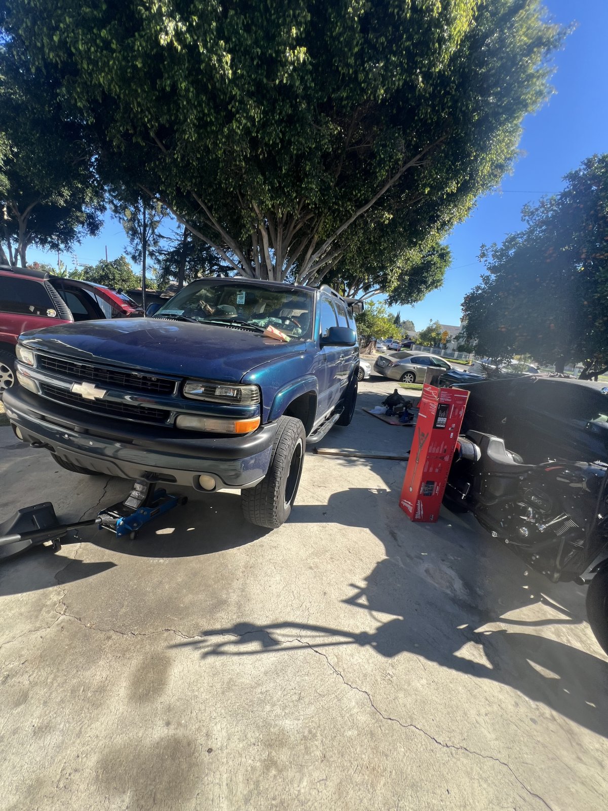

My 05 Tahoes engine just bit the dust due to me driving too fast into a flooded area. The engine has 185k but do to a possible odometer roll back from the previous owner; possibly 230k.
Im under the impression that a good amount of water was sucked in through the intake possibly cracking the heads in the process. The vehicle shut off immediately upon me submerging the truck in 2.5 feet of water that flooded the road.
Not knowing the damage or being able to access the situation properly I started the engine a few time in attempts to get out (it would barely start and stay on/ move after 4-5 attempts). Eventually i was able to limp the vehicle about 150 yards to my destination and upon arrival my check engine light came on. At the time it was a solid light and after putting my scanner on it it through p102 and p103 codes. Two hours later i started the vehicle again for to now have a flashing check engine light, the same codes as well as a p300. I also noticed thick white smoke coming from the exhaust.
I have not had it professionally diagnosed but suspect a blown head gasket due to coolant i observed on the oil dip stick, oil cap, water present in the airfilter and the white smoke i believe i coolant burning coming from the exhaust.

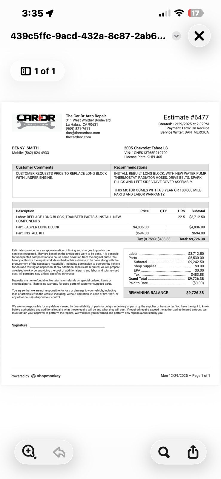

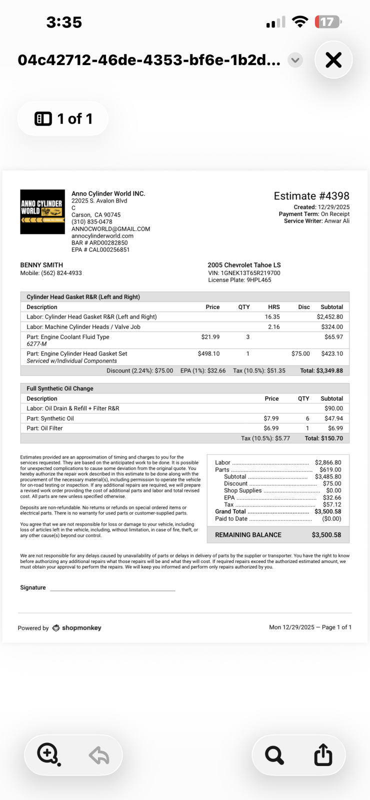

I have a few questions; would it be worth it to have the engines head gasket repair etc or go the remanufactured engine route?
Chevy dealers want upwards of $6700 for the a new engine no labor.
Ive gotten about 4 quotes and have 2 official ones that I've posted below.
The other 2 shops also quoted me on the cost of the remanufactured engine, one being north of 3500 and another around 6500 parts and labor.
Any answers will be useful in making a decision.

bent rods is what happens when you drive into water, when you try to re start it the cylinders with water in them, well wont compress and locks the piston from coming up, but that bends the rods. or kills the connecting rod bearings.
the smoke just might be all the water in the exhaust burning off. water to the cats can take a while to dry out.
only chance you had of saving your engine was to not have restarted it, got it towed, pulled out. pull the spark plugs then crank it to clear the cylinders, change the oil then try starting it.
best rt might just be finding a junk yard 6.0 cause why not right? clean that up, re gasket everything but the heads. a new water pump, tune for the 6.0. or go further cause its a engine out of the truck, cam it.

if you like the vehicle and the insurance covers a remanufactured engine that would be my route.
that quote is pretty high, if you shop around you could get out the door for much less
jasper is nice and all but consider local rebuilders at a lower price.
insurance is only going to cover about $3k tops for a engine (probably less), or they may provide one from there own supplier in which case you will only get a 12 month warranty.
which might be what you get a from a local builder also.

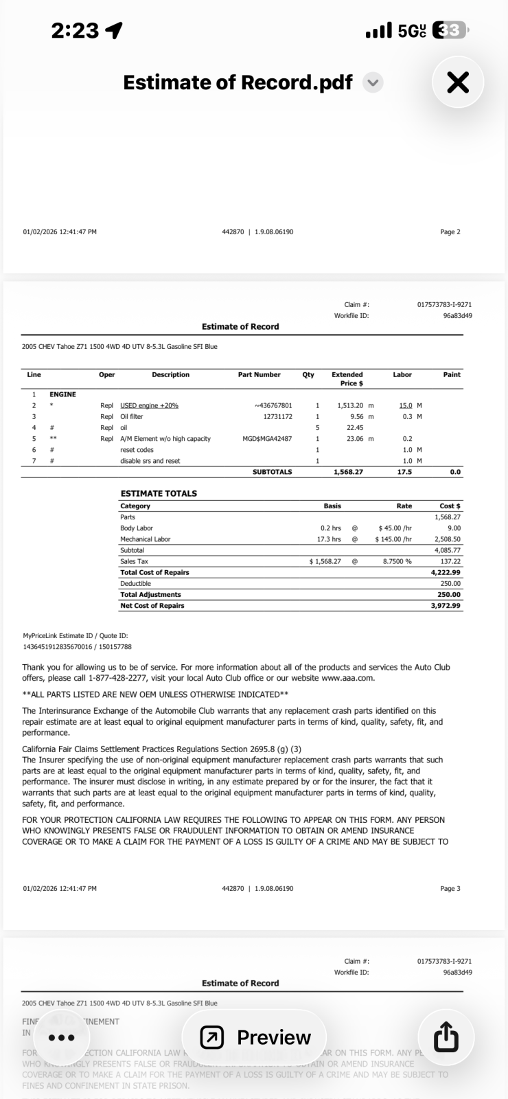

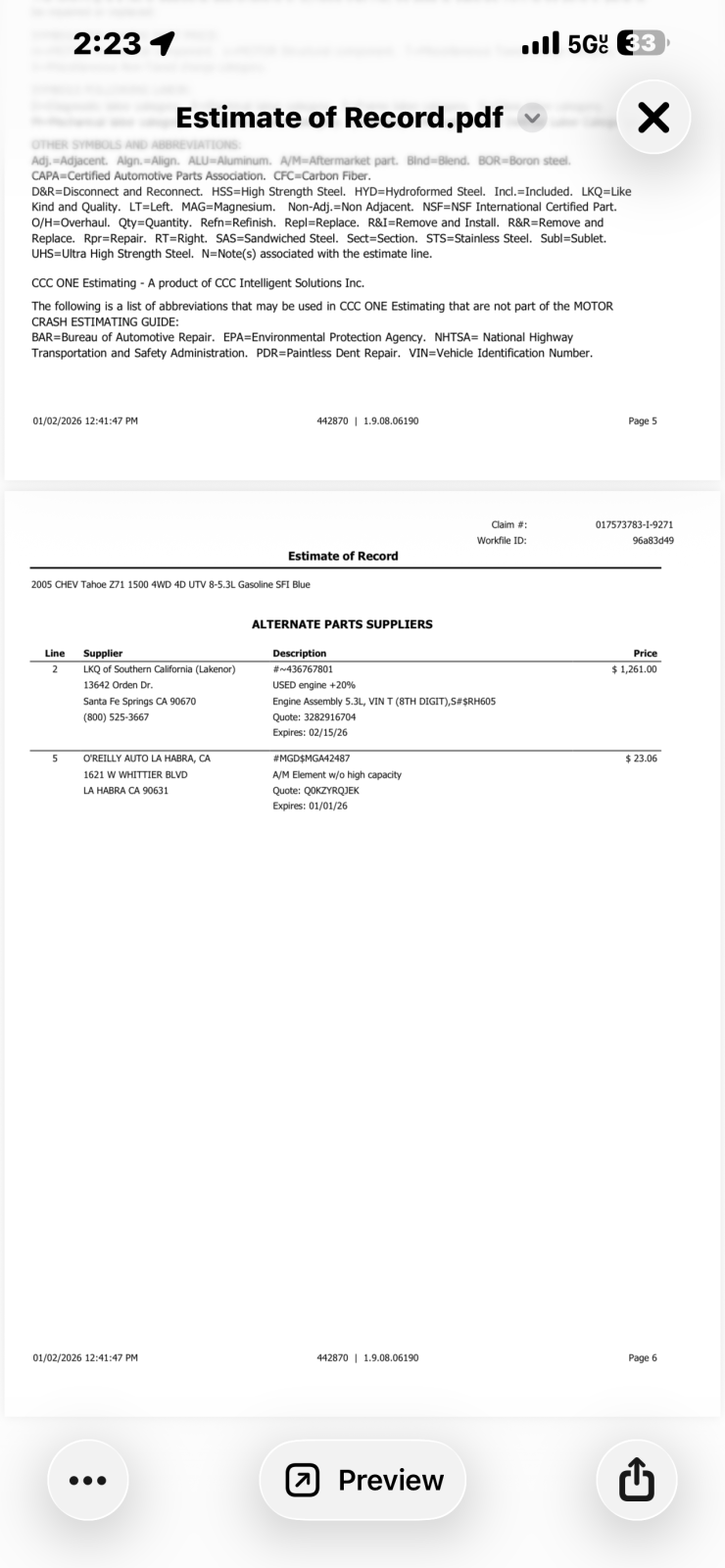

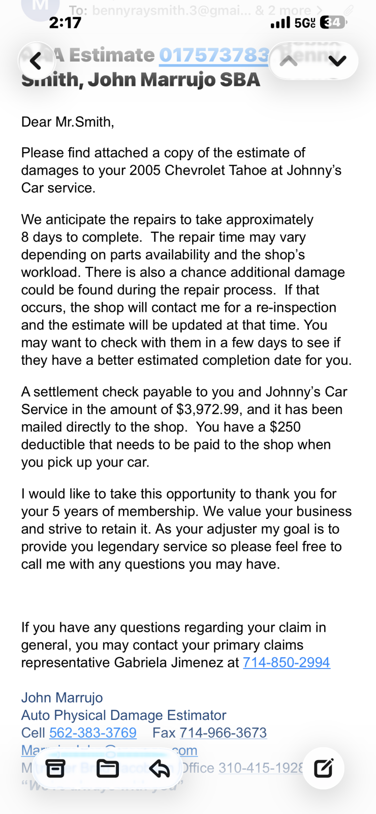

Insurance finally got back to me regarding what they will be willing to do with my Tahoe. They confirmed that will pay for a used engine replacement and labor totaling around $4100. They are offering a 1 year warranty on parts and labor on the used engine with 130k miles. Im considering the offer and waiting to see if the mechanic can source a lower mileage engine.

I paid 5k for the vehicle in January 2023 and it was stolen November of that same year. Insurance totaled it because it was deemed a biohazard due to a ton of m*th, pipes and paraphernalia. They gave me $9700 and i kept the vehicle with a salvage title. Since then I've fixed and well and added some tasteful mods to the truck for reliability and comfort. Fast forward to this past week and I admittedly made a poor choice by giving it the beans in 4wd into a deeply flooded part of the road on my way to work. Im under the impression that forward rotation of the front wheels kicked up a-lot of water into the fender going right into the airbox. The fact they my insurance is willing to shell out 4k towards the repair is highly convenient. I anticipated them reiterating that the vehicle is salvage and not offering very much for that reason alone. I had comprehensive coverage when it was stolen a few years ago and continue to have it up until this point.
