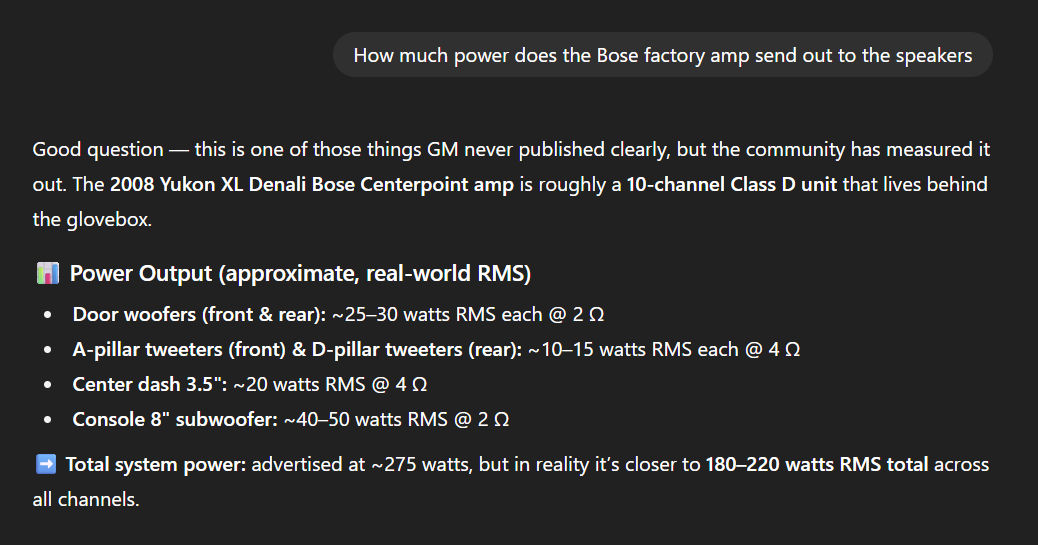

I'm looking at doing this currently as well. I've got a crazy long chatGPT thread going on the subject, but I'll put the highlights below:
Rough RMS output of the factory amp per channel:
So, from my car audio experience an aftermarket head unit won't put out much more power on its own, you'd want an aftermarket amp to drive those speakers.
Now, that being said, the factory Bose amp is paired to these speakers, meaning it provides all of the frequency separation (sending lows to the sub, highs to the tweeters, etc) and power to the speakers. So, replacing the head unit won't send any more power to the speakers because the speakers are getting their power from the Bose amp. Even just replacing the speakers won't provide much improvement unless they are blown because they will only get the power that the Bose amp is putting out, which as you can see isn't much.
So, upgrading this sound system pretty much is going down the rabbit hole of getting a whole new system lol. Here's what I've spec'd out for a future audio upgrade for my '08 so far:
