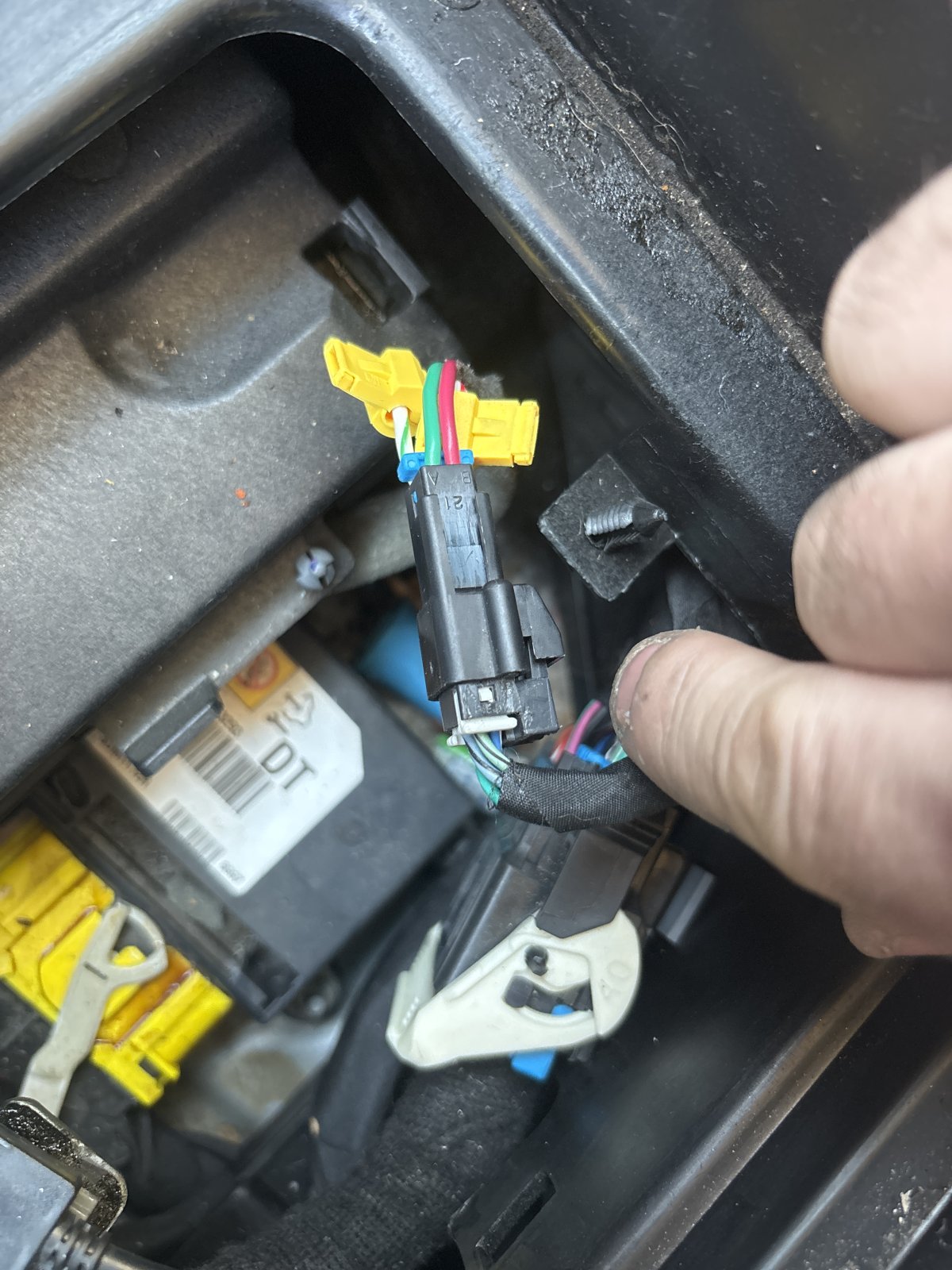

Already some taps in there the yellow things wat dat bout
From what I thought was the right wires last time. My LOC is only two channels so I only need a tap one set I believe. That how it was on the door anyway and it worked

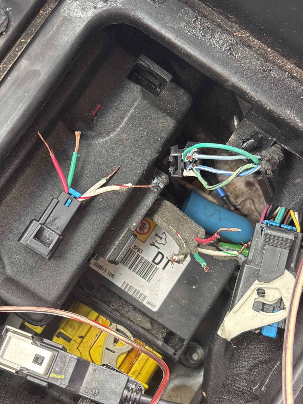

I moved the tap from the rear door speakers to the factory sub wires at the Bose amp (Dark Blue/White and Light Green/Black).
Power and ground at the amp test good (12.8V). If I jump 12V straight to the REM terminal the green light comes on no problem. But the fuse tap (and the LOC Blue remote wire) aren’t turning the amp on anymore. It was kinda working before I moved the tap, now it’s dead unless I jumper it.

Yaaa pretty sure I just destroyed this I tried tapping All these wires. I’m not getting any signal or sound fron my subwoofer. Power to the amp is good just not getting any sound no matter what I do with these ******* wires, but I’m starting to get really frustrated with this shit.

I know this power is this sub because I unplugged it and the stock sub stops playing, but when I tap it for signal with my LOC my ******* amp just doesn’t wanna pick it up for whatever reason.

Update: Got it working! Ended up using the high level inputs on the amp tapped directly into the Bose amp sub output wires under the center console. Dark blue/white stripe was the positive. Dual 12s are hitting now.
Need help dialing it in though. Bass EQ/boost is off, gain is set on the amp, then I use the remote bass knob to bring it up to where I want it. The deep low notes sound great but the higher bass frequencies sound distorted/farty. Low pass filter is turned down but still getting that sound on the higher bass notes.
Running 2014 Tahoe Bose through high level inputs — is the Bose signal just not clean enough or is there a tuning fix? Would a better LOC like the CT Sounds LC2 with BassLift actually fix this?
