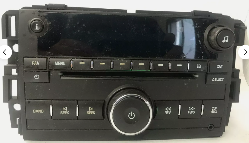

Sounds like GM equipped the truck as an L instead of an LT.
Does the radio have a sliding station tuning indicator and push button presets?
S
scomis
Dec 19, 2024
40
32
Looks like it is the US8 head unit (snapshot below) with UQ3 sound system (according to my codes sticker). From what I have read this morning, it looks like it is a 6? speaker system with no amp.
