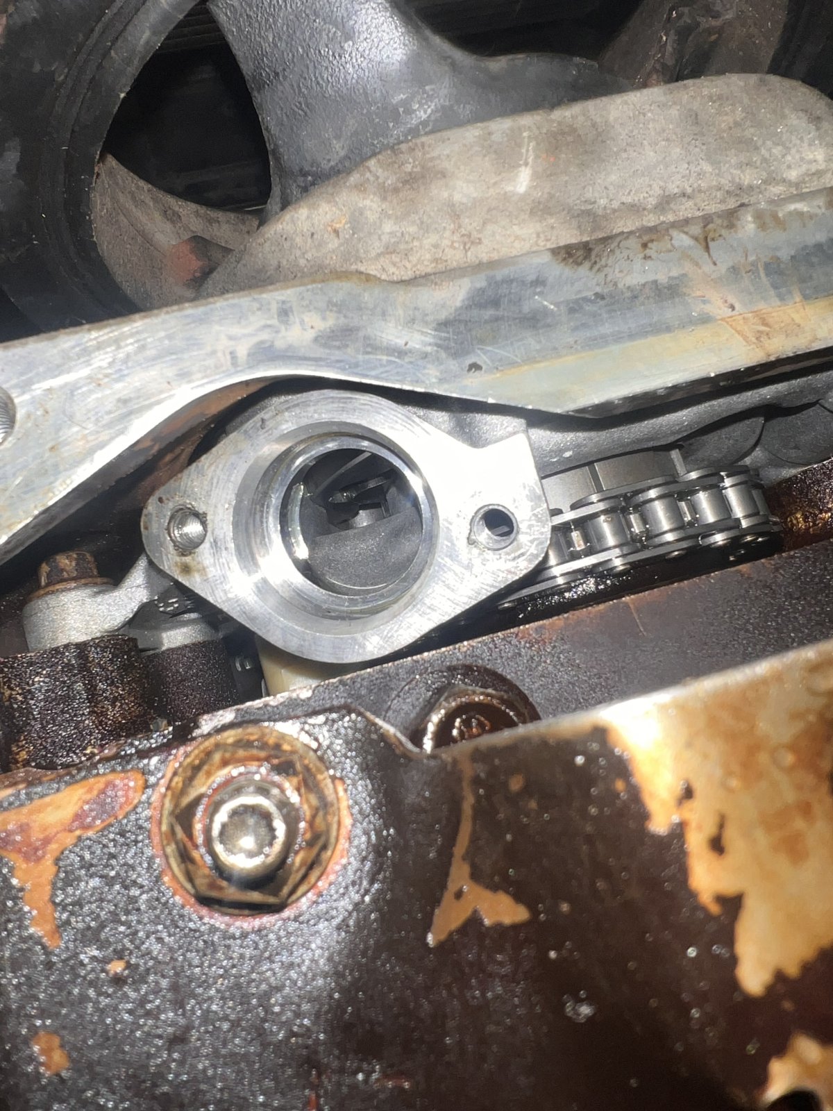

If it were mine i could not live with it being like that. That's a pretty important tube and seal to have an iffy connection.
If you take the tube and windage try off it would be pretty easy to get any shavings out.
Yup, this is my worry lol. I think that with the girdle it may be getting held up better than stock as is with the one bolt. I also have no idea if I tore up the threads on the oil pump. I think I am going to try to drill it out and see what happens

@thefrey My pickup tube is only using the 1 factory bolt to hold it in so it should be like yours. Drilling it out should be easy enough but in that position I would be worried about metal shaving contaminating the engine.

Decisions, decisions. I think I would feel better if it was the other bolt that broke since I guess that girdle could over time move.

I would remove the tube, center punch the broken bolt..... Pick up a left hand drill bit set...... Which not only will help it unscrew, but the heat will break loose any home from the loctite. Start small and work larger. Won't take long. Then clean thoroughly with compressed air, and wipe everything down with a lint-free cloth.
While you're at the hardware store, take the one good bolt you have with you.... And match it with two higher quality bolts.
I definitely wouldn't run it the way it is. It would always be in the back of my mind.....

Why can't any of you just tell me to just not worry about and that it'll be totally fine LOL...
Yeah, it'll always be in the back of my mind.... I should fix it while the pan is off.

Took about 10 minutes once you got the tube off? Priceless, when compared to 100,000 miles of mental torture....lol
Yep… exactly lol. Bought a kit from harbor freight that had extractors and left handed bits. Worth the $13. I didn’t even need an extractor either… left handed bit walked it out enough to finish it with pliers
Also bought new high grade bolts from the hardware store. Put them in and they actually got snug. Now I have 2 solid connections on the pickup tube and I’m a happy camper.
