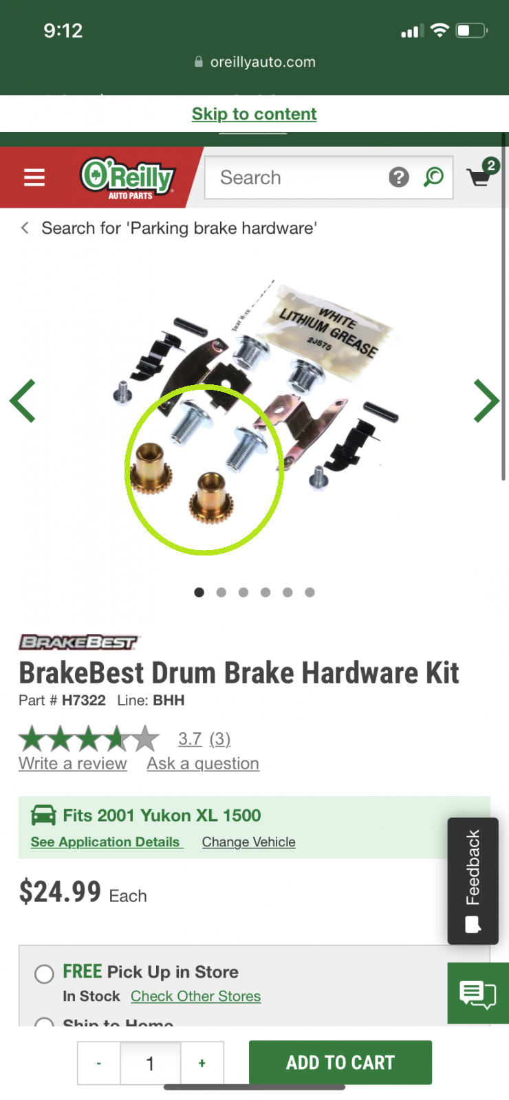

It does, these are the self adjusters in the green circle. I have also seen one of those brass colored gear thingys break into pieces and take out the parking brake lining.

You need to put the new adjusters in fully threaded in. Then adjust them out when you slide the rotor hat on to get a very, VERY slight drag seating the rotor. Loose enough to be able to remove it, but not loose enough to feel any kind of "gap" or "slop". You can turn the adjuster with a screwdriver tip just a little at a time until you find the sweet spot. Take notice which way they are to be installed as well. You can play with them in your hand before installing them to see which way they turn etc. Also recommend a light coat of syl glyde on those parts and threads as well. Very light, not enough to drip off into the brake liner/drum hat.
You're right that the circled item is an adjuster, but it is not a "self" adjuster.
Self adjusters need an actuator assembly that puts some pressure on the adjuster like in the diagram below:
There is no such actuator in our parking brake system. We simply have the star wheel (adjusting assembly).
Okay then! I could swear I heard them click to adjust when engaging the PB in reverse periodically. So that is strictly for manual adjustment then. This is good to know. Thank you for correcting me.
