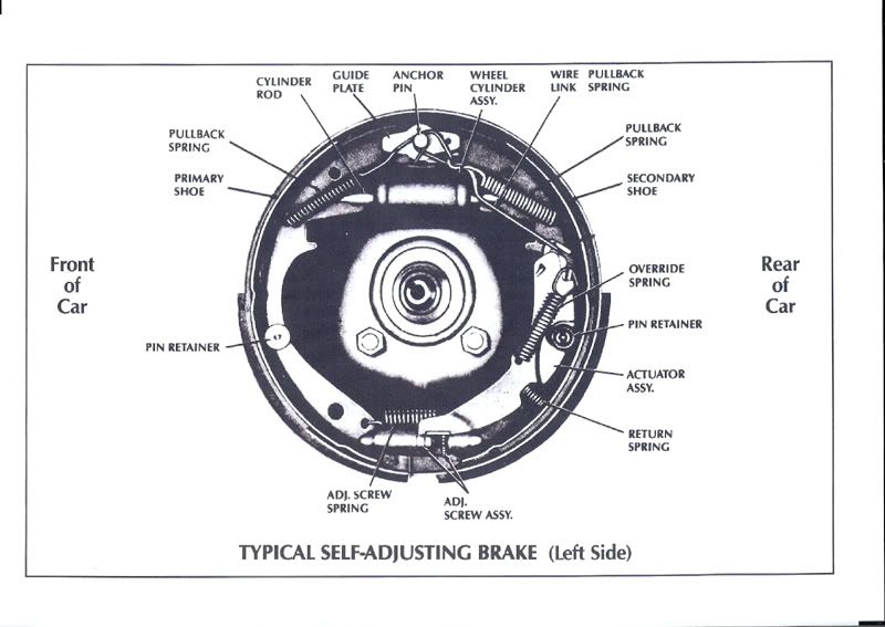

Unfortunately, this is not uncommon. Lots of cheapskates out there who don't mind the parking pawl keeping the truck from moving.
Get the part numbers of the stuff you need here:

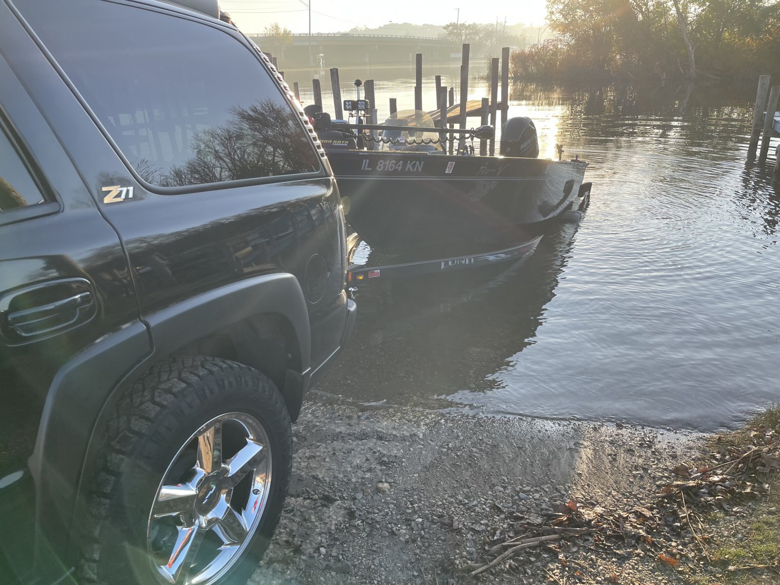

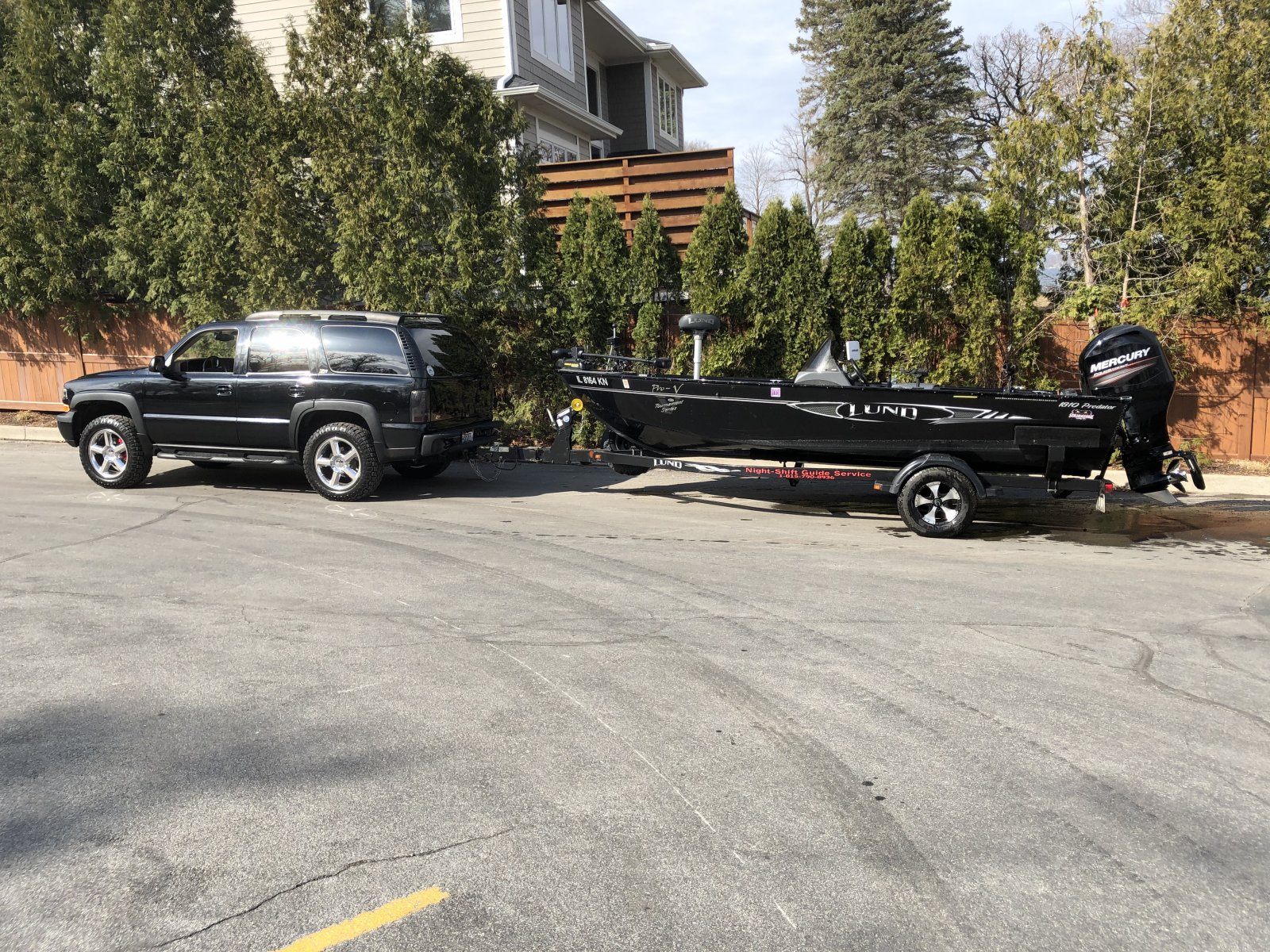

There are a few of of us that dont consider ourselves cheap skates by not having this done.Again mine came apart along way from home while towing my boat from a lake at 1 am.I drove 5 mph for 30 miles so needless to say i was pissed.I thought i broke an axle or rotor problem.Well the parking brake hardware just fell apart i guess tsb about it just junk now has an update on it.I refuse to put it back on this will never happen again to me.I will continue to use the parking pawl in the transmission like i have for 30 yrs and never had a problem.So how i see it when i back my boat down to the water it goes in untill the boat floats-so all the weight removed from Pawl.When i put boat back on same just reversed so just PAWL.To each his own on this i have not had a problem in 30 yrs of towing and backing down ramps to launch-in fact will launch 20 more times til ice up at the river in november.

Hey, your vehicle, your call. Your way of thinking indicates that whatever happens to give you concern on the road may or may not get fixed depending on if you can still drive the rig without it. You said when you back the boat in the water on the ramp, ALL the weight is removed from the pawl. There is still the entire vehicle weight on that pawl on an incline. Plus, if in fact you do lose the service brakes while driving, you have no parking/emergency brakes and you will slam in to park and I guarantee you that then that parking pawl will have a problem

Gotcha cool with me.I will take my chances.Maybe you guys use very steep inclines mine not so much.
