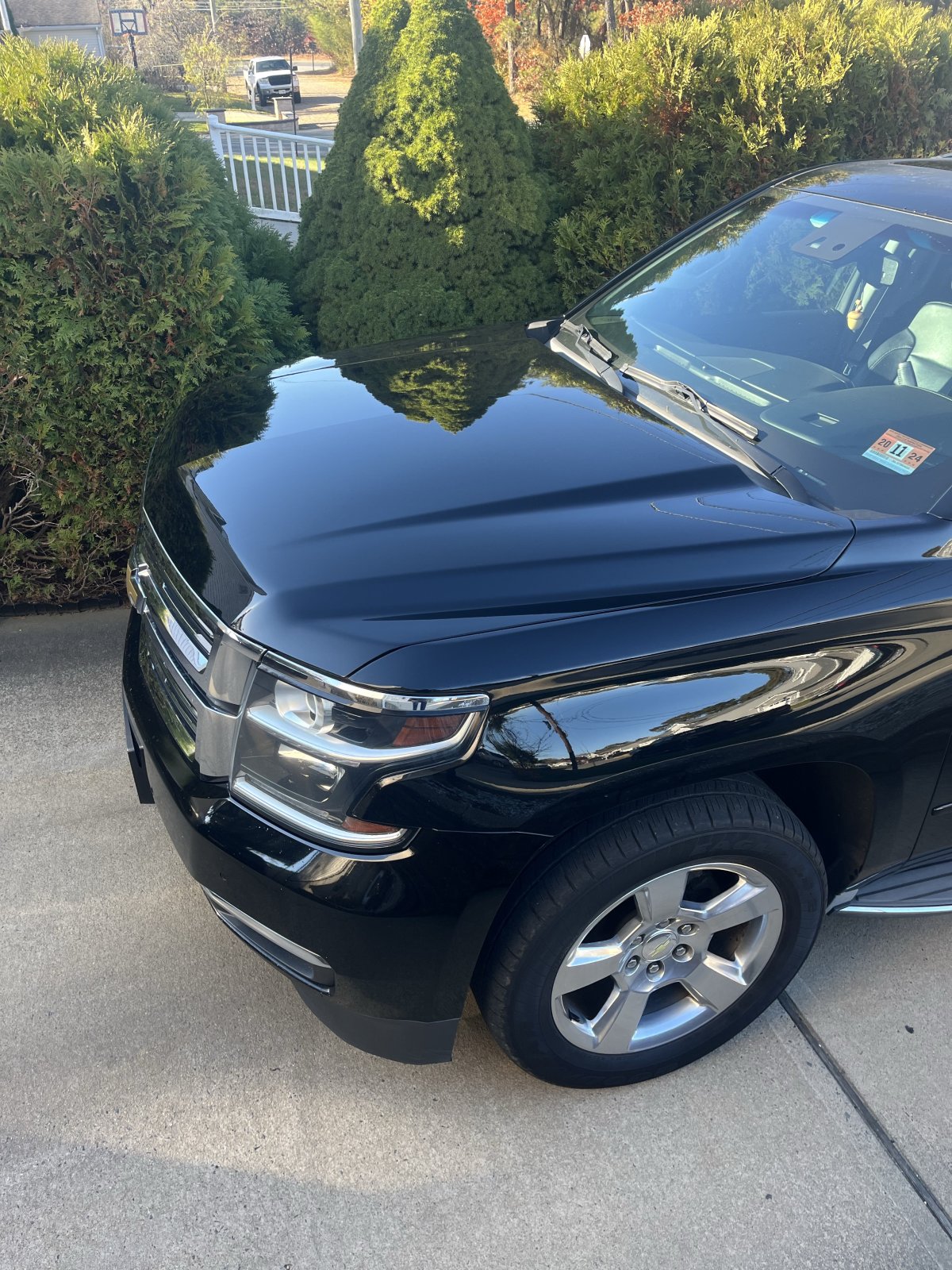

Just had my 2015 painted last summer. Definitely shop around, there are plenty of skilled body shops that will be below 6000
I had my hood and a rust spot elsewhere on the truck repaired/ painted for $2800
My roof is also failing but I chose not to do it, kind of wish I did now but meh.
