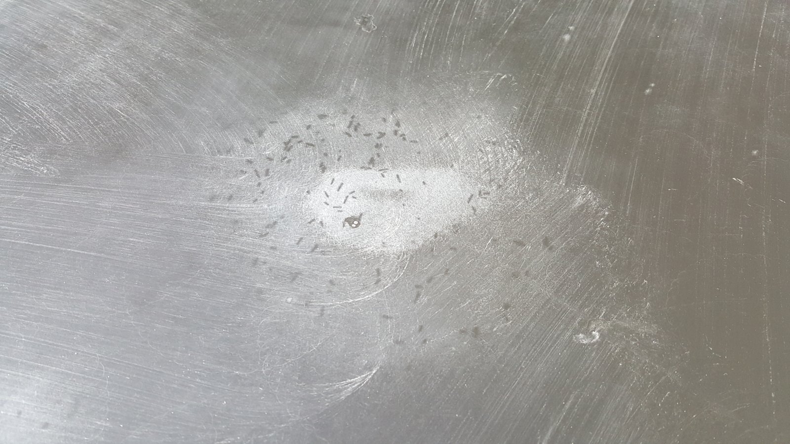

Question 1: I'm thinking in next couple weeks I'll be starting in on body work :) Ordering few misc items to keep project moving along. Assuming this is the type of tape to seal those body panel joints on rear quarter panel / roof. HERE
Question 2: My hood has these really fine cracks in the finish as I sand it down. About the length of a fingernail. Will these cracks seal in (stop streading) with a good 2k primer coat? Or does the hood need completely stripped and redone? Photo below.
