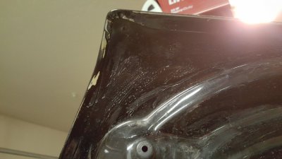

Curious, some of the edges refuse to feather out. I think the sanding powder is bilding up in them as i sand and keeping me from knocking down the edge. Any tips? Or is this just always solved with high build primer?
See picture below... I cannot get this edge any better. Oh and for fun the face in my door.

The primer will take care of it. I would cut out steps 2 and 3. No need to wet sand. Just sand the worse spots with your 220 , block panel with 320. Prime any area that needs it. Sand primer with 320 , spray paint.
