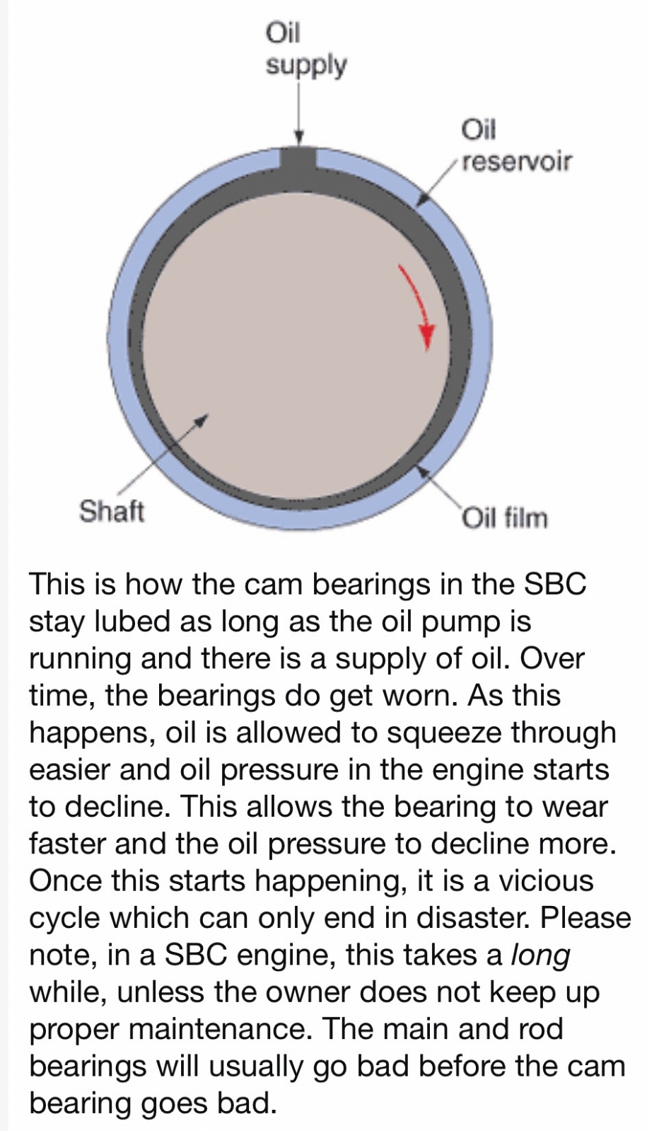

OK, I finally got my truck back... Total rebuild, .030 over, new everything. ALL that was wrong was a spun cam bearing, that's it... the lifer was ticking due to lack of oil but it was not hurt... Drove it home today, about 50 miles, running very well... oil pressure idles at ~45lbs, moving down the road at 2,000 rpm, ~55, accelerating hard up to 65.... the only thing I have noticed is a small fluctuation in oil pressure... sitting, rev it to 1500 rpm and hold it, and the oil pressure moves a little, just a few lbs, but it does....
Everything looks like he did a fine job, We shall see....

Damn fine bit of documentation. My neighbor and I bought our Denali used within a matter of months. He got an 06 orig owner XL w/ 140k for $9.6k, I got the 08 1 owner XL w/ 96k for $19.5k.
The (cam) bearing wear, lifter tick and oil pressure drop scenario is the equivalent of a motor is dead [emoji3544] warning light. It’ll get passed on to my neighbor and prolly allow him to keep his XL running for another 100k or sell it on and recoup his orig investment.
