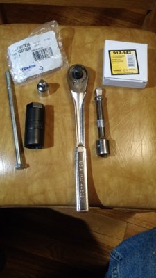

Same happened to me, it was the oil pressure sensor on the back of the block, PITA to get at, (don't know if anything is much different 07-15) There are a few oil pressure threads on going(one in the 07+ section too)
I bought a few months ago and switched to full synth, I'm guessing that the prior owner only ran conventional, and that I loosened up some sludge that blocked the filter.(see picture)
it happened again, and I ran an engine flush before the next two oil changes... hasn't happened since
Pics below, I hope they help.(lots of vids on youtube) see if you can find a picture of a removed engine, then you can see what you are looking for.
Parts and Tools Needed:(the long bolt is what you use to extract the filter)
Get the socket from Oriellys, the "OEM" brand one at Autozone is too tall.
The Extension is a wobble style, I tried using a u-joint style wobble, but it was too hard to control.
