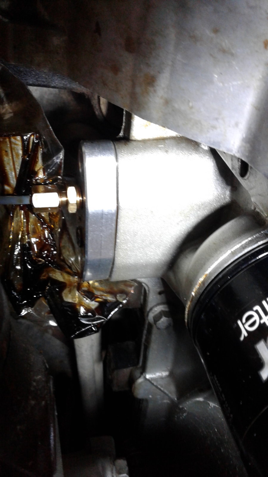

I installed a block off plate with a tapped hole so I could hook up a pressure gauge. The pressure was exactly the same at the port next to the filter as what shows on the dash gauge. It idles with 10 psi warm. Weird thing happened when I revved it up to 3,000 rpm. The pressure went to 40 psi but then I got a P0300 code. I cleared the code and it stayed gone.
At this point I can't think of anything else other than finding a replacement engine. The engine still runs great so I don't have to rush. I think I will keep this original engine and take it apart to see if I can find the problem. If I had the time and space I would probably take it out and fix it then reinstall. It stinks even more that this engine runs so well and does not have any of the noises I hear others have.
