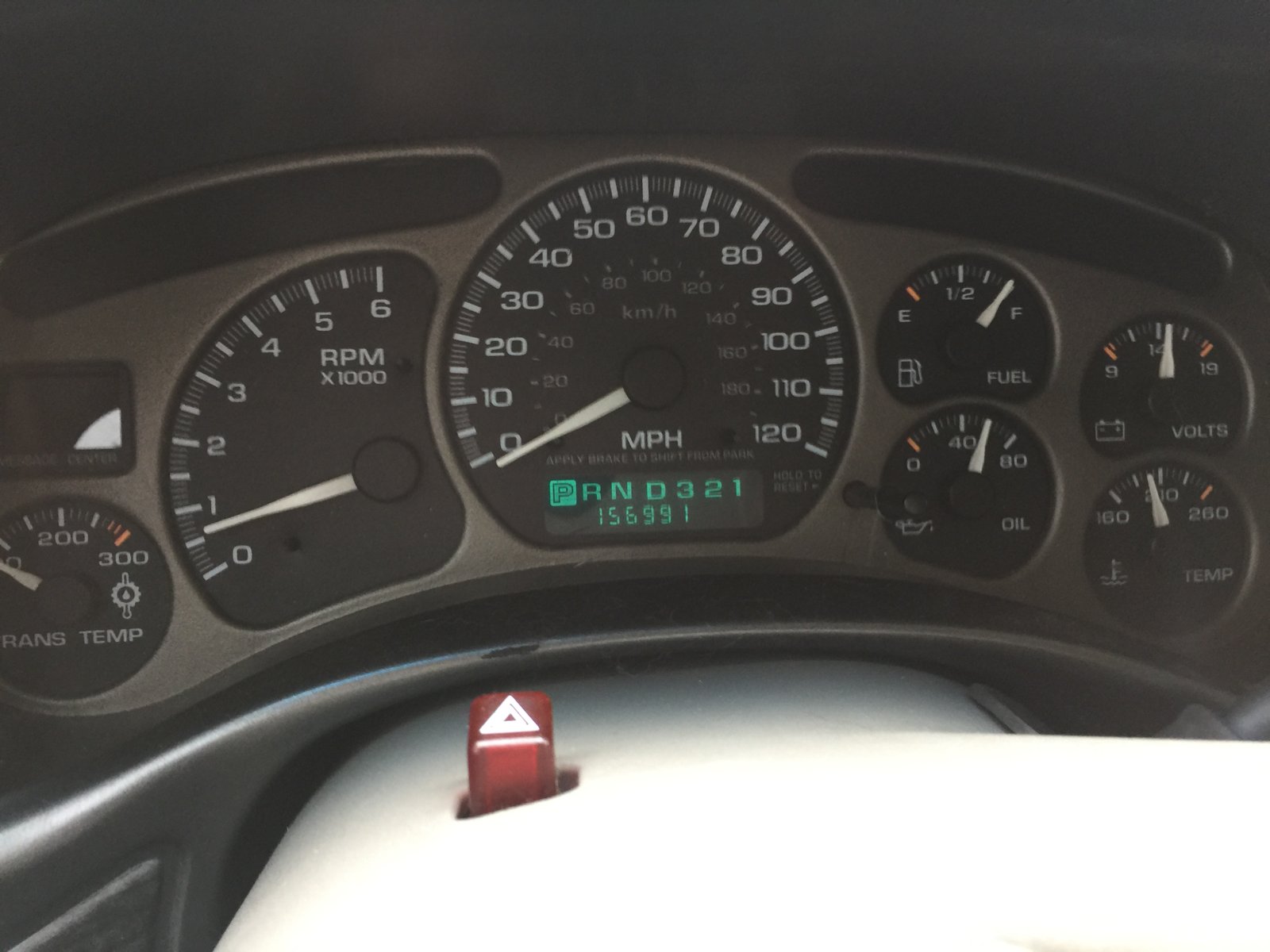

Mine has always read 40-45 at idle, 55-60 when driving. I've heard above 15-20 at idle is fine.

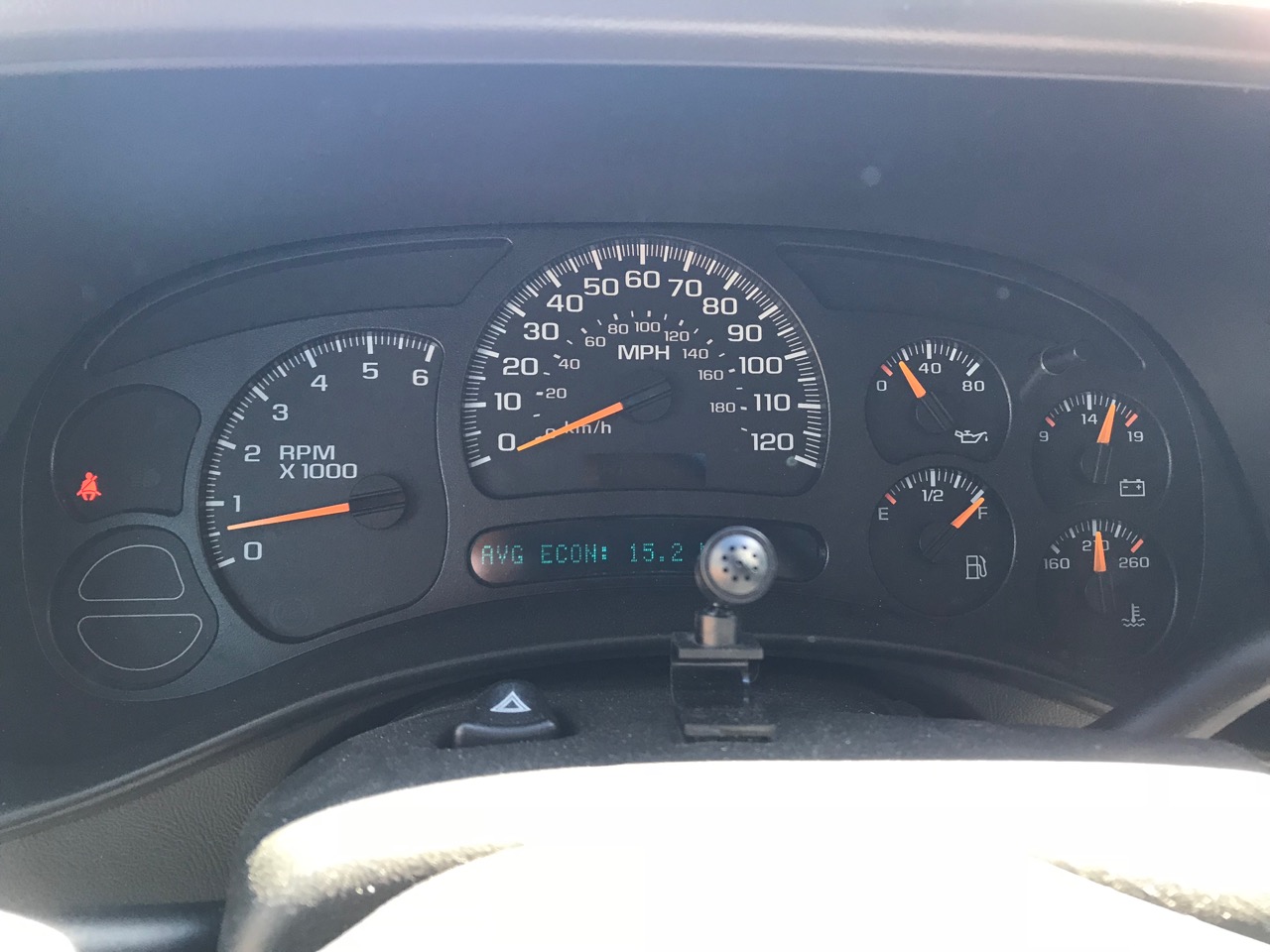

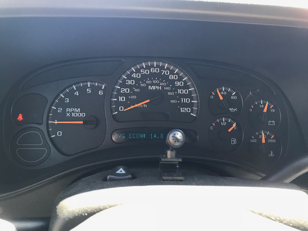

Here is my oil pressure AFTER repair at 1000 RPM and at idle...Shop says I should only check it at 1000 RPM because my idle is too low.

Idle looks close to normal- mines about 700 but yours looks to be 500 according to your tach? I forgot that after a new pump my pressure is about 60 at idle. Ask them if they checked pressure with a manual gauge so you can rule out a problem with your gauge. Is it possible that someone has replaced stepper motors or your gauge face and didn’t get the pointers back on right so your gauges are off? If you have access to a cluster from a 2000-2006 Tahiti/suburban/Tahoe it pickup you can swap them for a minute to compare the readings on the gauges. Otherwise if it’s not knocking and there’s no warnings you should be ok.
Edit: I just noticed your volt gauge appears to be off so my theory of someone messing with the pointers seems more and more possible.

Thank you. I was thinking about stepper motors. Would an extra/aftermarket oil pressure gauge make sense? Then I could monitor it. I will be going back to the shop for him to recheck it on his actual gauge.

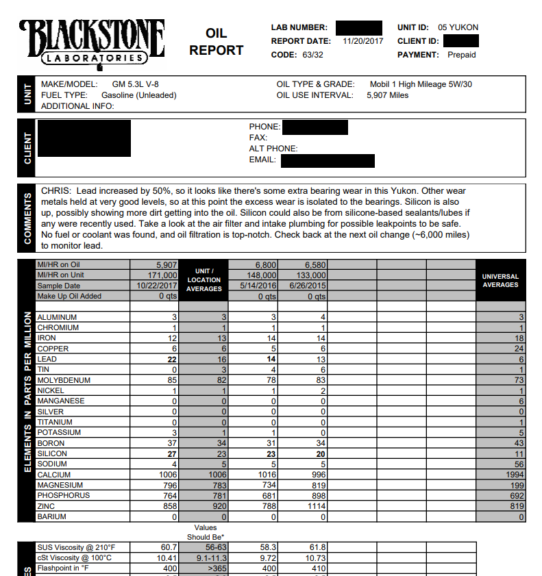

Tiny flakes is a sign that something is up and not right Joel. Have you sent the oil out to be analyzed? They may be able to decipher what kind of material is in the oil and whence it came from. Seems to me though, after all the work you've done, that it's time to put new bearings in it; time to freshen up the bottom end.
I figured that even though the particles are tiny that they should not be there. Since they don't appear to be magnetic I can only assume it is bearing material. I wish there was a way to find out which bearings. Probably crank bearings but I have heard of cam bearings going out too.
I have not sent the oil out. I'm not even sure who to send out to but will look into that. I kept what I could of the particles from when the I dropped the pan. I would probably have to use the current oil because I have been so busy I am not sure I didn't co-mingle the old oil from the truck with other oil. I have my truck, the wife's car, and my daughters car and have done a few oil changes lately. I suppose the current stuff is as good a test subject as any.
