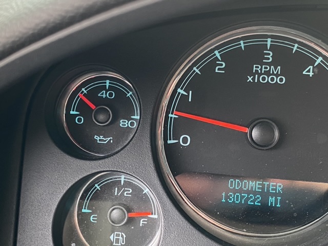

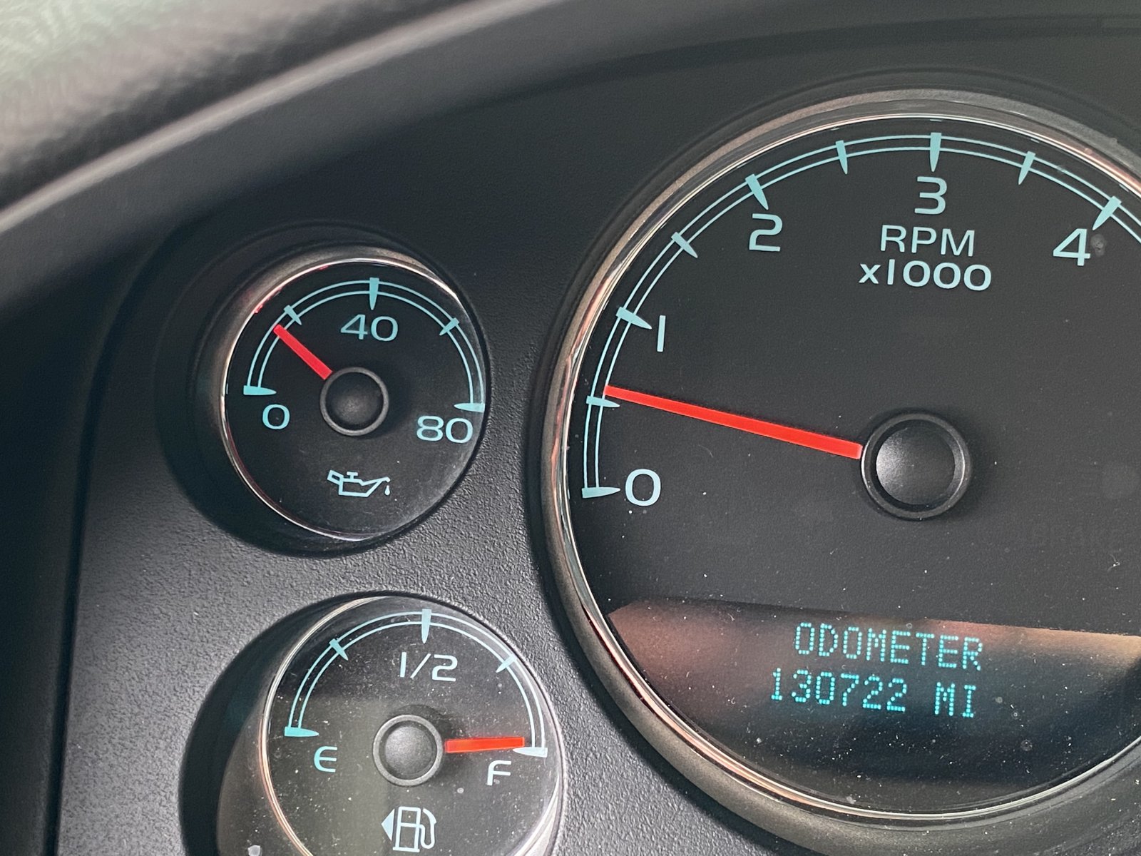

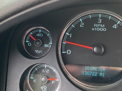

7D45CD4F-ACDE-4725-9B7D-46ECCE48D084.jpeg After about 1.5 hours on freeway. Came to stop in town and oil pressure dropped below 20. Is that normal ?

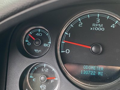

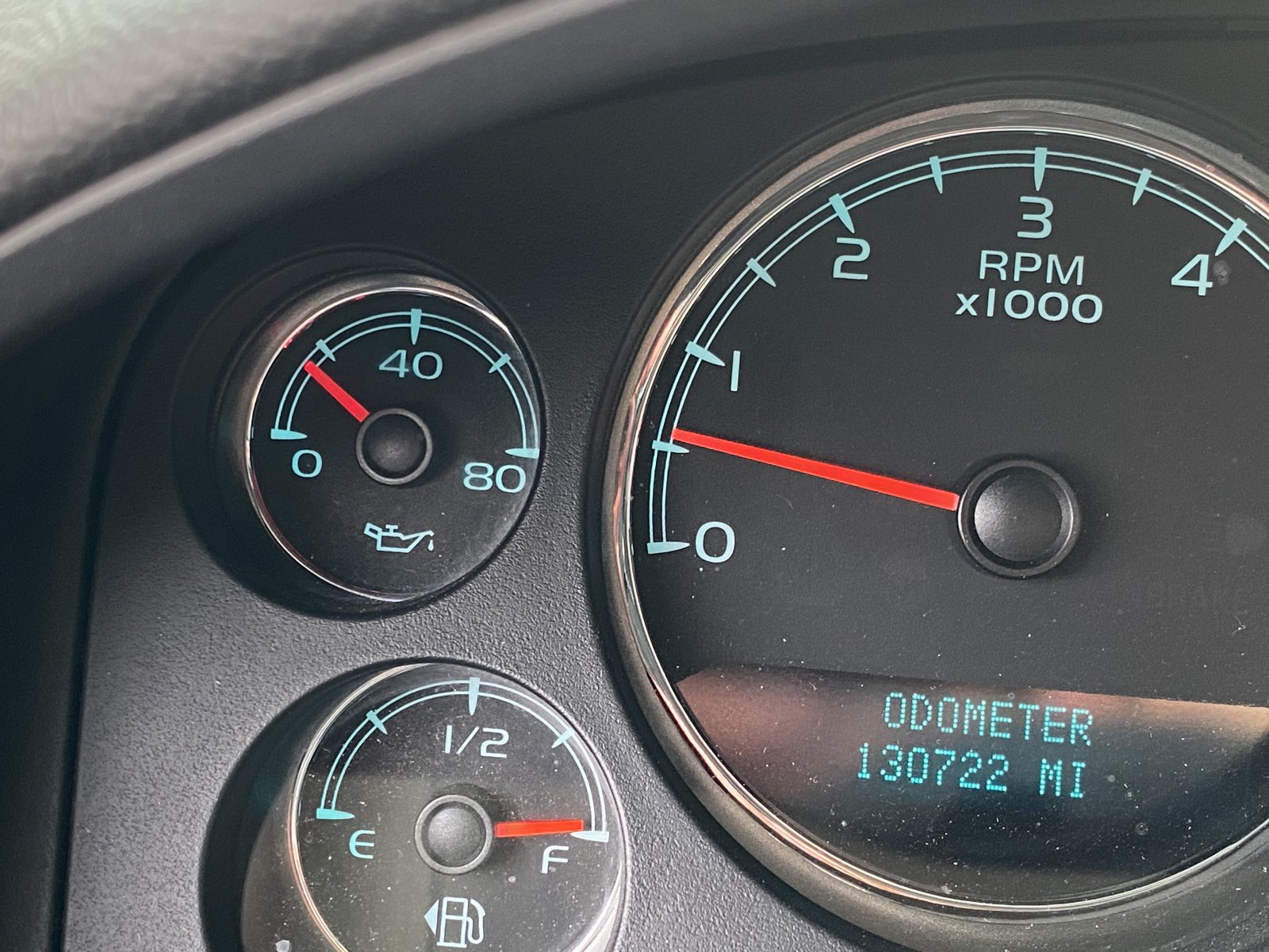

Just got a new sending unit and oil pump. 8602E7C1-C61F-4424-82FD-E9FED15B7944.jpeg EA7A332E-7ADB-497E-87A6-F2C22BD9B562.jpeg

Why did you get a new pump and sending unit? What pump did you go with? Does the pressure increase when you are up to speed?
Can’t say that it’s too alarming, yet, but would definitely pay close attention since you just had work done on the oil system.

+1. That's on the low end of normal for a stock oil pump after highway driving on a higher mileage engine. Not normal if there's a new oil pump and pick-up tube o-ring in there, assuming they replaced the oil sending unit screen when they replaced the sender. More details on the work if you have them, please. It would also help to know which make and model oil pump they put in.

Did you do the work yourself? Did you replace the sending unit screen? Did you replace the pickup tube o-ring? Why was the sending unit and pump replaced? Did a shop do the work? The invoice should have a detail of what was done and why and what parts were used.
At this point you should also attach a gauge and get a reading at cold start, warm up and after being driven on the highway.

It idle my 5.3 was about that. My 6.2 with all new stuff is also about that. If it kicks right up with rpms, I wouldn't worry too much. My 5.3 with a non vvt cam was higher than stock, so might just be the VVT lowering it a bit at idle.
If you hear audible engine noise and the oil psi doesnt come up with rpms then you have a problem.

My ‘07 5.3L, original engine, idles about 28-30 PSI after a long freeway run. 5W-30 synthetic. My oil pressures have always been strong (or my sender/gauge weak).
Having said that, if it had that reading after a couple hours at freeway speed, I wouldn’t be concerned.
What did it register before you got off the freeway?

Thanks for clarifying. There are 2 pieces that are still missing for me to offer clear guidance:
  1. Whether or not they replaced the filter screen that sits under the oil pressure sender. Lots of people make the mistake of replacing the sender not knowing there's a screen under it that's hard to get out and probably 90% of the time the cause of low oil pressure on these engines. My guess is that if the oil pressure didn't change significantly after the pump replacement, that the pump wasn't at fault.
  2. Whether or not they replaced or accidentally damaged the o-ring on the oil pump pick-up tube when they replaced the pump.
Those 2 items alone are responsible for maybe 98% of low oil pressure issues on these engines. After that it's a mixture of leaking VLOM seals, worn cam bearings, a bad oil pressure relief valve at the rear of the oil pan, or a leaking dog bone in the rear of the block.

I hate to say it, but I would not be surprised if the true cause of your oil pressure issues was a cracked/failed o-ring that happened to be replaced when they swapped the pump, but if it was scarred, I could be wet in the head on this as well.
As @PNW VietVet mentioned, along with the o-ring, the screen is a very common source of oil pressure issues and if the shop didn't mention it, I would definitely look into getting a new screen or, at a minimum, cleaning the one you have.
